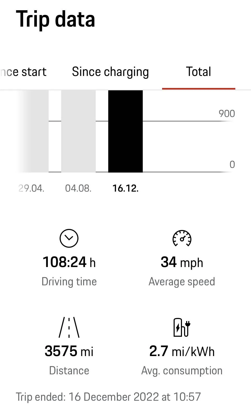

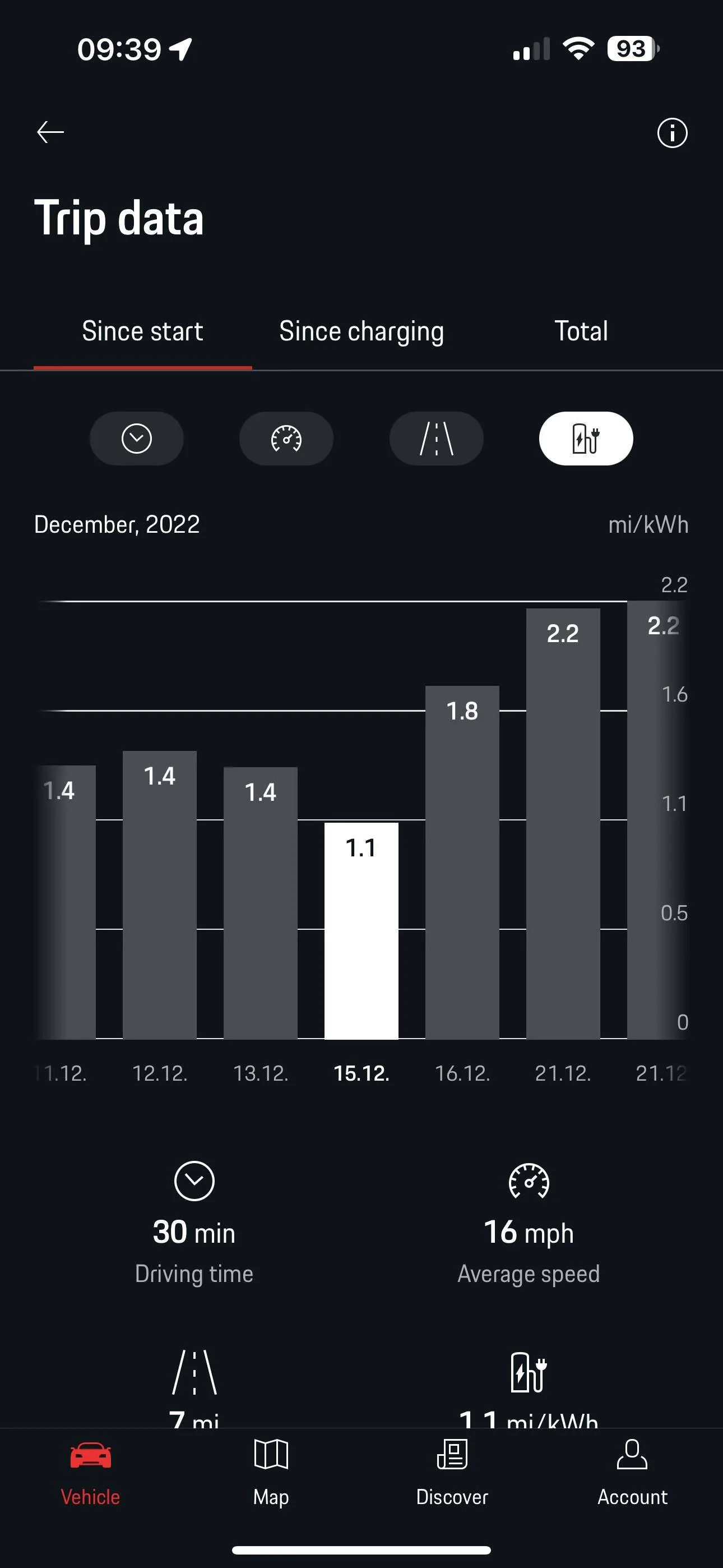

I’ve had my TTS almost a month now. Most trips have been relatively short so wasn’t expecting much from range but I have had one trip from West Yorkshire to London and back and a trip to Leeds and back which should have given a good estimation of consumption and I’m staggered how much under the quoted range I’m getting.
London trip on 7th Dec was 2.0 mi/kWh out, 2.1 mi/kWh back. Trip to Leeds on weds this week was 2.2 mi/kWh in both directions. Car was preconditioned on outbound trip to save battery on both occasions.
Car currently sitting with 73% SoC and estimating 139mi remaining which would be 190mi @ 100% and experience so far suggests that’s accurate.
what am I missing? Should I really expect 70% of the quoted range?
