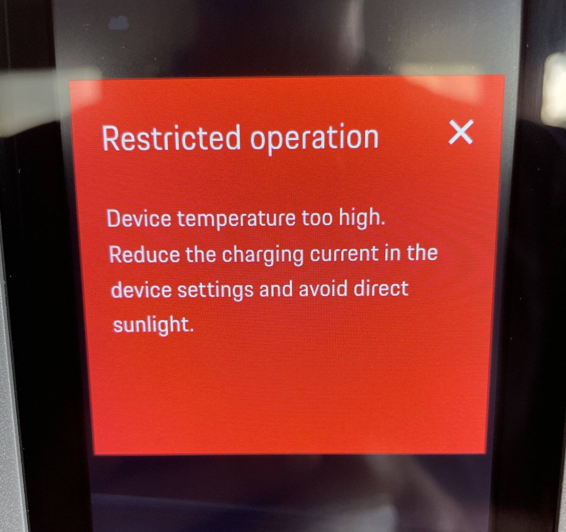

Has anyone noticed this message on the charger while charging the vehicle?
I live in Dubai and the climate right now is 40 degrees Celsius and higher however my car and charger are in a covered garage.
would anyone know how to reduce the charging current in the device setting and how would this impact my charge time?
Porsche Taycan When is the right time to charge? 53D93279-4EEF-44F7-BB65-6F52631F127E
8,797
5,269
GTS ST, Macan T
What charger do you have?
If PMCC then log on to the device and reduce the amps - there's a slider in charging settings - 32A to 16A will half the current flow and will double the time to charge.
You may be able to alter the setting on the touch panel but if not the PMCC has its own web server (and hotspot) which enables access to configure. You'll need the white envelope you got with the device as this has your passwords.
