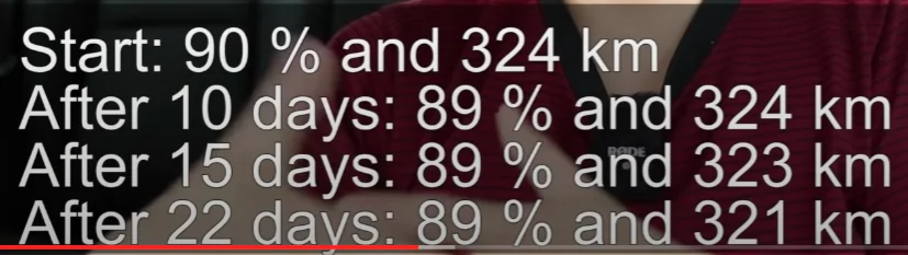

Pretty sure the Taycan only has a complete off state, and only supplies 12v access to the app/websites API needs (which would further explain the slow connection times). Tesla should also have a deep sleep mode in addition to standby. Probably why the Taycan barely loses power over night. See:
Or just for the result:
Porsche Taycan When you exit the car, do you "turn it off" or not? (POLL) 1611873642304
Don't take my words as gospel, however. It just seems logical with both the boot times and the app having to re-establish connection every time you open and close it.
Btw @PerPower
Haha.. sorry guys. Old habit from owning several Tesla’s :) With comfort access - just walk to the car to open/start and away to lock/shut down. Only that you’ll need to touch the door handles to lock, which I don’t get why can’t be done automatically like open...
