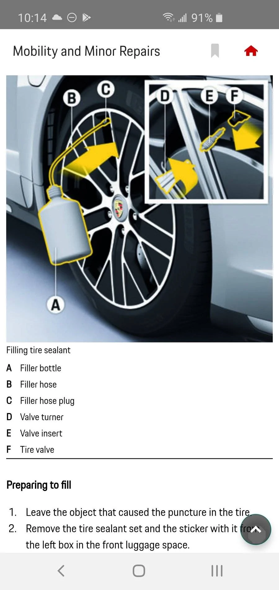

There's a tire sealant repair kit in the front trunk. From the Good to Know app.
