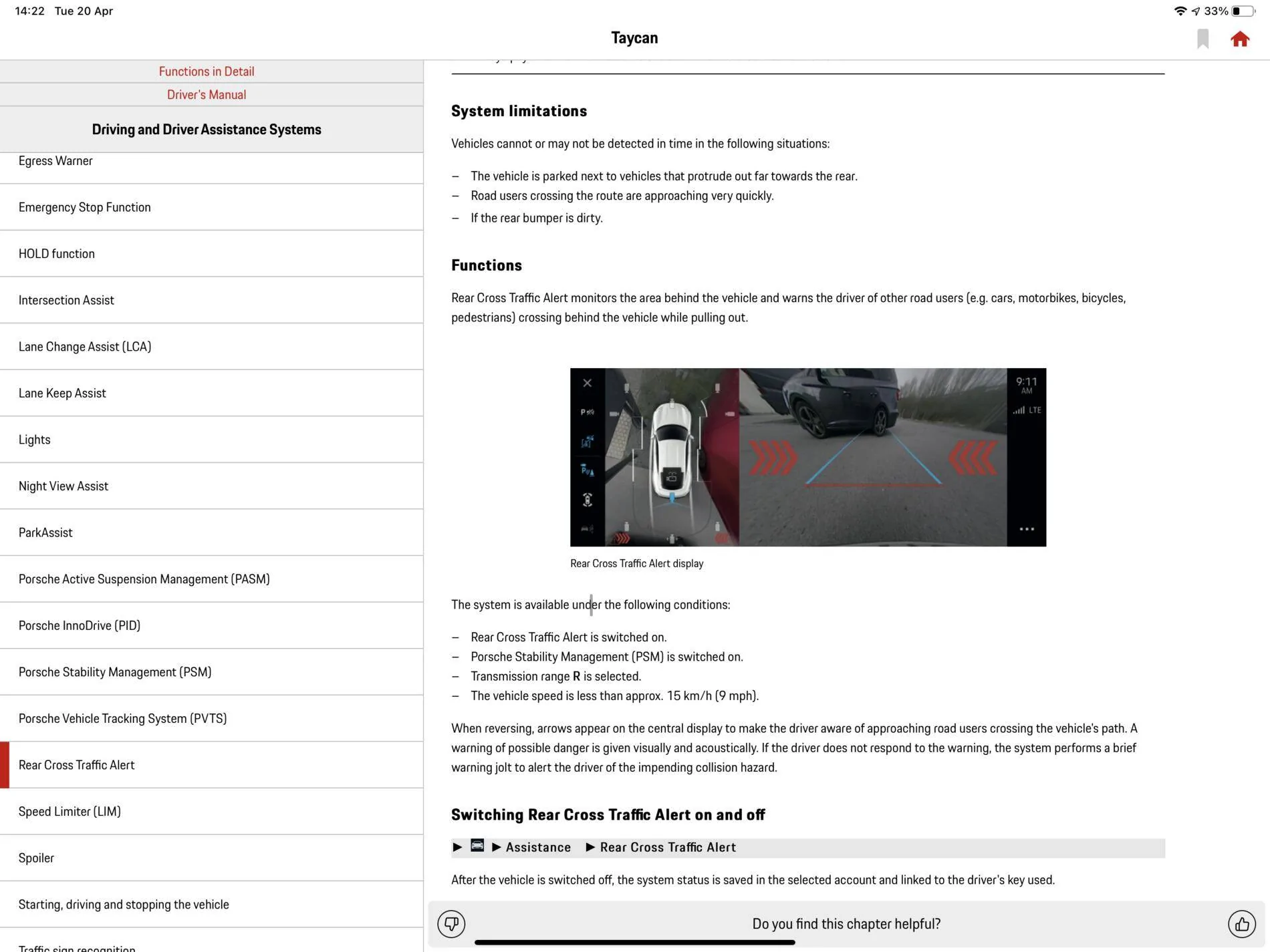

It does exist not clear if part of ACC, ACC + Innodrive, 3D Parking Assistant or all....
Porsche Taycan Which option do you need to be able to get Rear cross-traffic alert? DA9CFD47-E94E-4B6F-A368-7F792C65FE32

The Rear Cross Alert picture I posted is from the Owners / User Manual / Porsche Good to Know App. So it does exist but the mystery to solve now is with what options such as the ones I mentioned above.
RCA definitely exists, but it sounds like the RCA will only detect objects that are behind you, not 'crossing', so the name is a bit misleading.

Should be part of the Active Parking feature. That’s at least the case here in Denmark.
Yes, the info for "Park Assist inkl. Surround View" says:
- Exit Manoeuvre Warning
The Exit Manoeuvre Warning uses the rear radar and, where system limitations allow, warns the driver when reversing slowly when the parking aid is activated. The system warns, for example, of critically approaching vehicles when leaving a perpendicular parking space. The information is provided in stages – visually on the PCM touchscreen display, audibly and, if necessary, with a jolt of the brakes.
- Manoeuvring Assist
The Manoeuvring Assist can, where system limitations allow, prevent collisions through braking in tight and complex manoeuvring situations when reversing.
3D Surround View with Active Parking Support and not the 360 Surround View.
