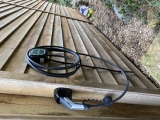

I’ve just had a Wallbox pulsar plus installed. I’ve got the 3 phase box but just connected a single phase to start - future proofing as we might get 3 phase power to the house in the coming months.
it’s really neat and has a separate holster for the tethered power plug which suits our installation as it’s a bit hard to get easily to the box itself.
the app is really easy to use and it all worked first time. Worth a look.
will post some photos tomorrow ....

Here’s the Wallbox pulsar plus in situ.
Porsche Taycan Which UK Home Charger 1FD44AF3-4DC0-4DA1-91A2-7C6949FAB9DE
now all I need is a car to charge with it....

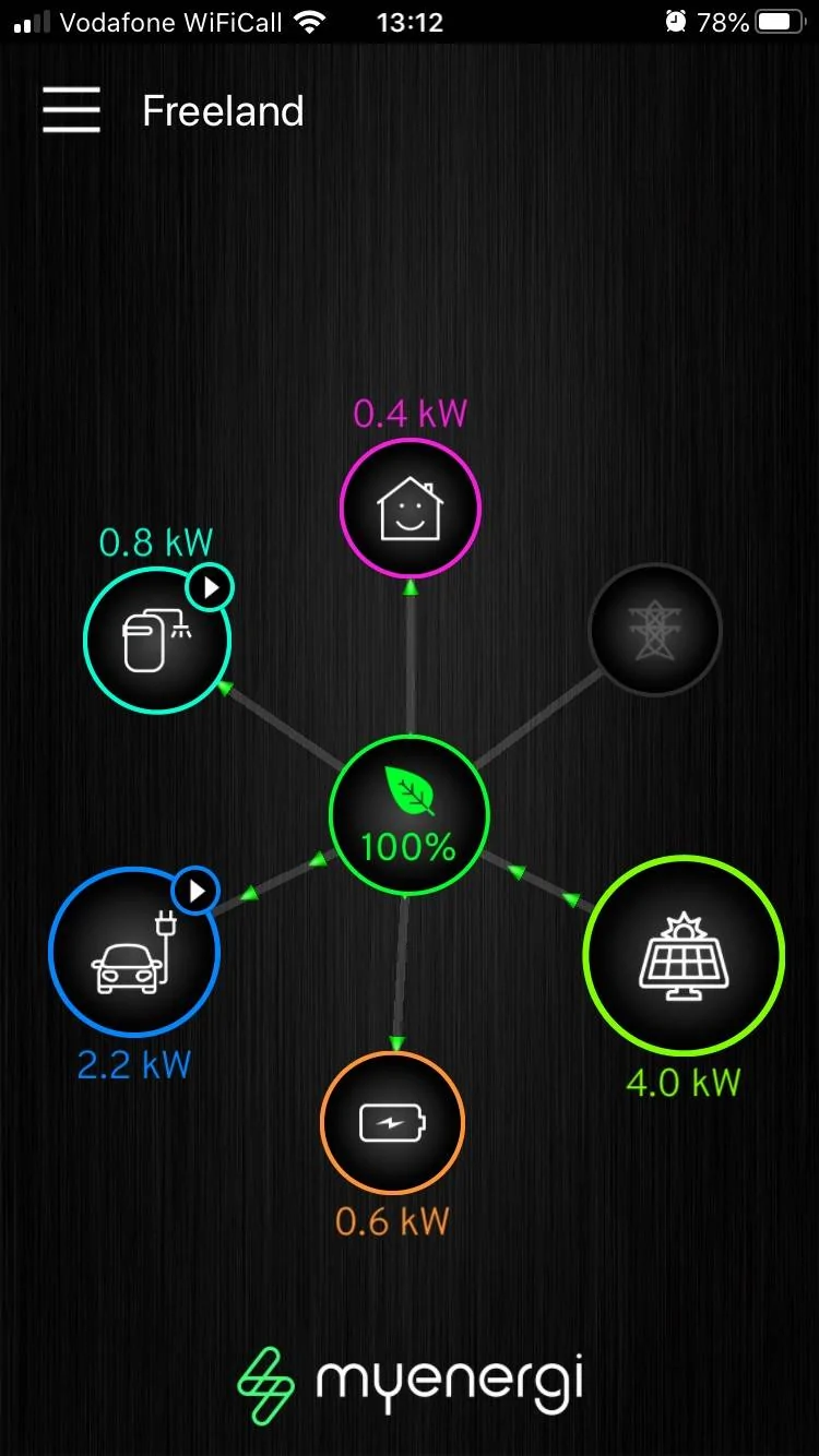

My problem with the Anderson is quite expensive and really doesn't have many features, apart from looking quite smart. I installed the MyEnergi Zappi 2 during the summer and it is probably the most sophisticated charge point you can buy. Basically, it has the ability to work with home battery storage and solar panels to charge a car during the day from 100% solar alone.
I have attached a picture from the MyEnergi app which shows it working charging my Tesla from solar/battery without drawing from the grid at all! You can also see it sharing some of the power heating the hot water.
You may well find that owning an EV suddenly turns you on to all this stuff!
