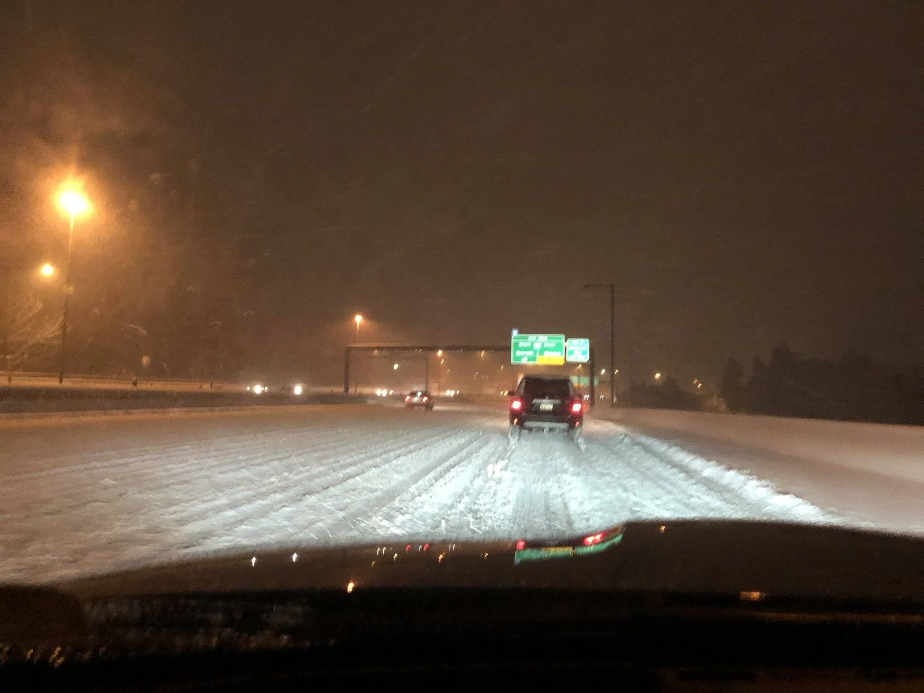

Serious question (yes I did a search), but wondering for those who live in snowy/icy places, have you / do you plan to drive your Taycan frequently through the winter? If so:
- Are you using the stock setup with all-season tires? If so, how are they on packed snow / ice with careful slow driving? (no judgement if you're using stock summer tires)
- Are you switching to a dedicated winter tire set? I've priced out a winter Vossen 20" set w/ Pirelli P Zero Winters for about $5.5k.
- Does the car clear heavy snow piled up on the ground on unplowed smaller streets? I'm less inclined to use the Taycan as a snowplow than my M3.
- Are you just going to switch to a different car? For example, we have a Volvo SUV but that has also been slippery in prior years.
I know these are subjective questions, but historically I've switched out for winter sets on prior cars, but if the snow is super thick then I'd take the SUV instead. However, this might mean putting winter wheels on both the Taycan and my SUV, and that's quite a pricey solution.
Picture below of a prior winter.
Thanks for your experience and thoughts.
