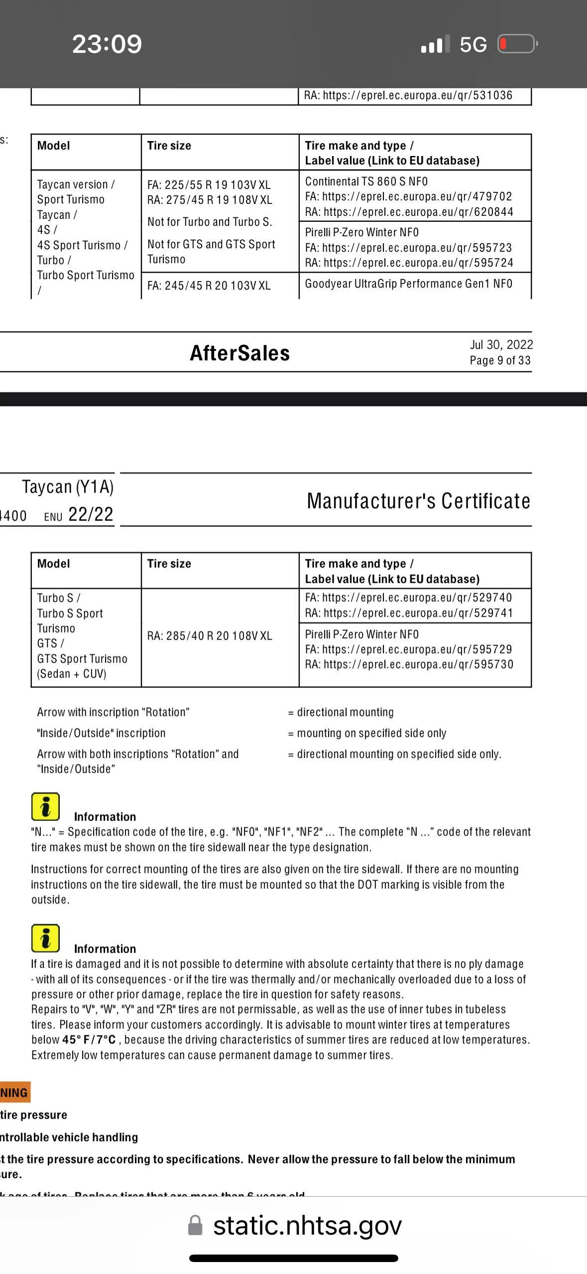

Only two certified nf0 20 inch winter tires. Don’t know if it is important. Better takes something that can manage the heavy weight if the Taycan.
I have the Pirellis. No problems driving on snow in the alps last winter. Low speed. Performed well on the autobahn going there.
https://www.taycanforum.com/forum/t...v-approved-or-suitable-tyres.7362/post-275104
Ps the Pirelli P zero winter is NF0 don’t know is the scorpion is too

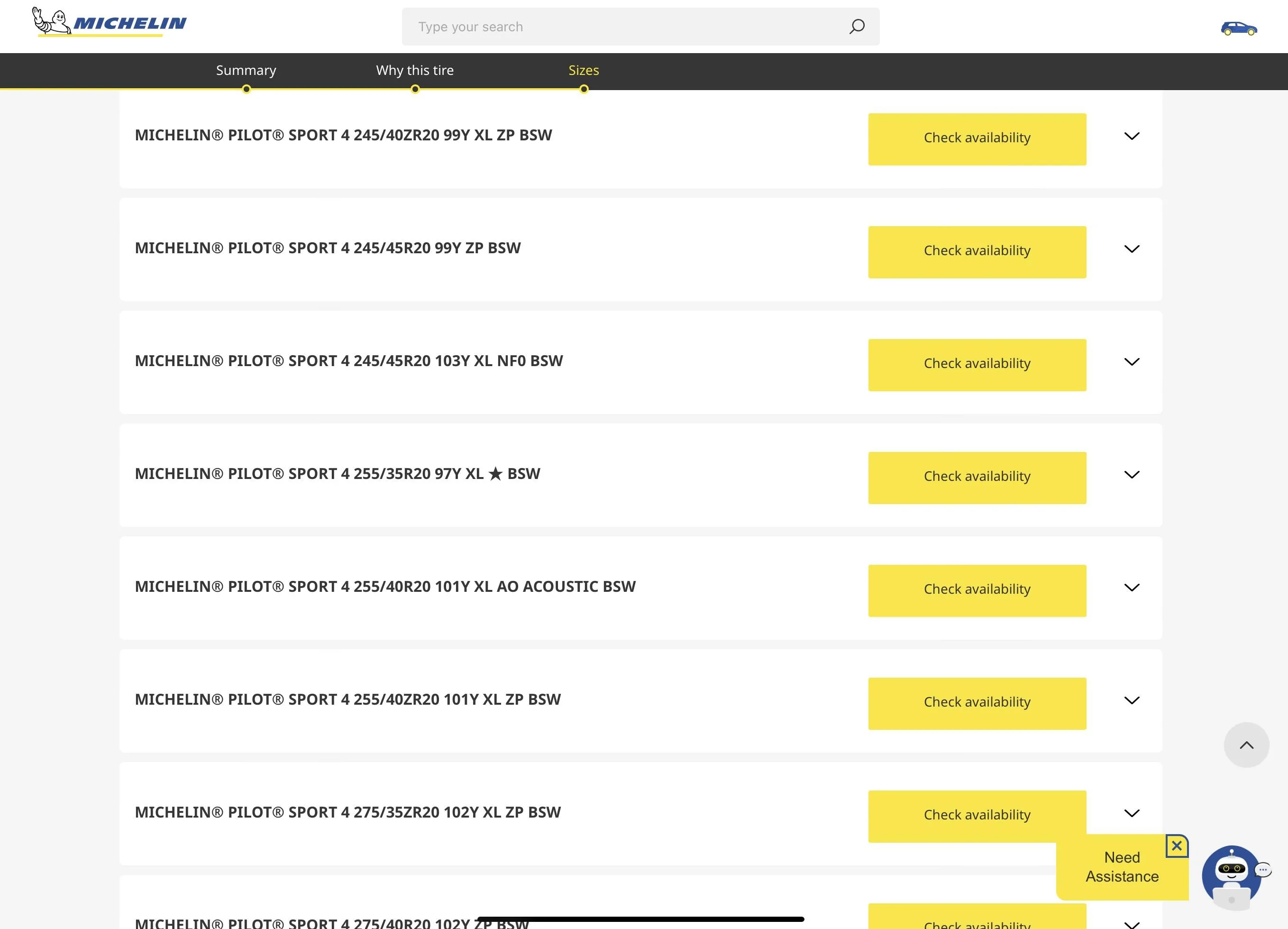

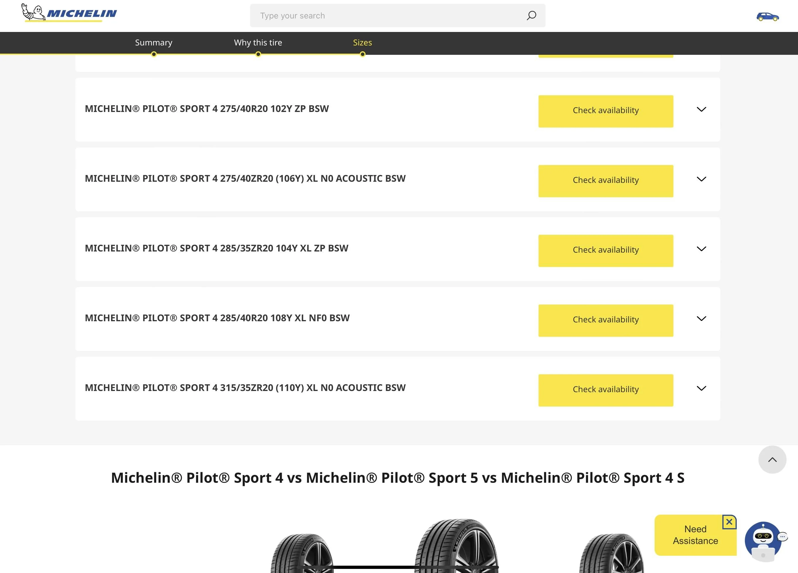

Keep in mind that the EV version of the tire, if it exists, may include the sound absorbing foam strip tuned specifically to reducing the frequencies of road noise that are most noticeable in an EV. For example, the NF0 version of the Michelin PS4 has this strip. BTW the foam strip interferes with the use of emergency spray sealant in the case of a tire puncture.

The Michelin website does not mention acoustic in NF0 sizes. Other sizes yes.
