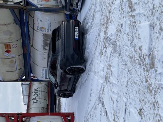

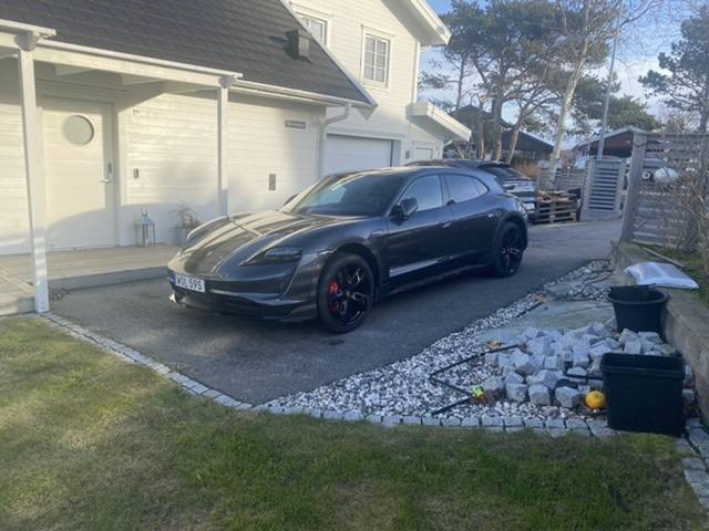

I have Michelin Alpin 5 if I do not remember incorrect. They have been changed once on our CT and its 21ā€, and will be changed each season.
We will own the car 3 years maybe, and spending 10000 euro on a new set of tyres/rims does not feel justified. The car will have winter tires from November to April as well, so a quite long period, and I am not found of the other rims to be honest, so this seemed like a perfect solution.
Ours are painted in satin black. If you have a lot of polished areas on the rims, I would not use them on the winter if you live in an area where a lot of salt is used on the roads to fight of the ice. Even if Porsches paint and laquer is good, it only takes one chip to ruin them.
Bottom line then, go for the Alpin 5. If you are insecure about what Porsche will say, call them quickly. Here, they changed them for me so no problem.
