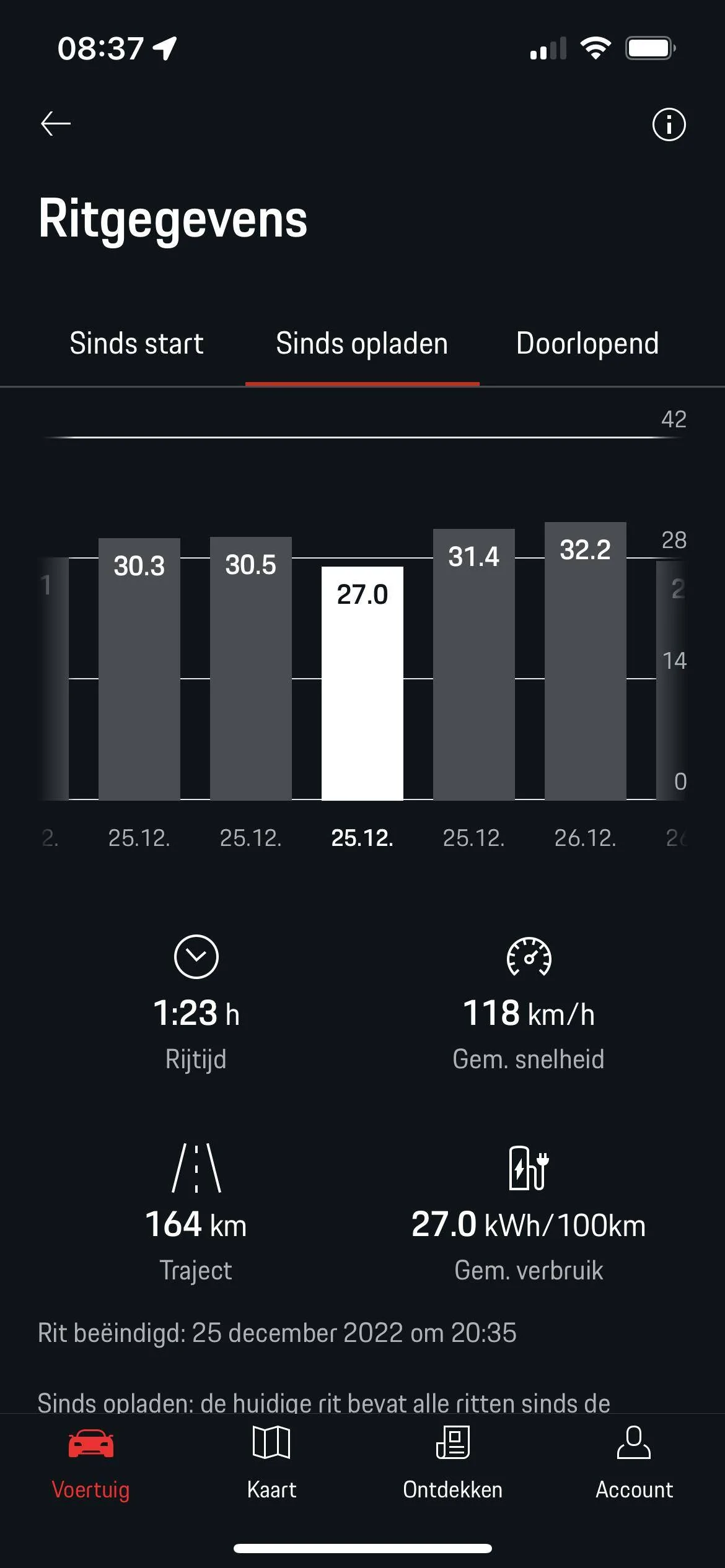

4 persons, no roofbox (packed light), 20 inch winter wheels. Ambient temperatures around 10 degrees C, too high for the time of year.
25/12 we drove 600 Km to Stuttgart. Average 100 Km/h, 30,2 kWh/100 km. Had to charge 3 times. Ionity Achener Land, Fastned Boppard, Ionity Bruchsal West. All accepted plug and charge. Fastned was 300 Kw but only charged at 150 even with preconditioning and low SoC, had too stay longer than planned. All 3 locations had multiple free chargers on arrival. I drove between 130 - 150 km/h where allowed

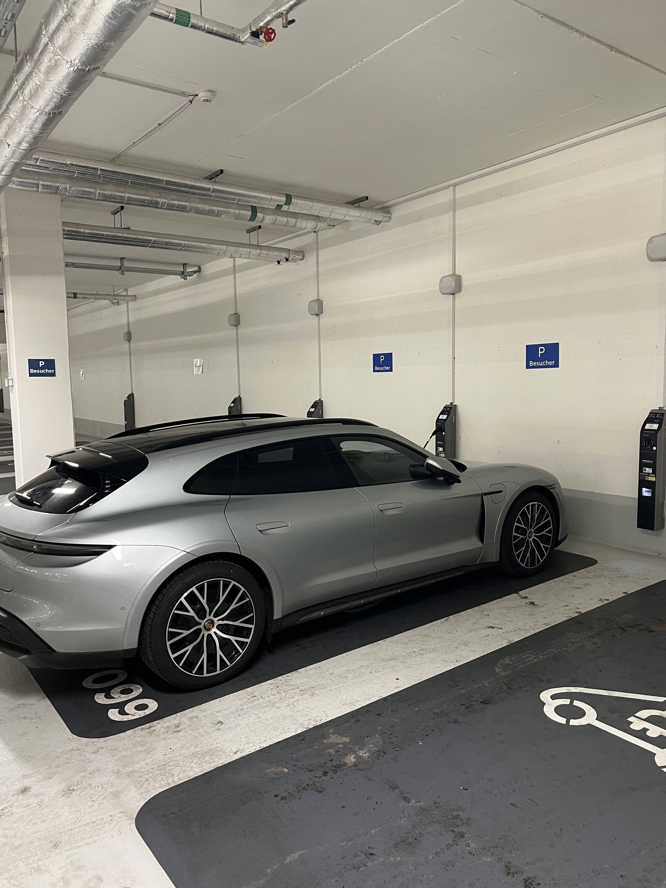

Stayed at Adagio Acces Stuttgart near the airport / messe. Multiple 22 Kw chargers available (probably only 3 public) in a safe closed but 24/7 accessible underground parking under the hotel. Left in the morning with a conditioned, 100 % charged and 25 degrees battery. The hotel is doable, the chargers however really good and so was breakfast.

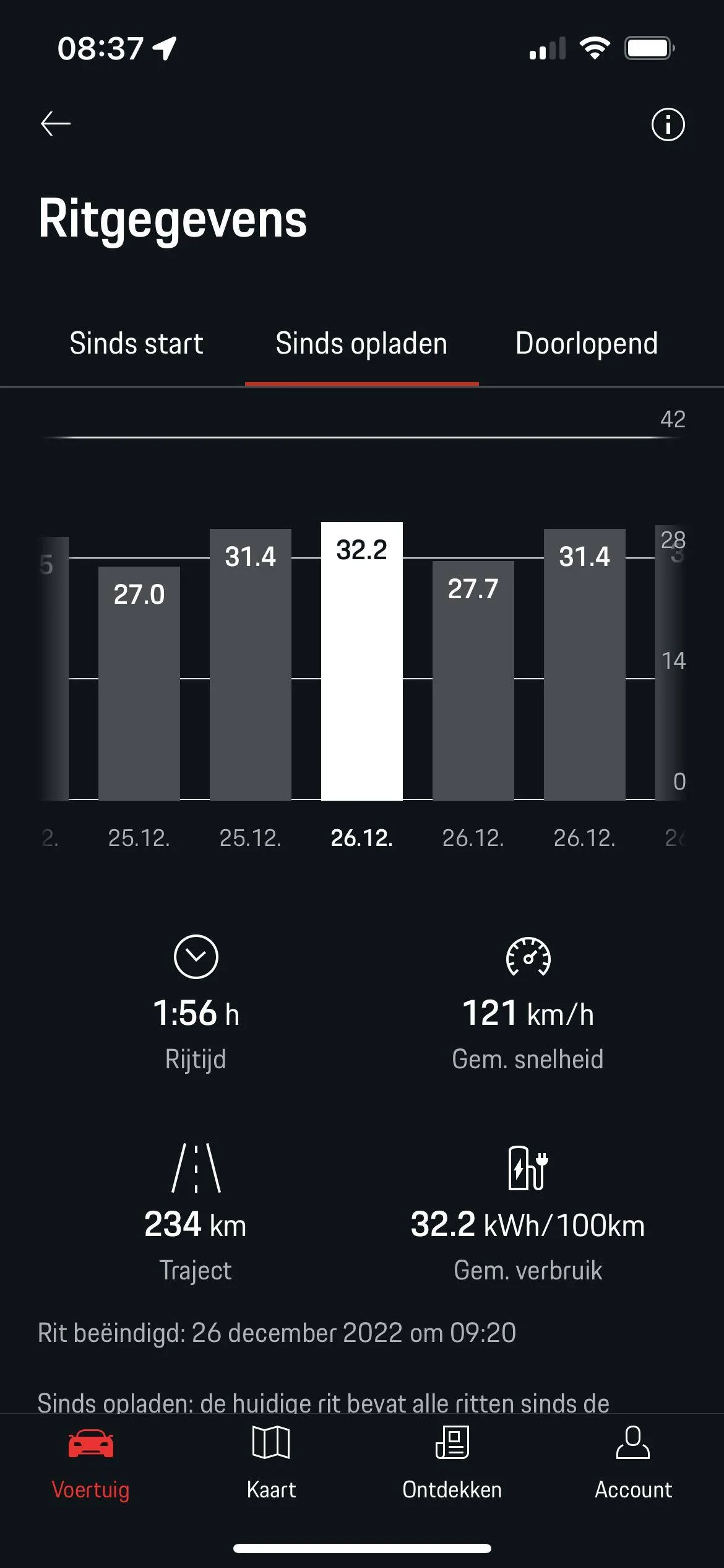

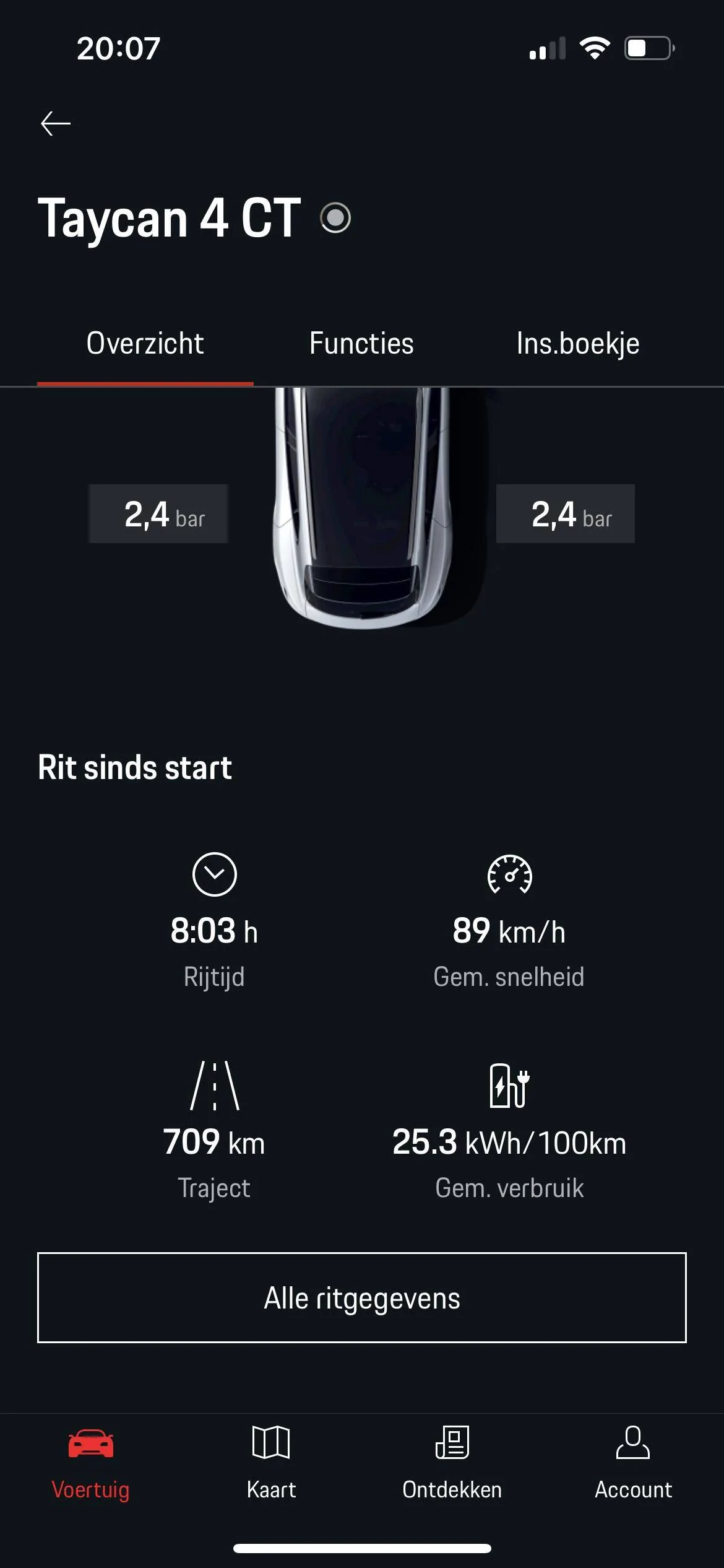

the server is down so I don’t have the last 220 km but for the first 700 km the average speed was 89 km/h and 25,3 kWh/100 km which is much better than 5 days before. Driving up hill took 30 % SoC and going down was almost free.
I drove over Switzerland, France, Luxemburg for the return trip.
227 Km, 85 km/h, 22,9 kWh/100 km. Freezing temperatures but first 35 km downhill. Arrived downhill with 98% SoC.

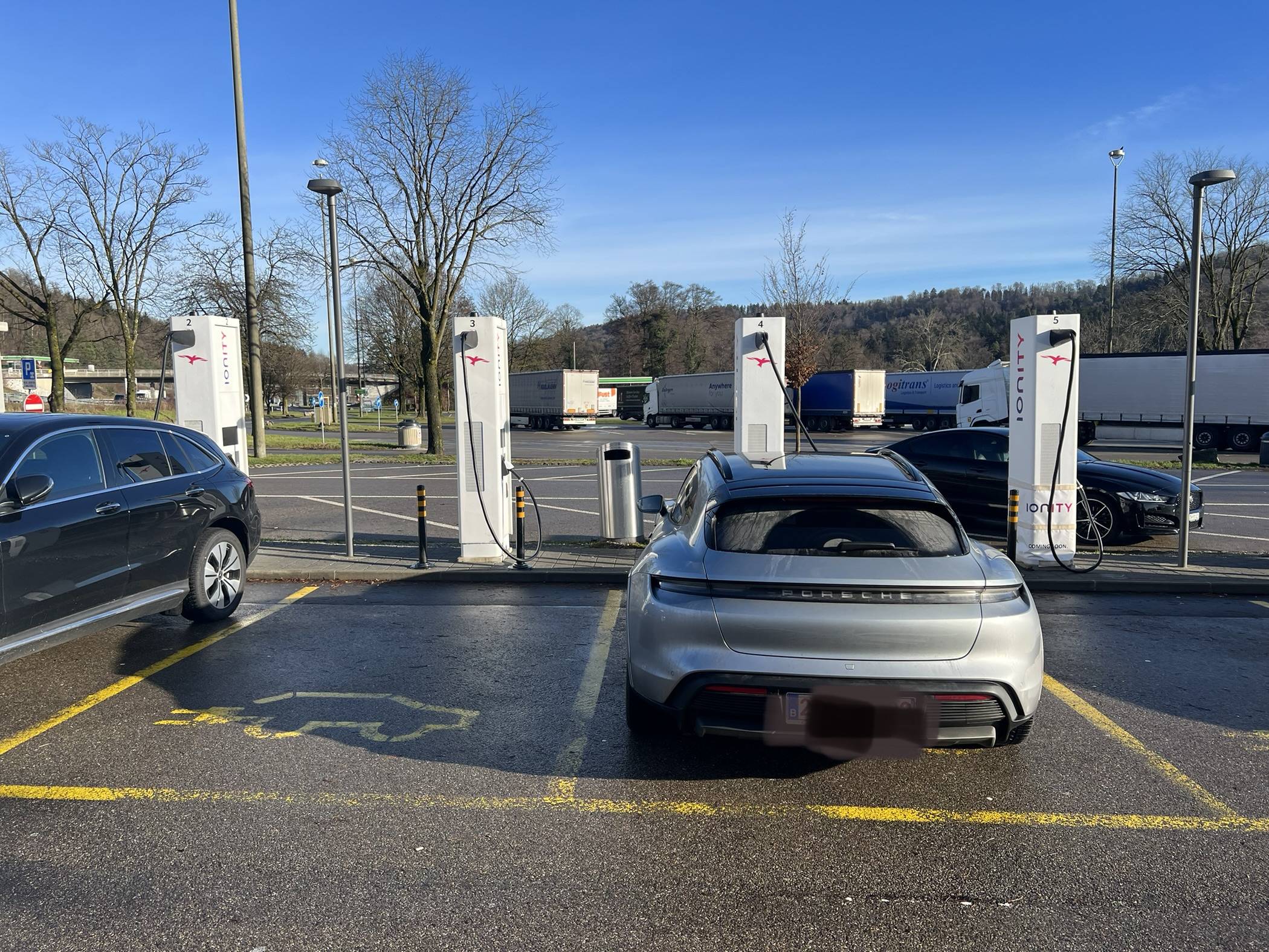

first charge Ionity. Charge speeds > 220, 18 minutes for restroom, coffee, sandwich , higher SoC than needed.
second stop planned at Ionity Haut Koningsbourgh. PCM showed 0/8 chargers available and sometimes 1/8. This location has six 320 Kw chargers but also two 50 Kw chargers. When using the info on PCM: look at the details of the chager it shows all available chargers but some may be slow. Anyway if pcm is showing 0/8 and 1/8 chargers free during a 1.5 hour trip you can be sure there is a queue of cars waiting for a charger. And it was. My wife said we only need one when it showed 1/8 5 minutes before arrival so we checked. Ten minutes before a Volvo C 40 passed by and I only realized then that he was going for the same charger. At the exit I was behind a Mach E and EV 6 and a couple of cars further the same C 40. All looking for the Ionity charger and after arrriving no free spots off course. I had a plan B : Allego Duttlenheim with six 300 Kw chargers 38 Km further and showing 6/10 free, I still had 90 km range. The EV 6 and C 40 stayed but the Mach E went back to the highway too. Probably the same plan as me but lower SoC because he was only driving 90 km/h where 120 was allowed. I arrived earlier, 3 free chargers, one taken by a Cupra just before me, one for me and one for the Mach E that arrived a couple of minutes later. Charge speeds up to 220. Stayed for coffee and left at 85 SoC.

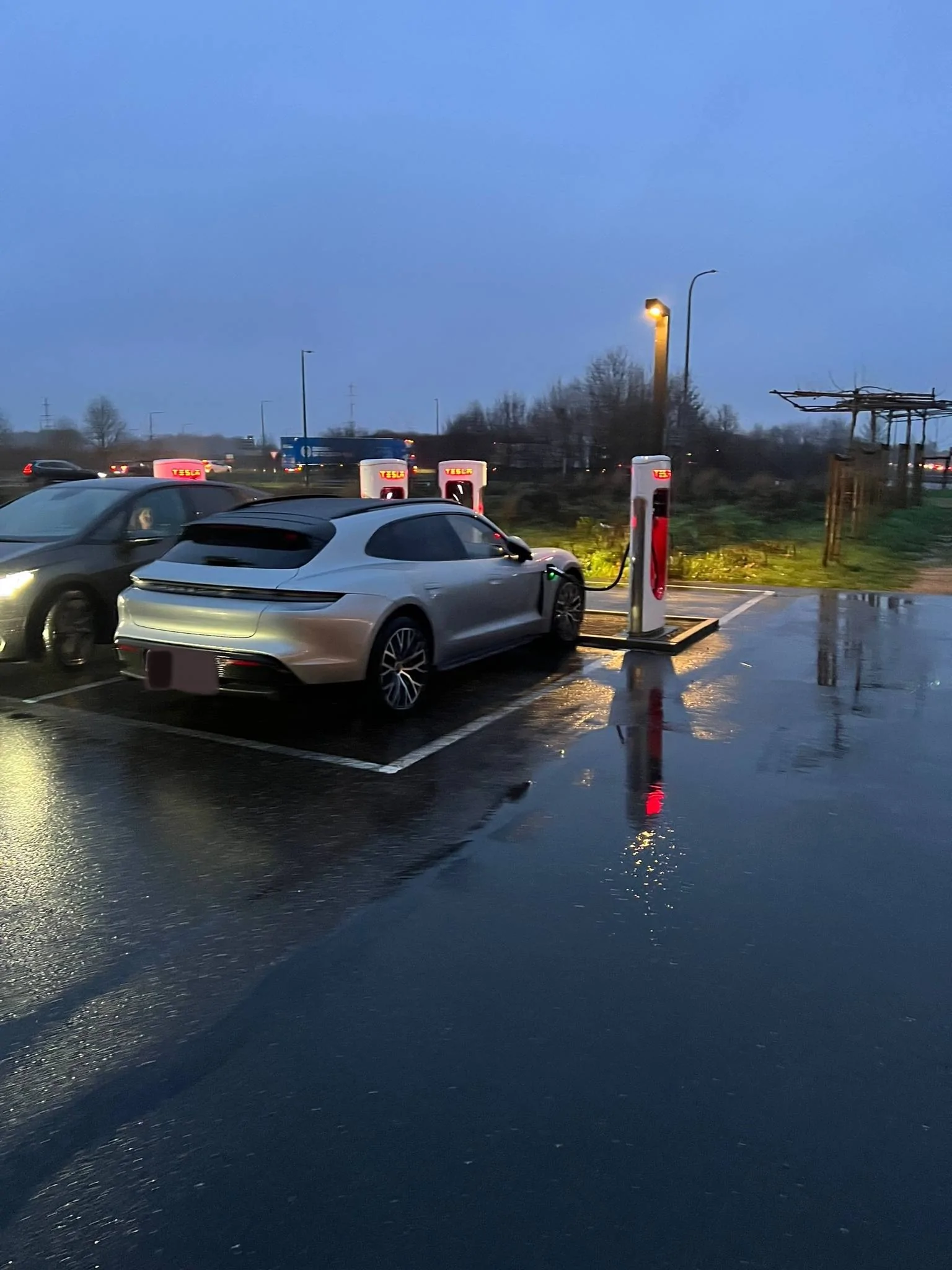

Three possible ionities to charge but all showed the be really busy in PCM and the app. Plan B again: charge to 100 % at Tesla Arlon and have dinner at Van Der Valk hotel restaurant. I would have had 10 km left and didn’t dare. Drove over Saarlouis Schengen because of multiple fast chargers on that route and non on the peage in France. Charged 5 minutes in Schengerwis, 300 Kw charger speeds > 200. If I would have charged to 90% in stead of 85% before I wouldn’t have needed this one.
connecting to Tesla was easy. Charger configuration was good for the Taycan. After connecting PCM showed a message that charge speed was limited by the charger. Don’t know if it was 150 or 250 but charge speed was 95 Kw. This wasn’t a problem because we were having diner anyway and planned to stay a hour. Left with 100 % SoC and arrived home with 26 %. By far the most expensive charger on my trip. 64 euro for 73 kWh.

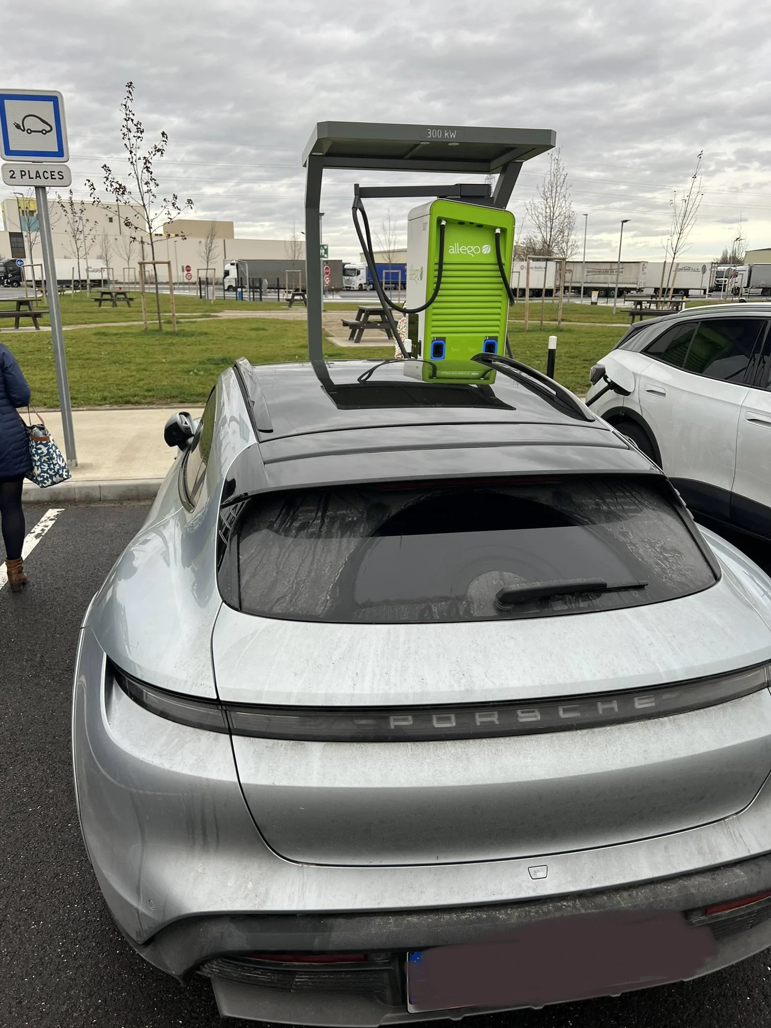

For the distance traveled in winter, your car is amazingly clean
That’s why I chose silver. And the picture in the parking garage is on the way going. At Ionity/ Allego was today and then it started raining heavily for the last 400 km. At Tesla it was almost clean.

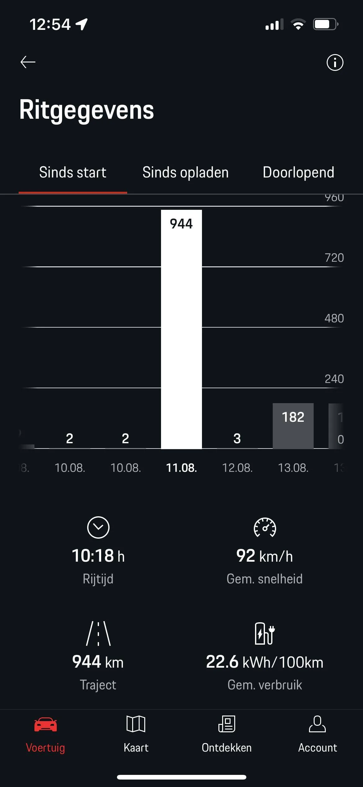

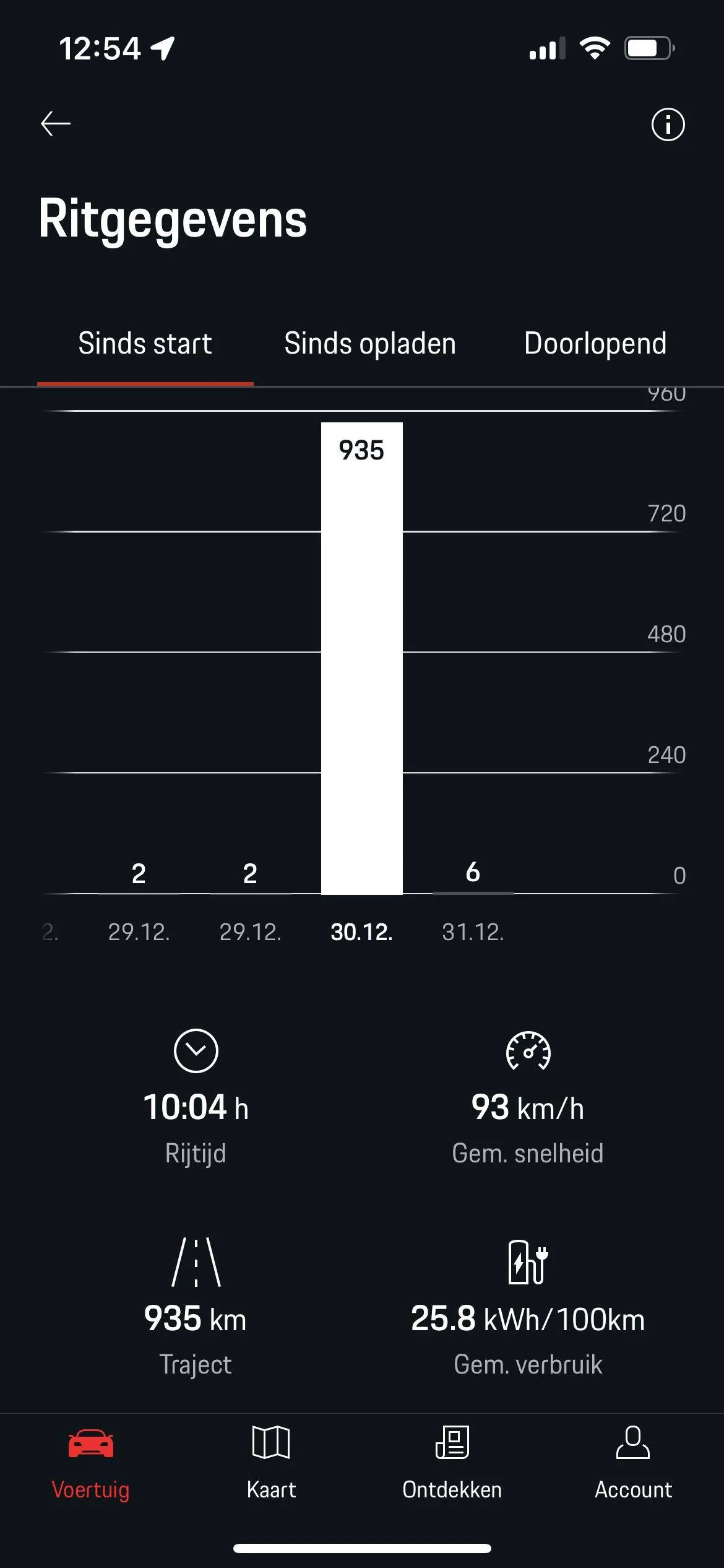

I did the same trip this summer returning from Galtur to Belgium. I have a print screen of both trips.
Summer : 25-30 Celsius, 20 inch summer tires, rooftop box, 4 persons and a dog and more luggage. Trip over Germany. Drove a bit faster but never above 140-150 km/h for a longer time. Charged 4 times but probably would have made it in three. Didn’t dare to go low yet.
Winter : 10 Celsius when out of Austria. Beginning was freezing and temp gradually increased. No dog, no roof box, 20 inch winter tires. Drive just a bit above speed limit.

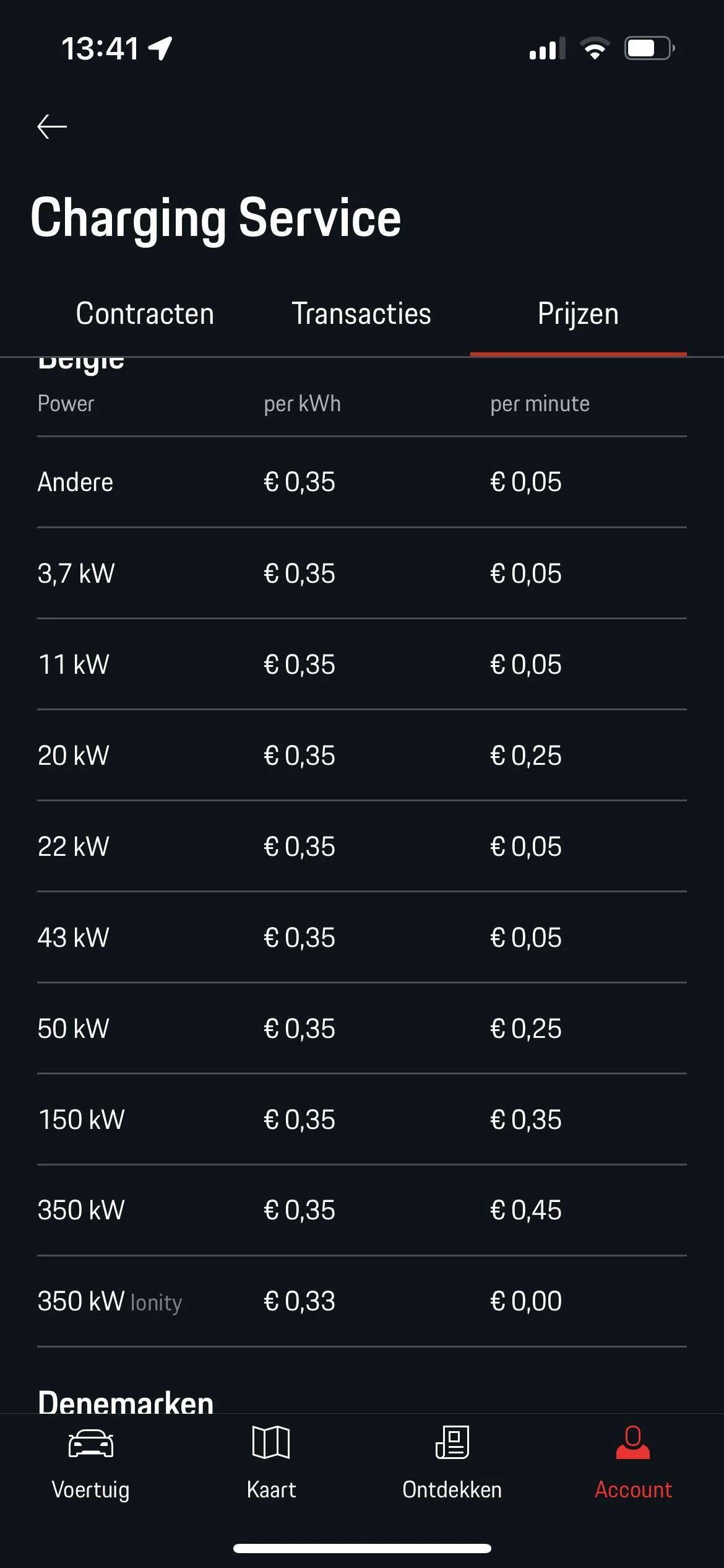

With the Porsche card charging is not free. However the price per KWh at Ionity is 33 cents. Tesla asked 83 cent yesterday. Fastned 89 cents. Shell 79 cents. So different prices for the same charger depending on what RFID card is used. Differences can be big
On non Ionity fast chargers Porsche asks 35 cents per kWh so still quite cheap but also 35-45 cents a minute for 150-350 Kw chargers. Charging times are around 10-15 minutes. So still cheaper for fast charging.
For 22 Kw and less with the Porsche card it is also 35 cents per kWh but supplementary 5 cents per minutes. If you charge over night at a hotel and plug in at 6 pm and unplug at 8 am it will cost 14h x 60 minutes x 5 cents = 42 euro just to be plugged in 14 hours. And 20-30 euro if charging to 100%.
Plug surfing for example asked 53 cents per kWh for the 22 Kw charger but no price per minute. Shell 42 cents per KWh and 1 cent per minute.
it is worthwhile checking the prices before using a specific RFID card especially if they bill plugged in time / idle fees.
Fast chargers : Porsche card. Some fast chargers don’t accept the Porsche card and alternative needed.
22 Kw chargers : other alternatives are better like Shell. Make sure to unplug after charging when supplementary price per minute. Charging etiquette: also clear the charging space when not charging.
