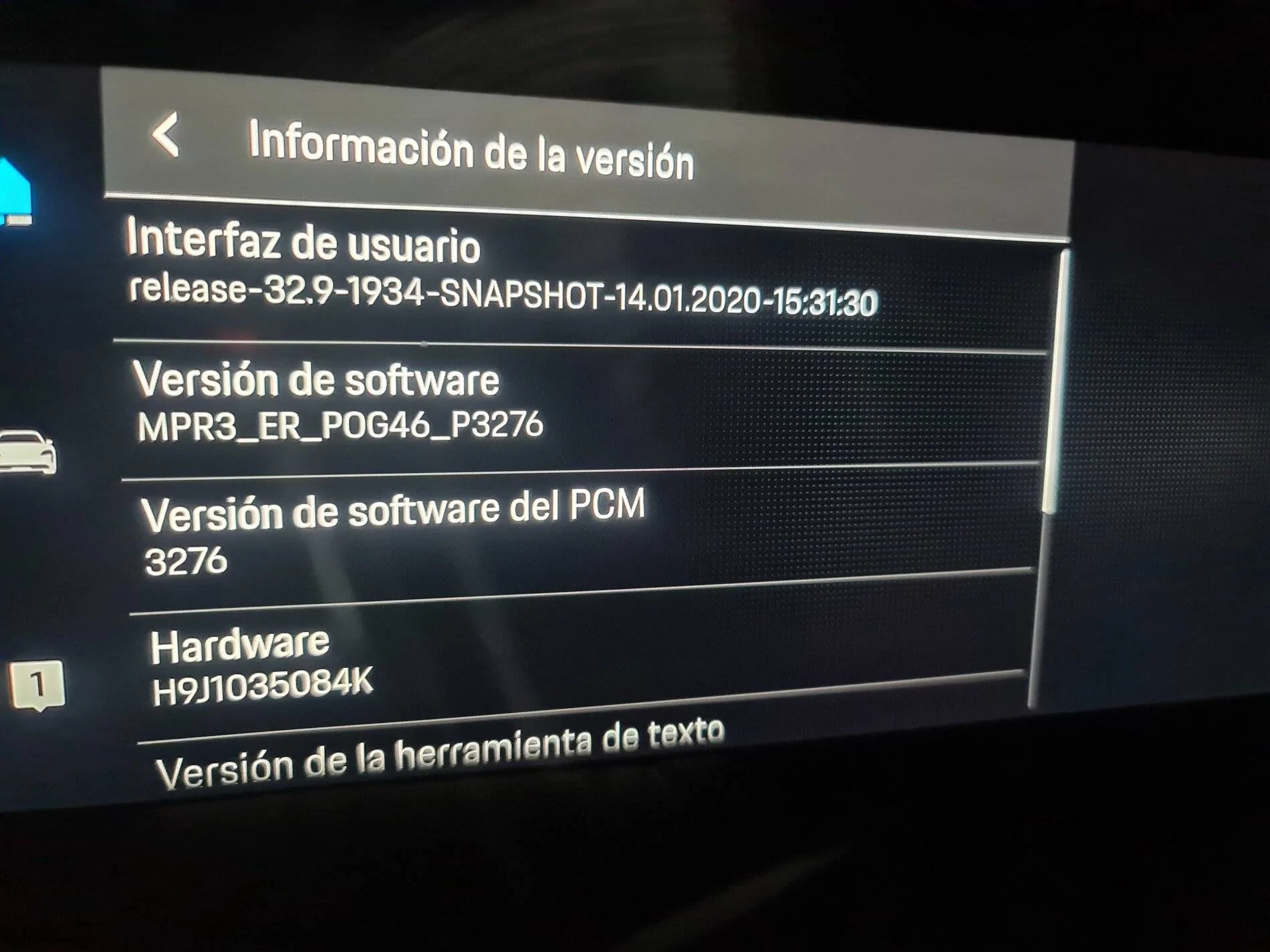

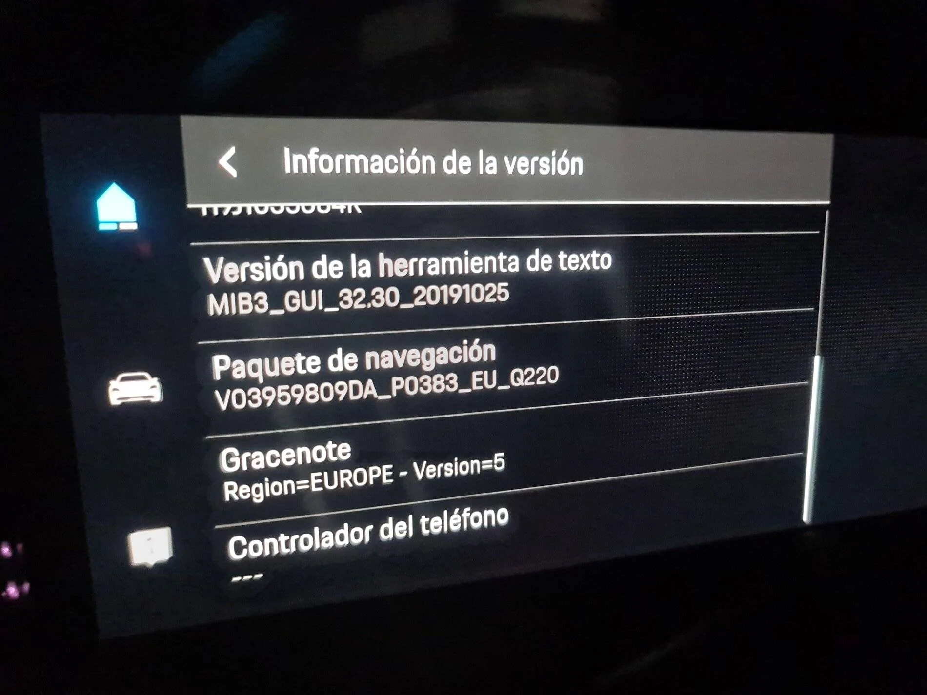

My TAYCAN 4S was updated yesterday.
No changes in PCM release, 3276.
Here you have pictures after WLG2 Campaing was finished.

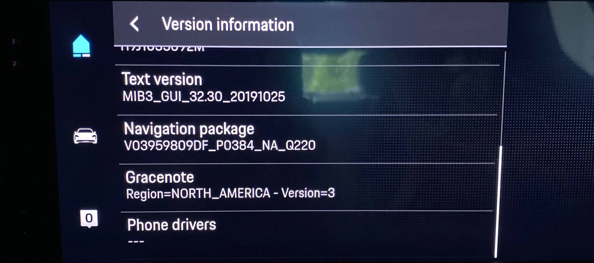

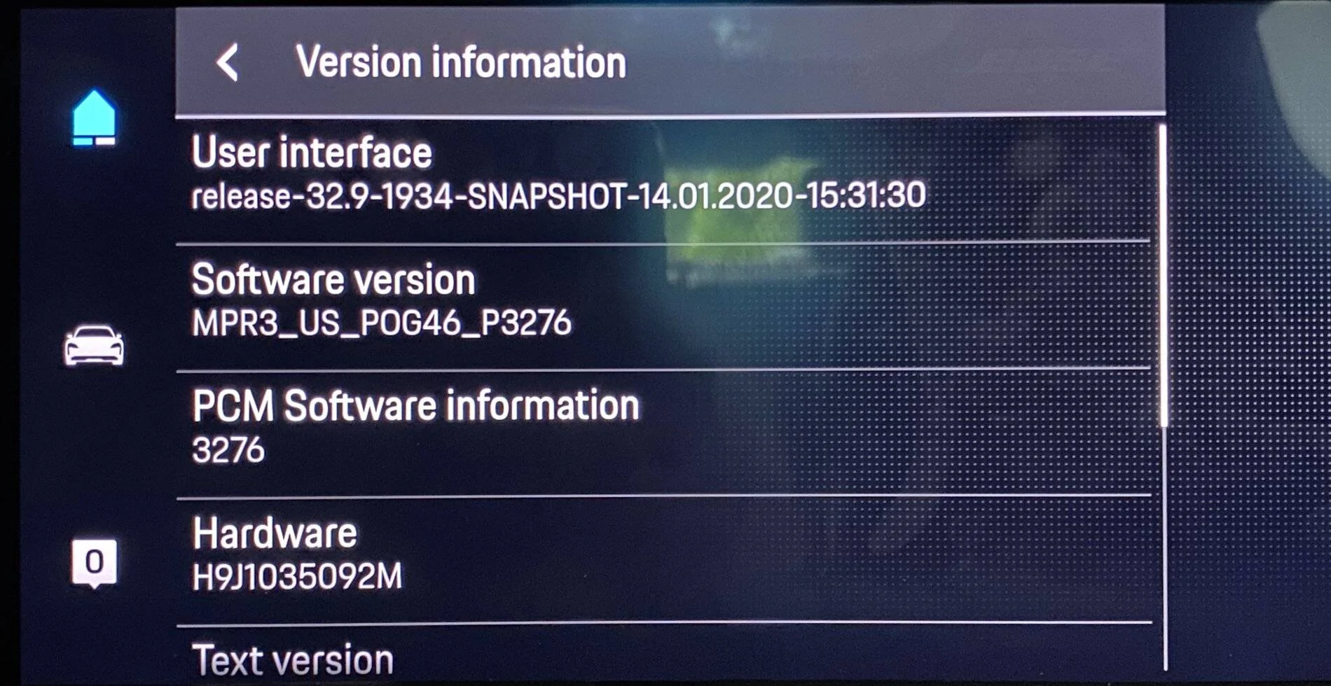

My version info and I stand corrected on how region-specific the software build are:
