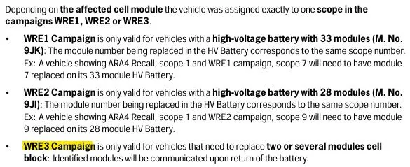

My car got called again to Porsche, directly from the dealer - so no formal notice, for additional battery work, by order from Porsche central.
This follows 2 months after my car going in for ARA4 recall.
He is saying the campaign number is WRE3. Has anyone seen this / had this? I haven't found anything online about it.
Seems to be some sort of expanded scope of work on ARA4.
Additionally I found out that porsche hongkong can look up recalls for worldwide cars, instead of location specific: https://recall.porschehk.com/en/ . So usefull tidbit.
WRE3 doesn't seem to be registered yet, so it somehow looks like I got informed before Porsche actually releasing it?

WRE3 Is one category of VINs of the ARA4 battery recall.
See the remedy TSB for ARA4: https://static.nhtsa.gov/odi/tsbs/2024/MC-11008604-0001.pdf
Also see ARA4 recall thread: Recall: High-Voltage Batteries May Short Circuit (ARA4) - March 20, 2024
Note that in the US, ARA4 VINs are turned into the dealer and the HV batteries are removed and sent to a contractor at another location for module replacement. This may not be the process used for ARA4 VINs outside the US.
