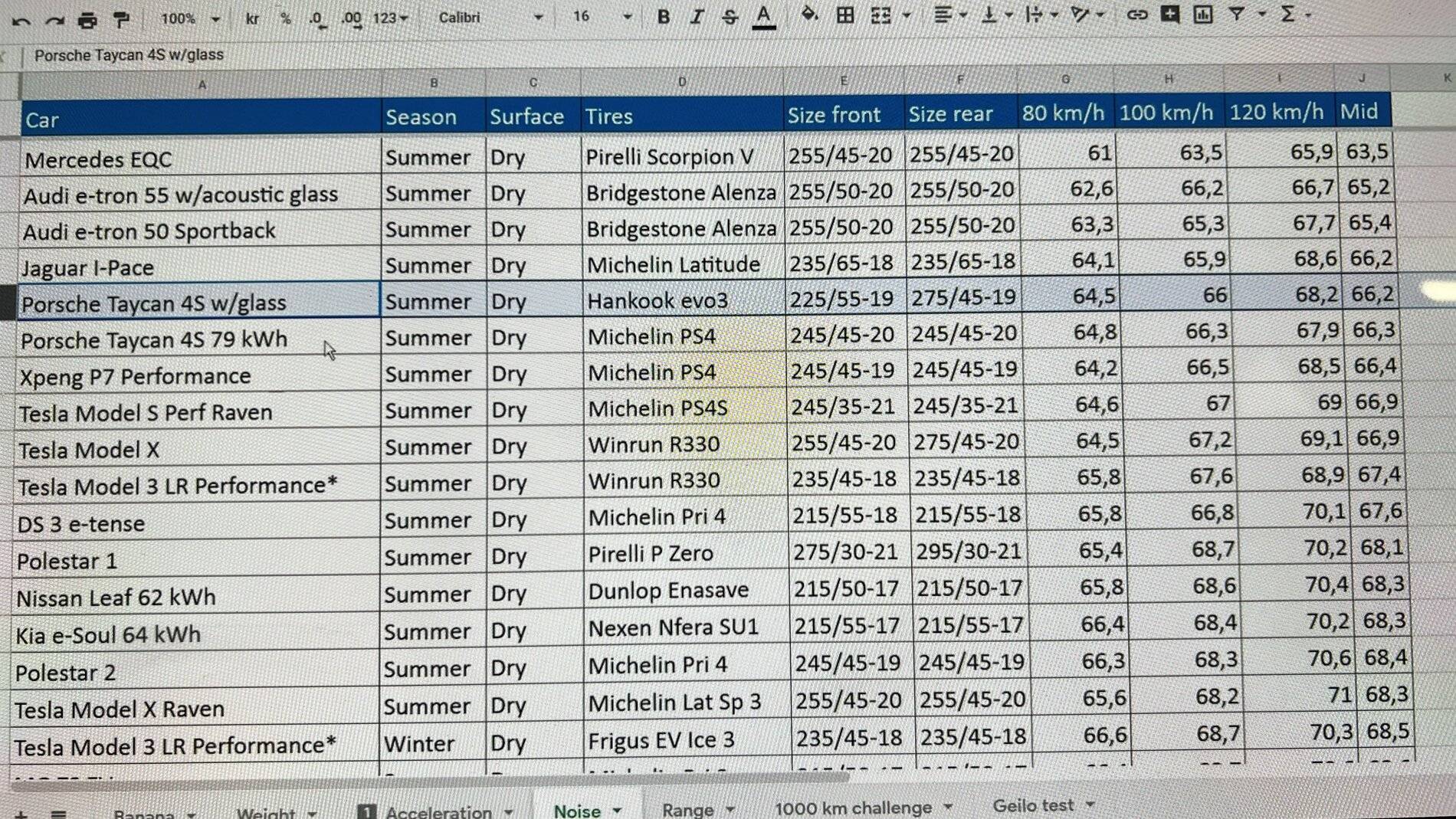

If you watch the video there are a couple of points he makes:
1. He felt the noise was less in the car with the acoustic glass
2. There were different tires and he claims the Michelins, are quieter than the Hankook evo3's so that would also make a difference
3. He wasn't even sure if the other Taycan had the acoustic glass or not
Bottom line, he felt that with the same tires the acoustic glass makes a significant difference. I wouldn't necessarily use the quoted test results as a gold standard ;-)
...and offered at the end rather choose electric sport sound than acoustic glass...
It is just a one man opinion (feeling) next to the numbers.
But of course it is still not a scientific source.
We could not find better.

I'm currently 2.5 years into driving an e-tron with noise insulated glass. The standard glass cars I test drove and have had as loaners, while acceptably quiet, don't compare. The dual pane glass is quite noticeably better at attenuating wind and traffic/outside noise. I'm assuming similar performance with the Porsche glass, but may be disappointed.
TeslaBjorn's tests are interesting, but far from scientific. Too many variables aren't accounted for; meter position, tire and wheel selection, environmental factors, and sound level weighting are all over the place.
As to thermals, a nice addition. BTW, both Taycan's in the video posted above have the factory insulating glass. It isn't obvious in the title, but is evident at 3:04 and mentioned at 4:40. I plan on tinting as well.

As you can see from the 'tyre review' test below, the Hankook evo 3's were noisier than the PS4's but the car with insulated glass and evo's was somewhat quieter. I would definitely go for the insulated glass for both the noise and thermal barriers.
