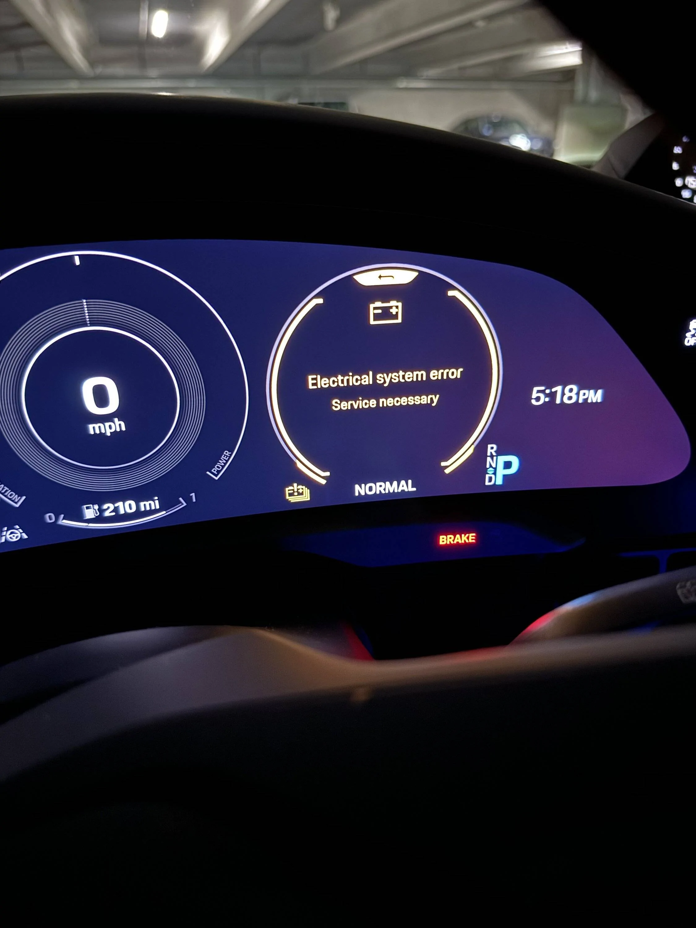

“Electrical system error - service necessary”. 2022 CT Turbo. 11,000 miles. Can’t shift into drive- totally bricked. Left it charging, came back 3 hrs later and saw the error.
Let it sit locked a couple times for 20 mins- same error.
tow truck to dealer :-(, missed dinner with the family, no loaner available.

let us know outcome!

Sorry this happened to you as well. I suggest continuing this conversation in the large recent thread on this topic:

That thread is discussing the red error. I’ve got the yellow. 🤷‍♂️
It usually means the same thing just typically the yellow one doesn’t leave you stranded.
a couple typical culprits
high voltage charger
High voltage booster
Bad battery cells
Bad high voltage batter
hopefully your car gets sorted soon. Mine has been out of commission 15 weeks now with the same yellow error but hopefully getting it back soon

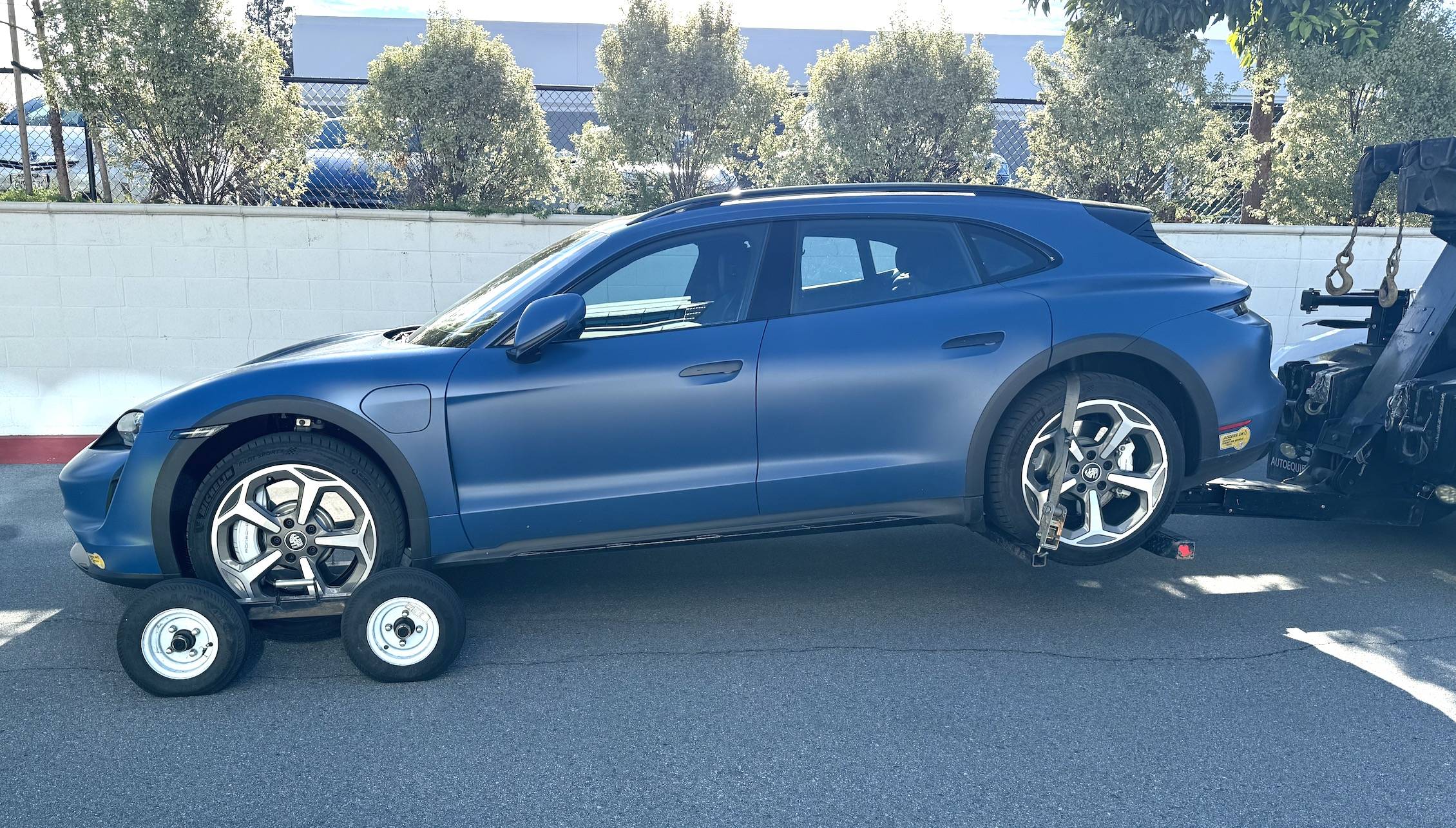

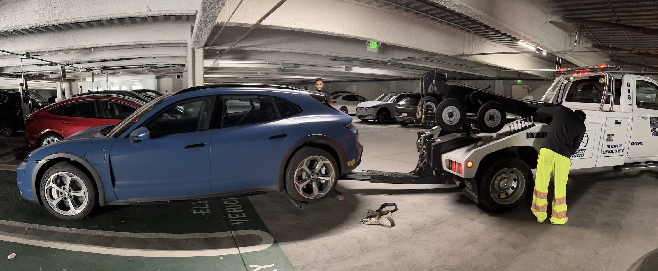

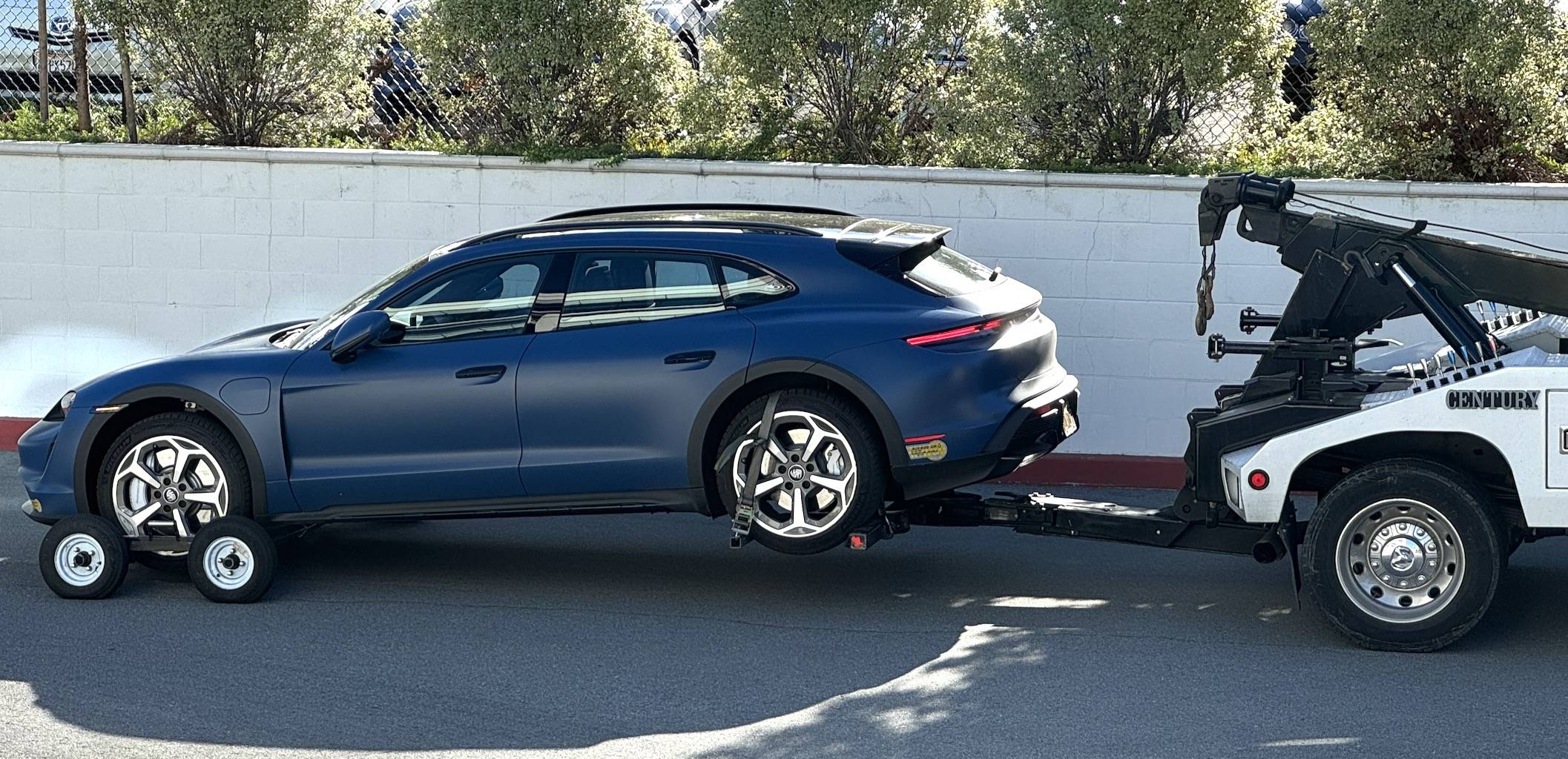

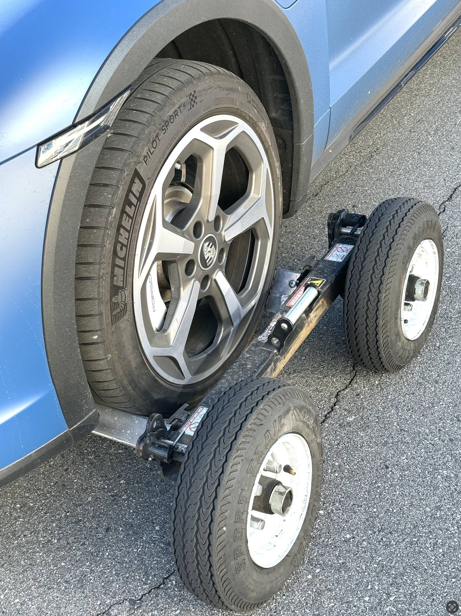

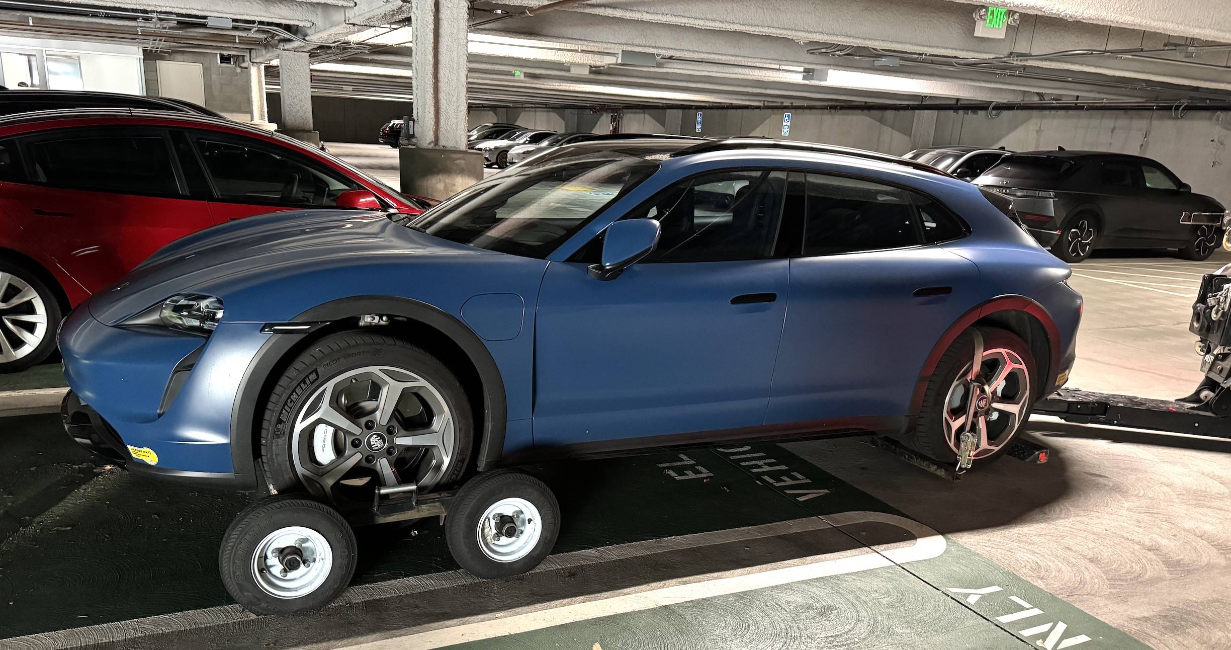

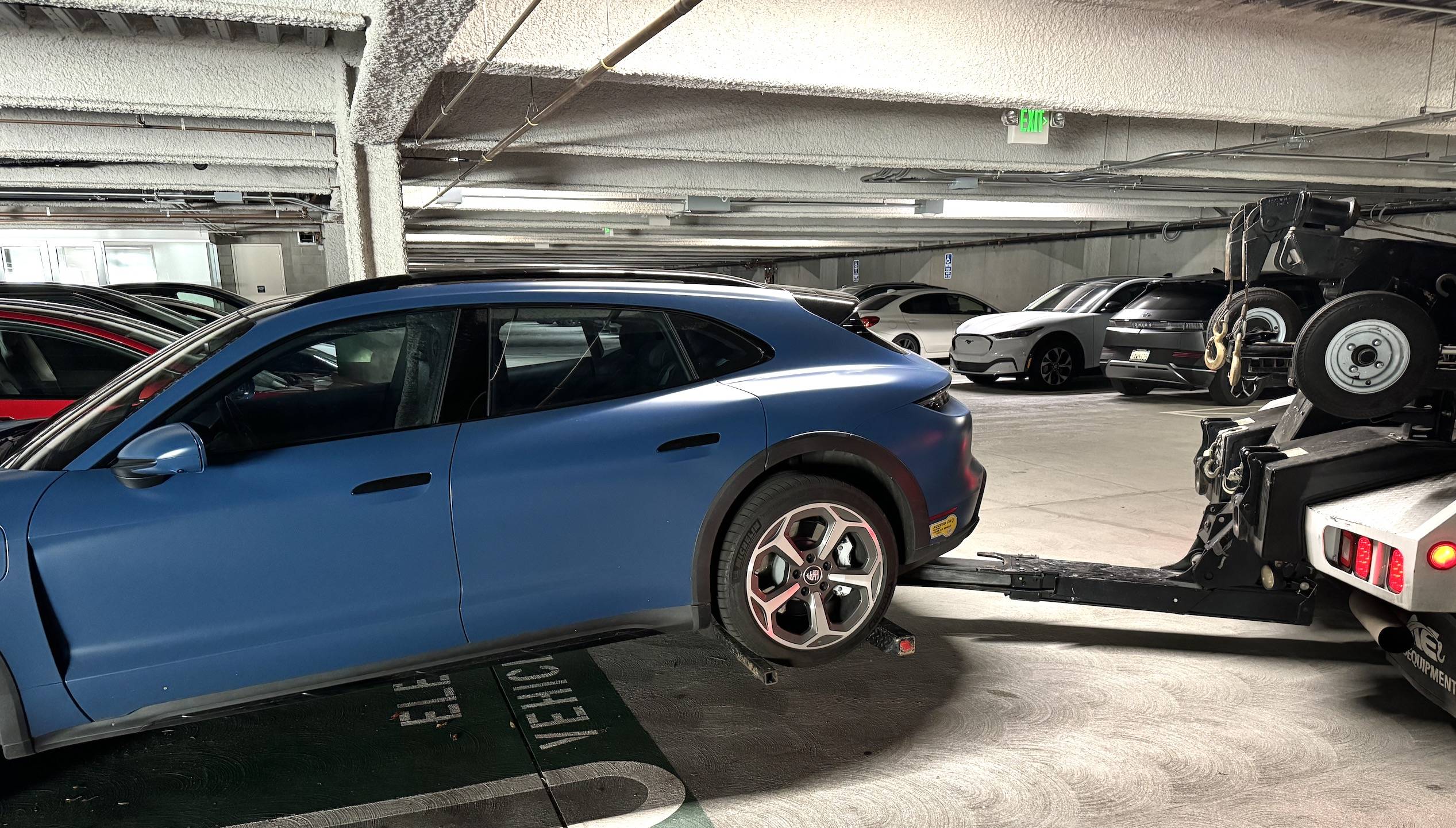

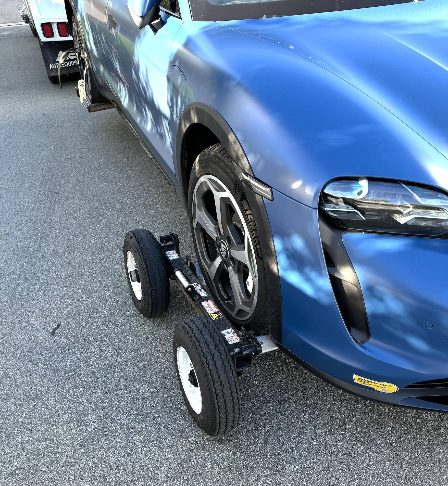

Incase anyone's interested to see what it looks like to put a Taycan on a wheel lift to get it out from a low-clearance underground garage, here ya go. The dillaship just called, it arrived safely.
Porsche Taycan Yet another electrical system error Screenshot 2023-12-11 at 3.03.56 PM
Porsche Taycan Yet another electrical system error Screenshot 2023-12-11 at 3.04.25 PM
Porsche Taycan Yet another electrical system error Screenshot 2023-12-11 at 3.04.09 PM
Porsche Taycan Yet another electrical system error Screenshot 2023-12-11 at 3.03.44 PM
Porsche Taycan Yet another electrical system error Screenshot 2023-12-11 at 3.03.30 PM
Porsche Taycan Yet another electrical system error Screenshot 2023-12-11 at 3.03.19 PM
Porsche Taycan Yet another electrical system error Screenshot 2023-12-11 at 3.03.09 PM
