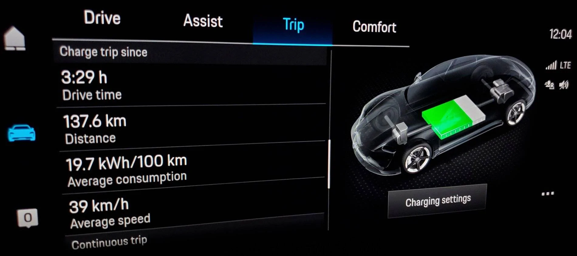

I charged to 100%. Mostly city driving, all in Normal mode.
I guess it is very similar with Turbo and Turbo S. I have 20 inch wheels, which might be the biggest difference...

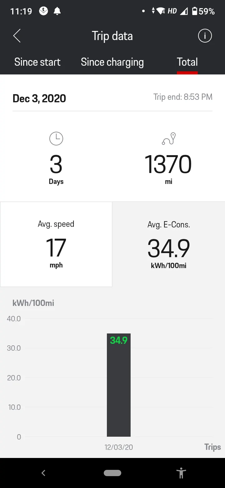

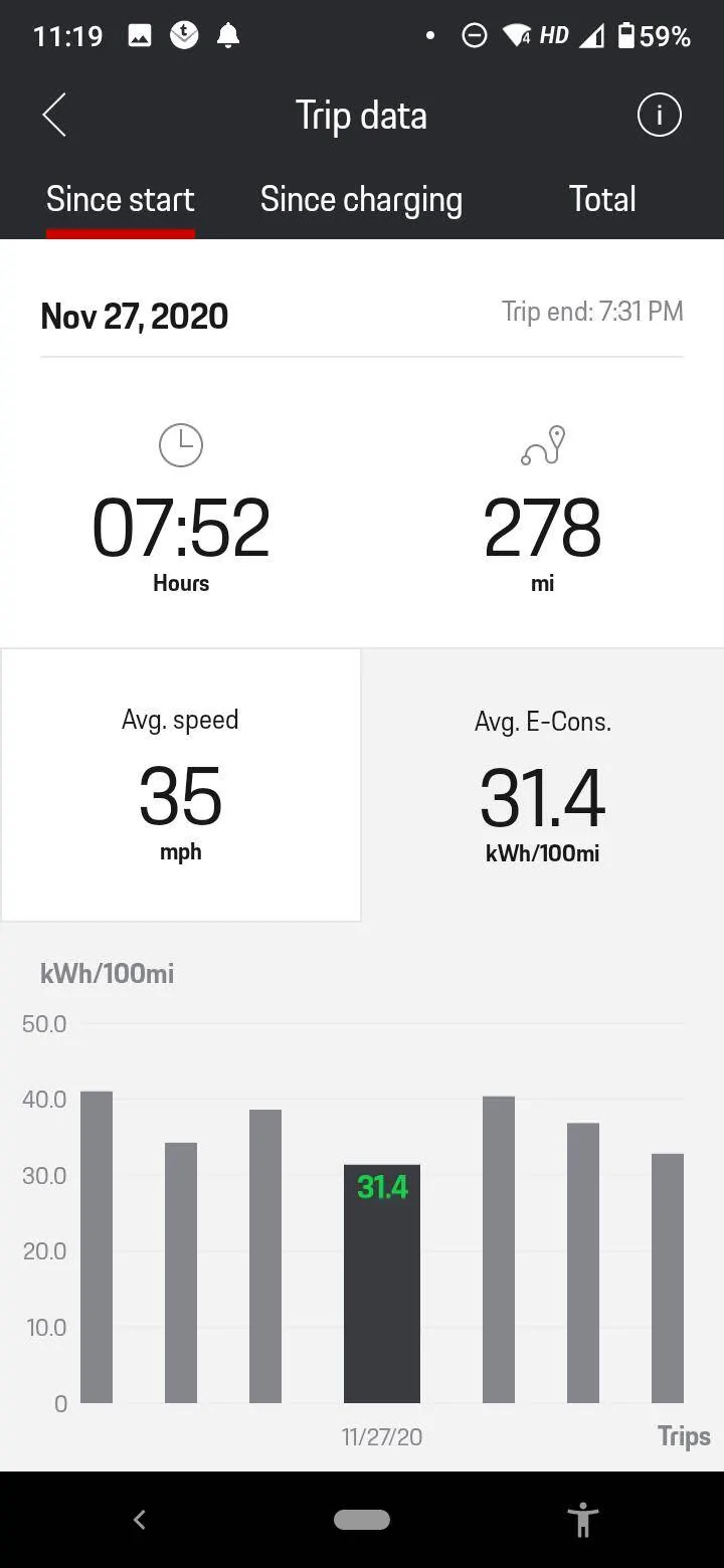

I am totally impressed with the Taycan range, I have the 4S+ with 20" Turbo wheels and 250mi us like falling off a log, if I really range mode it and stay under 70mph I think even 300mi would be quite reachable, but I cannot seem to stay below 70, must be a defect in my car.
Average since delivery is 349wh/mi or 217wh/km and that's with 1370mi or 2206km. Driving mix: less than 5% Sport mode, 25% Range Mode, 70% Normal mode
See image from a trip to Goat Rock Beach fast freeways and 55mph country roads, slow average as I left car turned on during a lunch stop which left HVAC running too (in ECO) and 314wh/mi.
