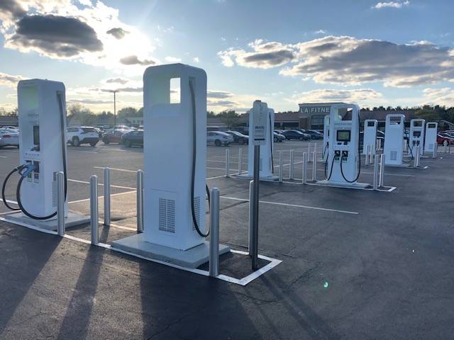

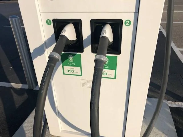

Just found these chargers 1.5miles from my house!!
Have you had a chance to enquire what the charging rates will be for your Taycan at these chargers.
