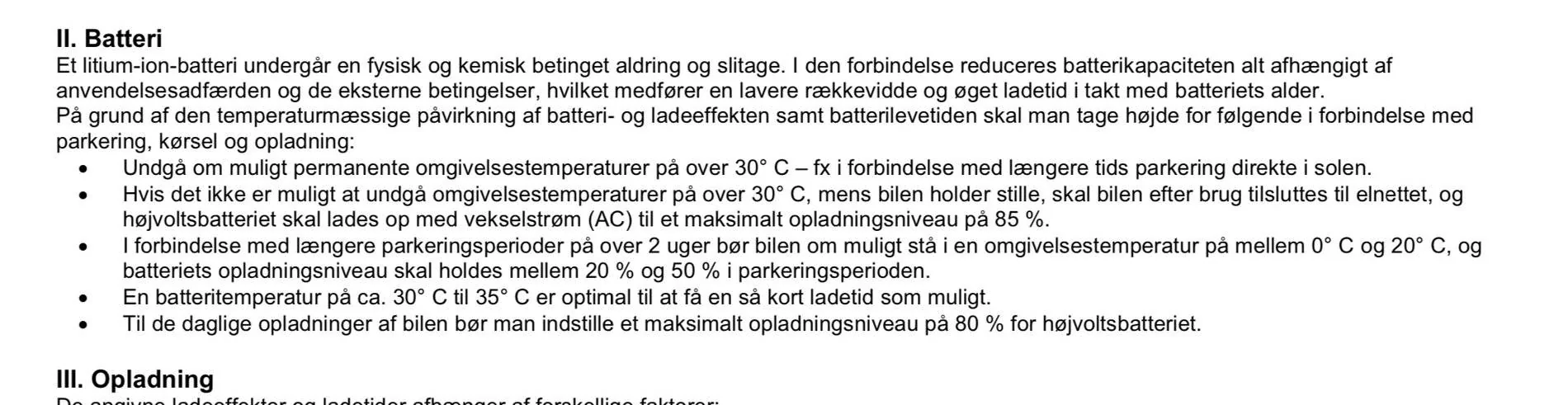

When I ordered the car there was a Garantie paper, and it says “for every day use the car must be adjuster to 80% max charge”.
If you can read Danish

Maybe someone got the same document in English!? But I was also surprised, for the buffer in the porsche battery is Very conservative. I drive a BMW i3, and I can not change the charging. Always to 100%.
They also write:
Parking for more than 2 weeks the % must be within 20-50%

In the Porsche Brochure I find this on page 51:
II. Battery A lithium-ion battery is subject to physical and chemical ageing, as well as wear and tear. This reduces the battery capacity, depending on the usage pattern and environmental conditions, resulting in a reduction in range and an increase in charging times as the battery ages. Due to the effect of temperature on battery and charging performance, as well as battery life, please consider the following when parking, driving and charging your car:
• If possible, avoid permanent ambient temperatures of over 30°C, such as prolonged parking in direct sunlight.
• If you cannot avoid ambient temperatures of over 30°C when stationary, connect the vehicle to the mains supply after use and charge the high-voltage battery with AC (alternating current) to a maximum charge status of 85%.
• If the car is left stationary for more than two weeks, the ambient temperature should, if possible, be between 0°C and 20°C and the battery charge status maintained between 20% and 50% during this time.
• For the shortest possible charging time, a battery temperature of approx. 30°C to 35°C is ideal.
If charging the car on a daily basis, the maximum charge status of the high-voltage battery should be set to approx. 80%.

Same Text as the Danish.
