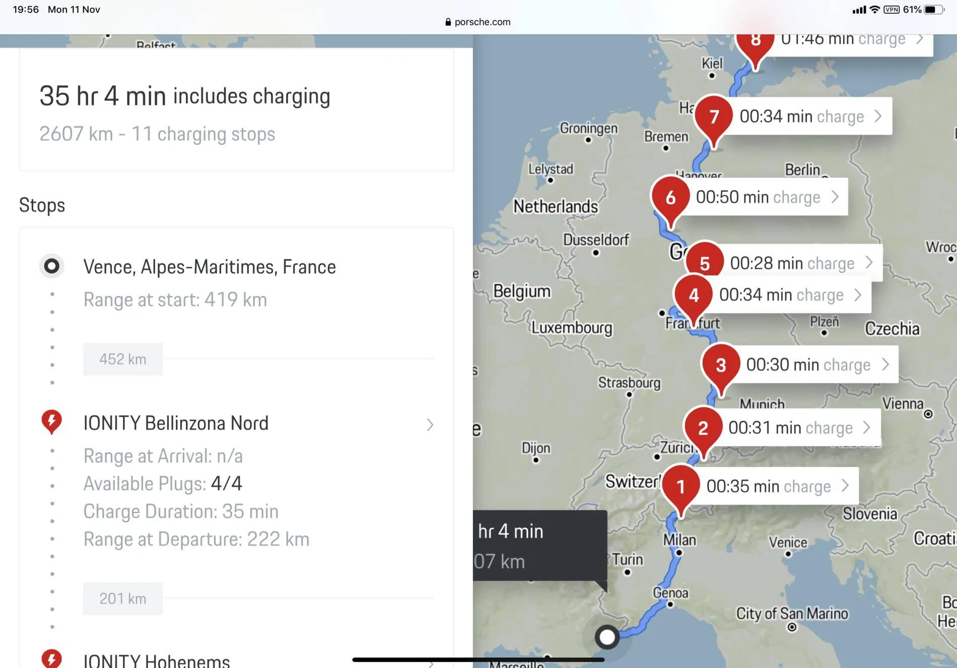

I just tried to plan a route that I have driven a couple of times on the Porsche website. The route I was looking for was between Vence in southern France to Stockholm, Sweden. Google maps, Waze etc would normally choose a route through Italy, Switzerland, Germany, Denmark etc. for a normal ICE car. This is the shortest and the fastest route normally. This would be planned to take about 25 hours or so, and the route is about 2600 kms. Of course you would not drive such a distance in one go but for planning it is ok.
I then tried the Porsche website and put the time down as summer! It would take 41 hours and the route was over 2800 kms going though France, Belgium, Netherlands Germany and Denmark!!! A difference of 13 hours! And the worst part was that it planned for a number of charging points where there was only ONE single 50 kW charger! It did not use many IONITY chargers on the route either? If the 50 kW charger was broken or occupied you would be stuck! This certainly must be addressed by Porsche since that would be unacceptable!
I then tried to switch the planning to Winter! And to my surprise it would plan a route as per Waze!! Same route more or less. Only 2600 kms and 35 hours trip? GREAT??? But wait! The car needed to be fully charged and the range was indicated as 419 kms! Problem was the first charging stop was planned to be 452 kms away! I did not check the other stops but this was a surprise and must be a flaw? Different routes winter and summer and no way of reaching the planned stop.

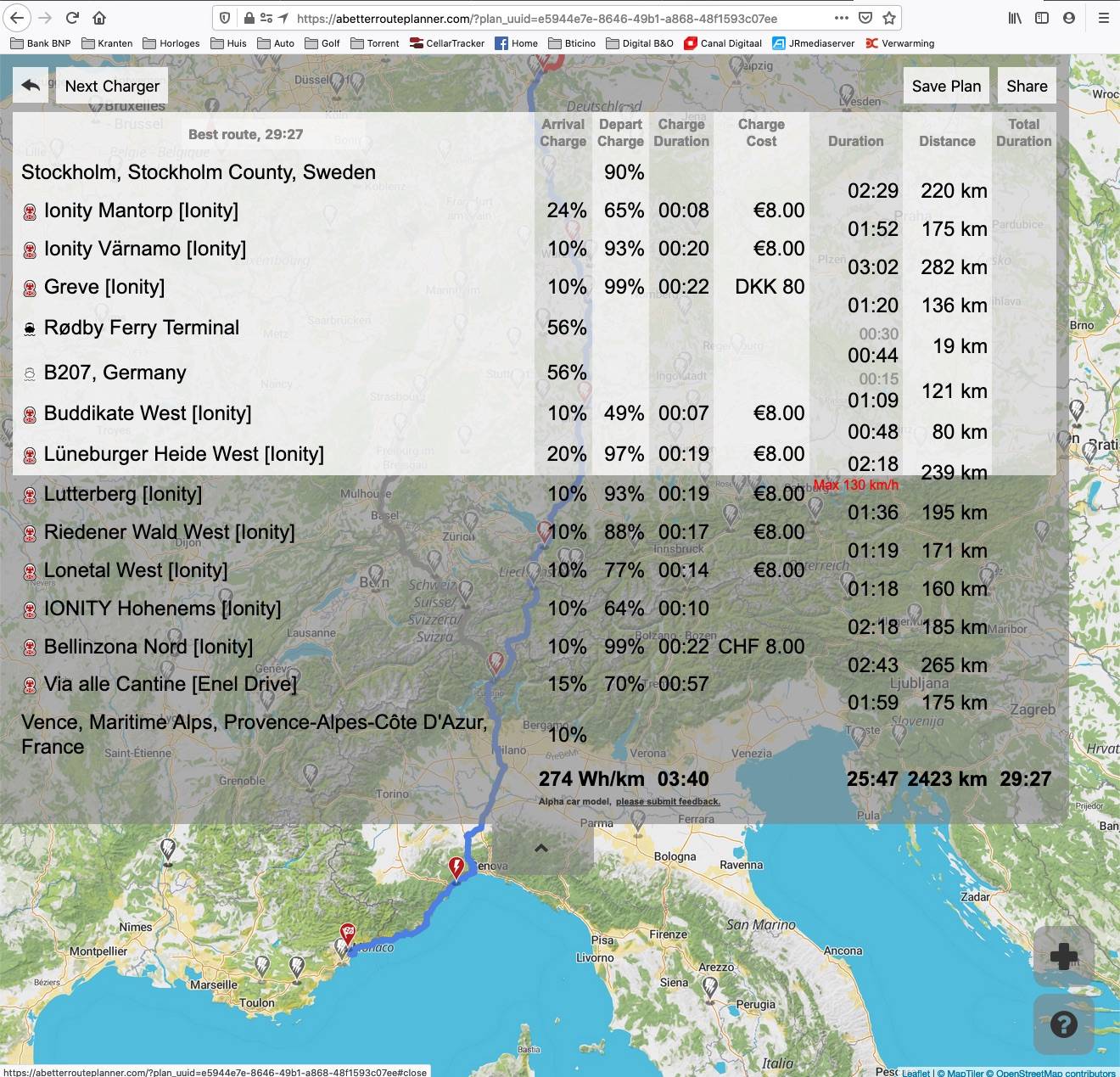

I use the https://abetterrouteplanner.com/ website to tryout routes. In this planner I put in a Taycan Turbo as car to be used. This planner uses as much as possible the Ionity 800V chargers. See enclosed screen shot of your route, "already" in 29 hours in Vence. I really wonder which of these planners reflects the real world.
Porsche Taycan Route Planning on Porsche website Schermafbeelding 2019-11-12 om 13.09.51

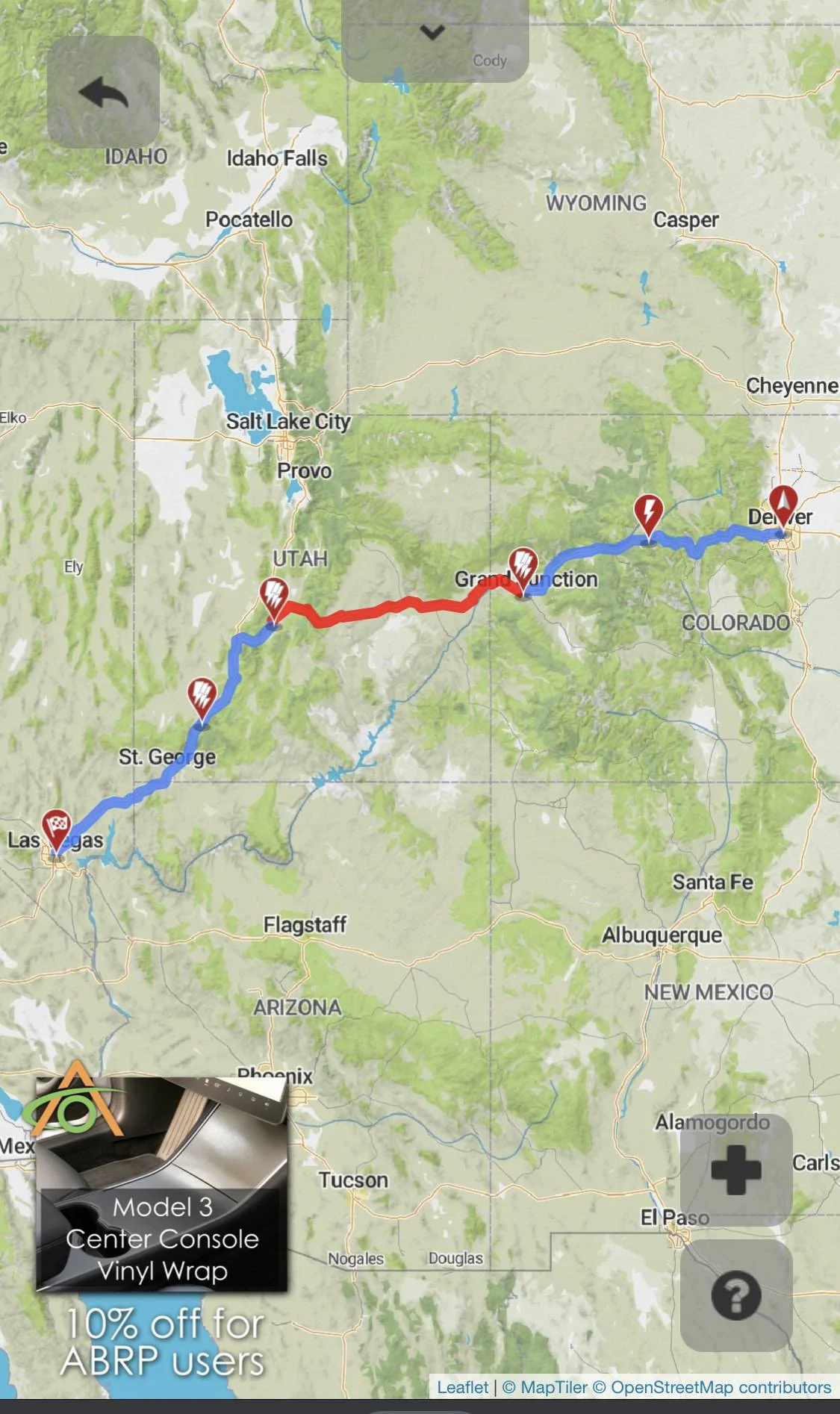

Thanks for the suggestion, but here is what it said ( note the red area is the 235 mile stretch that the Taycan won’t do and there are no alternative suggestions. Guess for now I’m stuck at the western edge of Colorado.

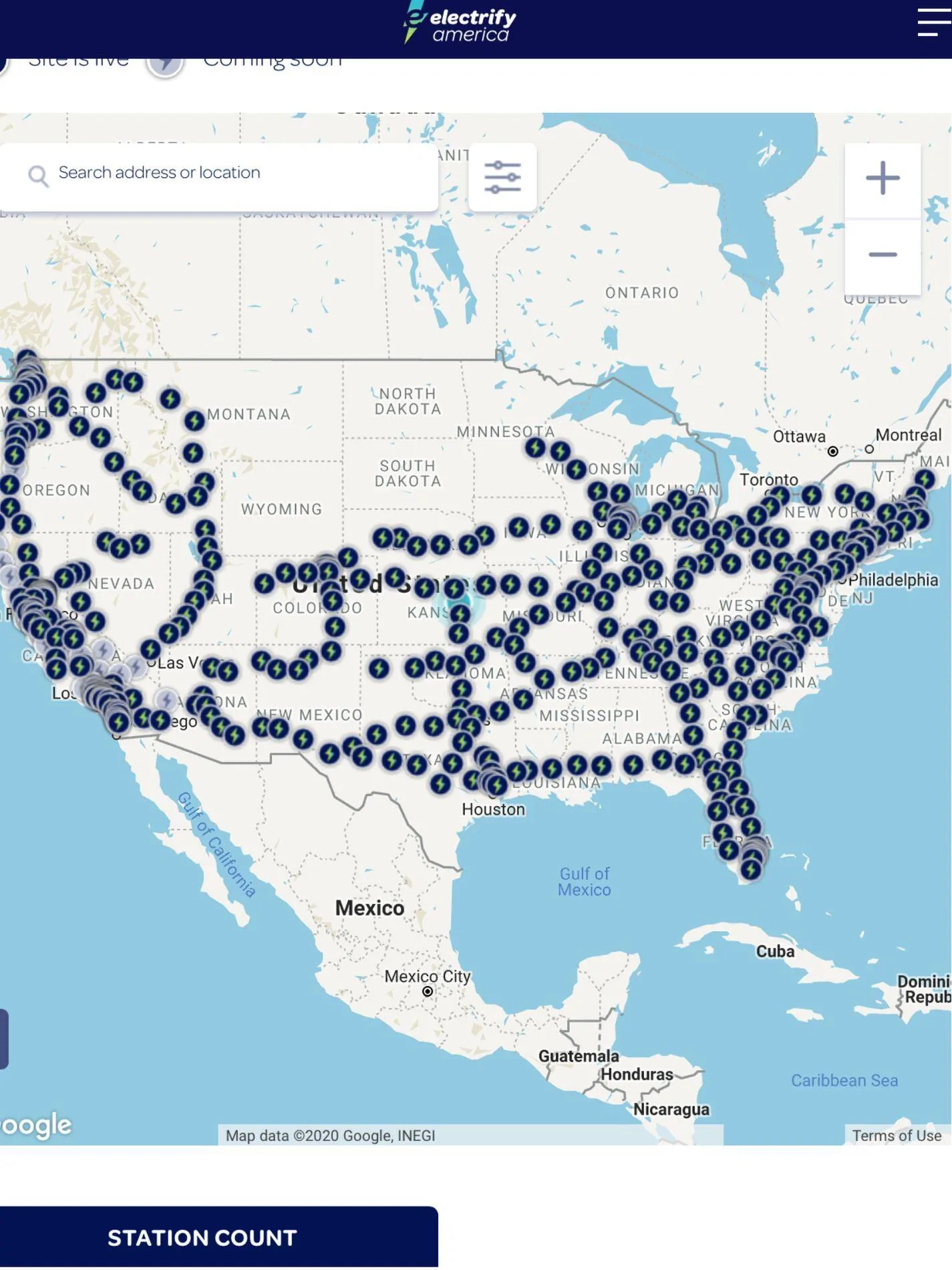

Check chargepoint, evgo and plugshare - they may have listed options not in abetterrouteplanner

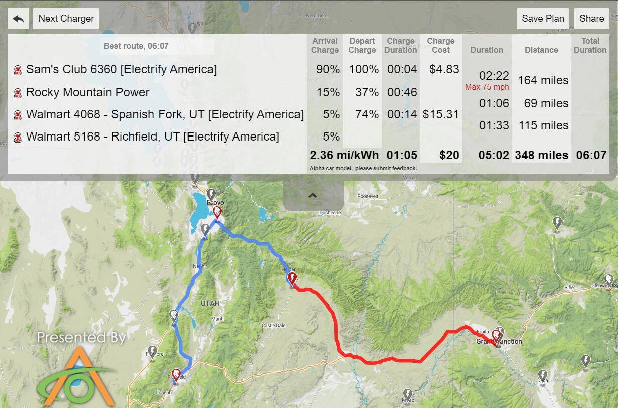

Ah, guess I mis-understood how the route planner color indicator means. The route I was thinking was
Porsche Taycan Route Planning on Porsche website upload_2020-1-13_22-48-32
the orange color just means you have to stay bellow a certain speed to make it..... in this case 75mph........ so on the other route there is probably a similar restriction. maybe shorter time depending on the two scales. :)
