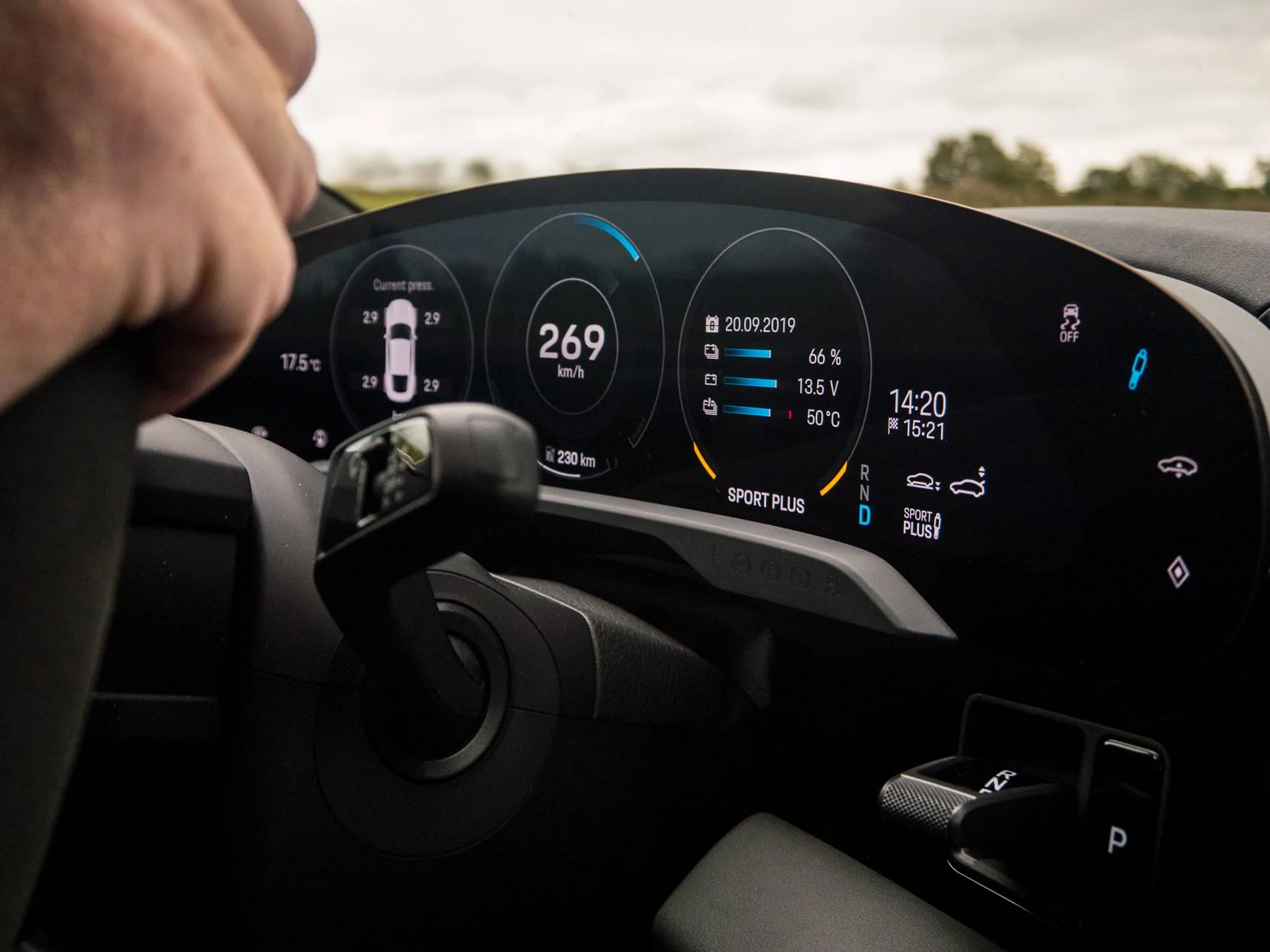

Is the active air suspension easily adjusted via a hard control on the wheel on the Panamera or Cayenne?
Yes in my Cayenne it was a physical toggle switch on the console.
On the Taycan it is a touch button in the form of a shock icon on the right side of the curved 16" main driver display.
You can see it clearly in this pic:
Porsche Taycan Speed bump ?? Porsche-Taycan-19
Without Sport Chrono you have Normal, Range and Sport modes and must use the touch screen to change modes.
The Sport Chrono option adds Sport Plus and Individual modes and the dial on the steering wheel to quickly change modes.
So to solve your problem you could program your Individual mode to be the highest ride height and be your "speed bump clearing" mode with a quick flick of the dial on the steering wheel if you opt for the Sport Chrono package.
