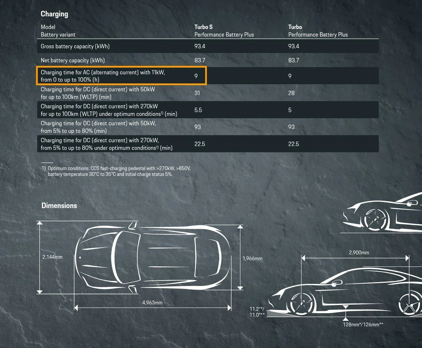

Just wondering cuz most public chargers here are AC 3-phase (11/22kW).
I was going to install a 3-phase (I already have a single-phase 3,7kW) but I assume the Taycan isn't.
Just AC single-phase and DC quick-charge...
Right?

it should be possible to charge with 3 phases with 11 and 22 kW PAG_J1 answered on https://www.taycanforum.com/threads/taycan-q-a.321/ post #13
at least 11 kW is stated in the Taycan Brochure;), and there is in the configurator the option for 150 so maybe 22 kW AC is available
Porsche Taycan Taycan not suitable for AC 3-phase charging? tempFileForShare_20190915-162123
Porsche Taycan Taycan not suitable for AC 3-phase charging? 15-09-2019 16-25-54
Thank you so much!
Didn't notice it.
I thought it was wierd...
Thx again!
