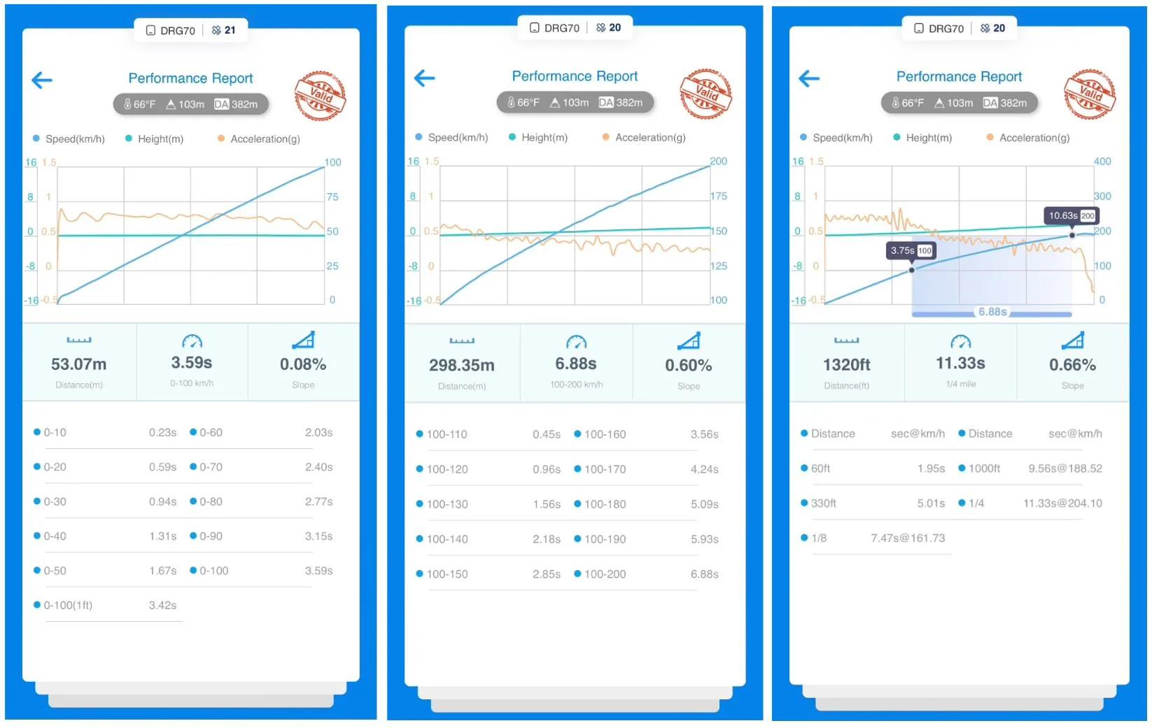

Fellow Taycan owners, I recently did the ECU upgrade on my '23 etron GT and wanted to give my unbiased review and opinions about the experience. Since the etron GT's equivalent is the Taycan 4S, I figured I'd share my experience with you all.

Numbers (after upgrade):
Battery SoC: > 91%
0-100 km/h: 3.59s
100 - 200 km/h: 6.88s
1/4mile: 11.33 @ 204.10km/h (126.82mph)
Porsche Taycan Review & Results: ECU Performance Upgrade - Stage 1 from Redshift Performance RLe55-ecu-upgrade-times
I have no baseline numbers to compare too. That data was on a guest dragy account and has been lost

On the 100-200km, an upgraded Taycan 4s will be slightly faster an a stock Turbo S which is 7.1sec compared to 6.88sec

Etron GT is a 4s. I said the 100-200km is faster than a Turbo S, not the 0-60 or 1/4mile time.
Look at the Dragy data
