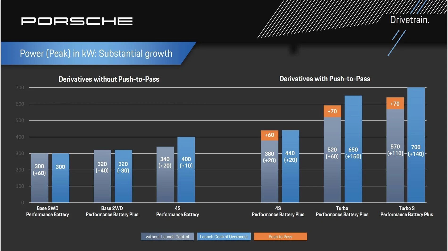

This was published at launch of the J1 II but before Turbo GT.
I would like to confirm the following Turbo GT numbers in peak kW to complete this graph.
Turbo GT w/o Launch Control: 580kW
Turbo GT Push to Pass 10 sec: +120kW -> 700kW
Turbo GT with Launch Control: 760kW
Turbo GT with Launch Control 2 sec: 815kW*
*Equipped with a more powerful pulse inverter, both cars have 580 kW. With Launch Control that increases to up to 760 kW of overboost power or up to 815 kW for two seconds according to the peak power measurement method.
I'm curious if there is more power in the rear motor of the Turbo S or is that extra HP in the Turbo GT all the power from its own rear motor?
Does the 900amp inverter only allow for more use of Push to Pass? 4 second cool down vs 10 seconds for the other Taycan variants and the increased top speed?
It would be nice to get specifics on the hardware

I only wanted to see the difference between Turbo S and Turbo GT. The GT rear motor and inverter are different.
