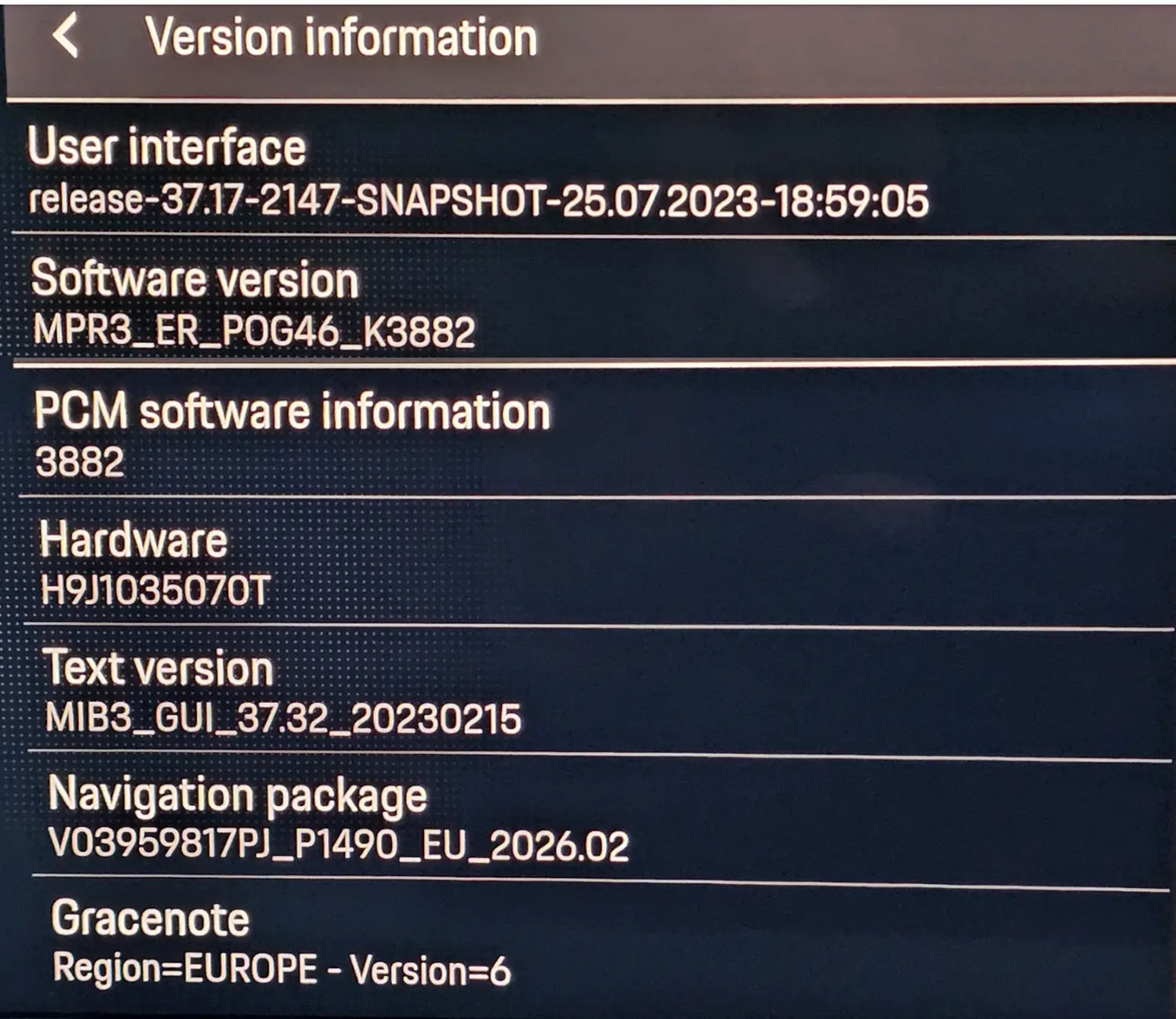

  1. 3882 - what 90% of taycans are running

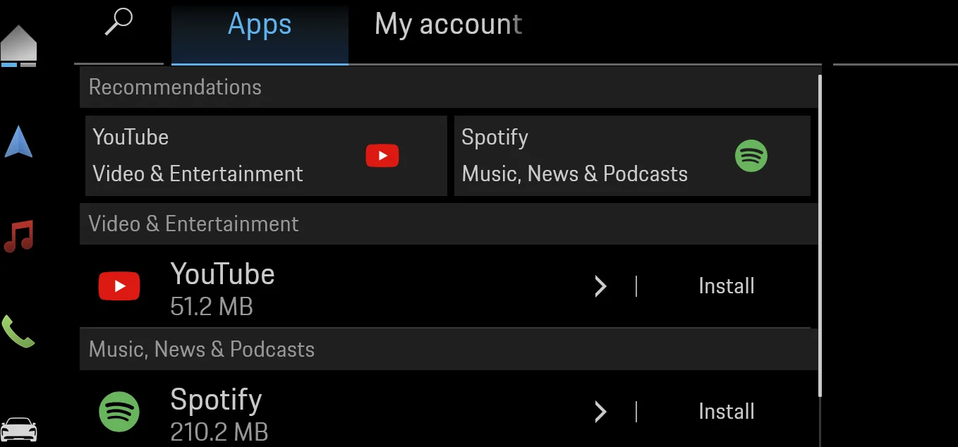

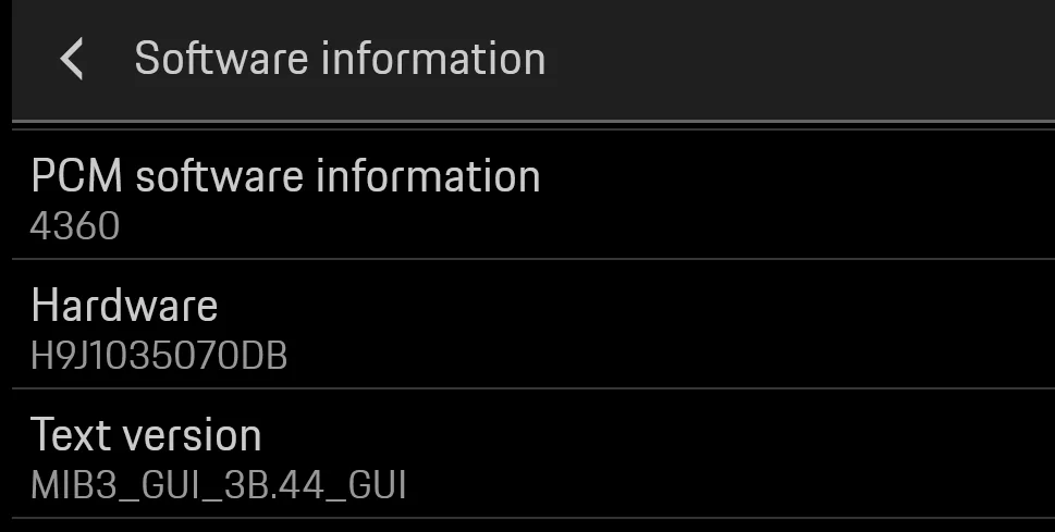

  6. 4360 which shipped with most MY25:
    • 4360 without app center - video app containing youtube instead.
    • 4360 with app center

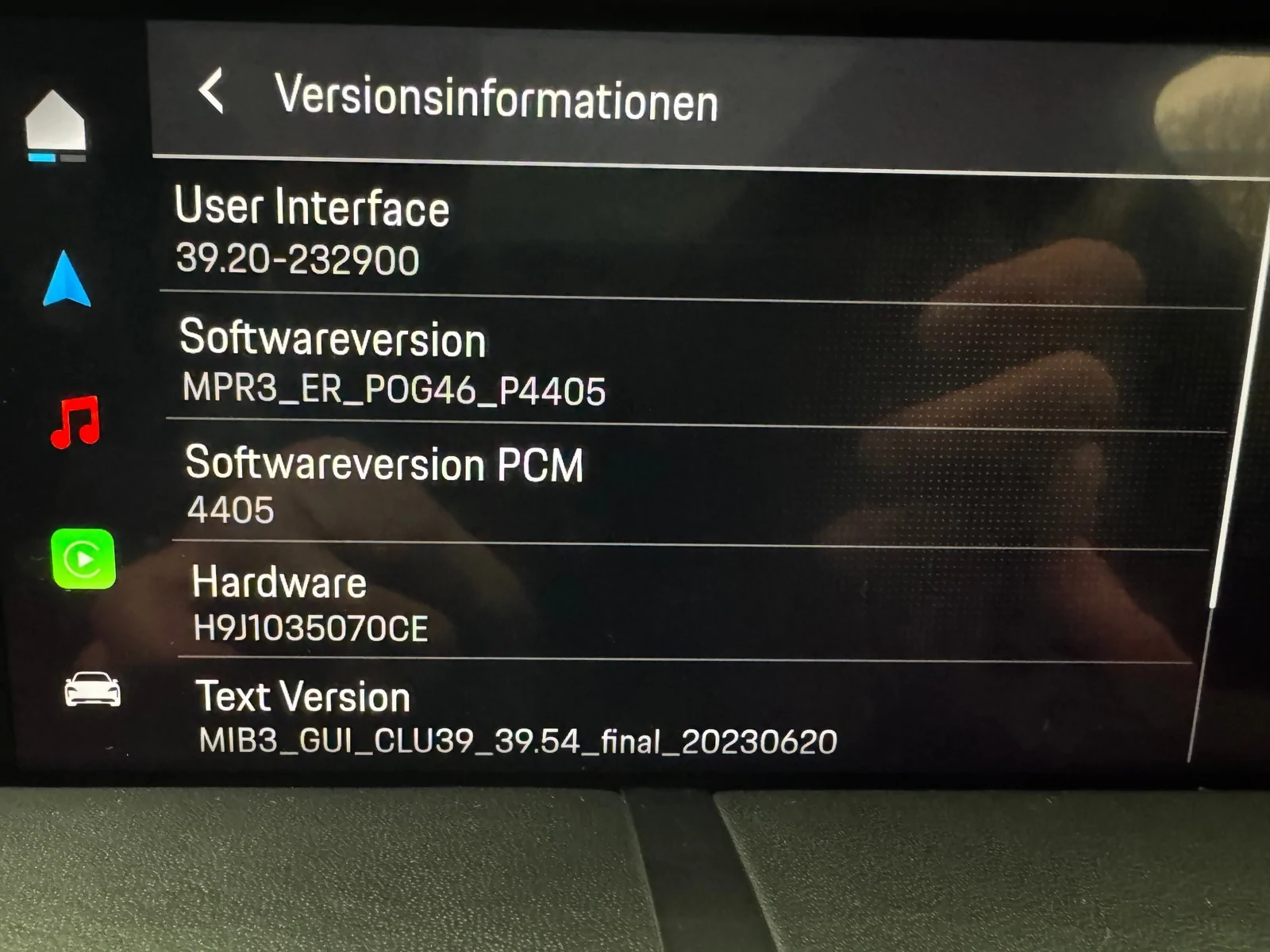

  7. 4405 which seems to be the equivalent of 3885, aka a stability improvment patch
    • 4405 with app center
    • 4405 without app center - video app containing youtube and others instead

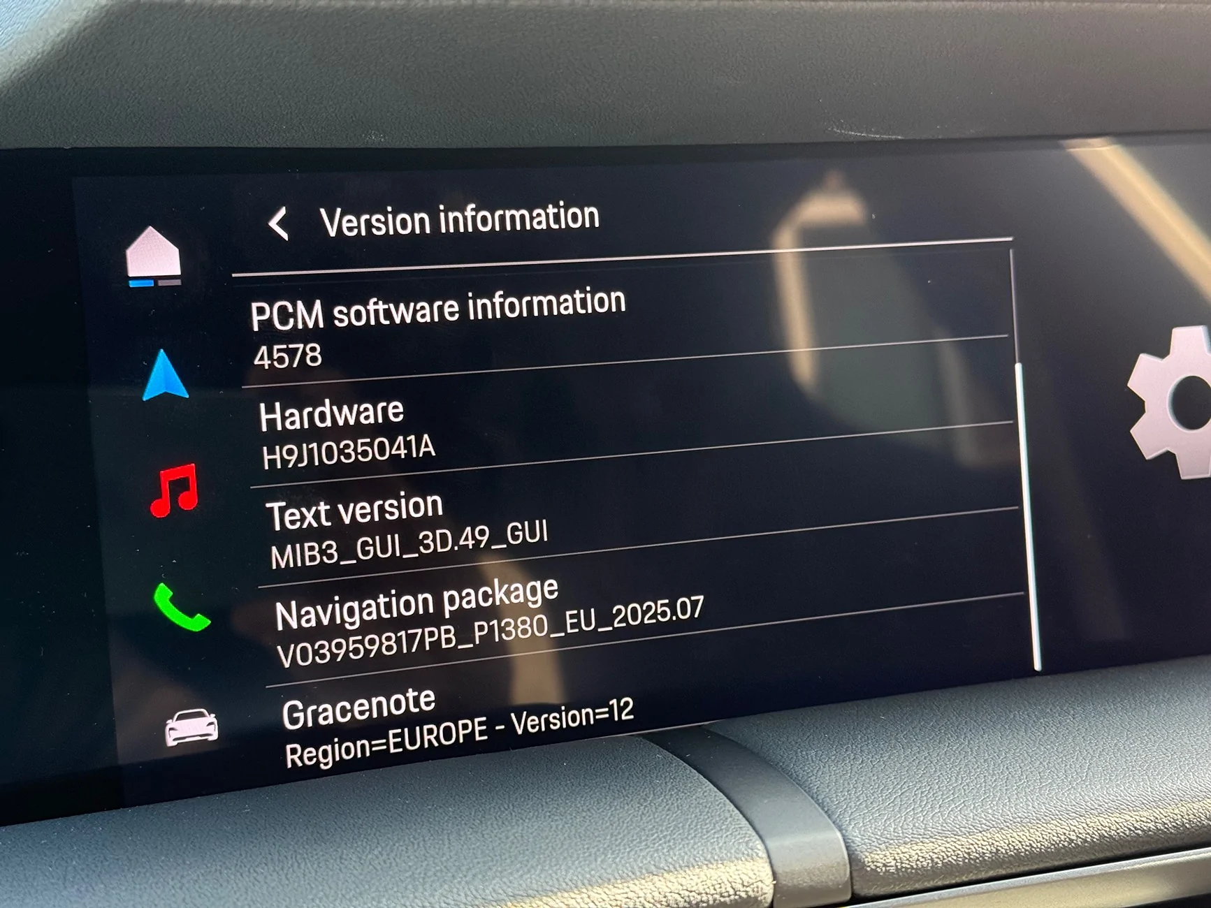

  8. 4578 which shipped with MY26 - all cars running this version have the app center
    Porsche Taycan PCM version tracking (and their differences) 1770670762470-1q
    Porsche Taycan PCM version tracking (and their differences) 1770670788569-69

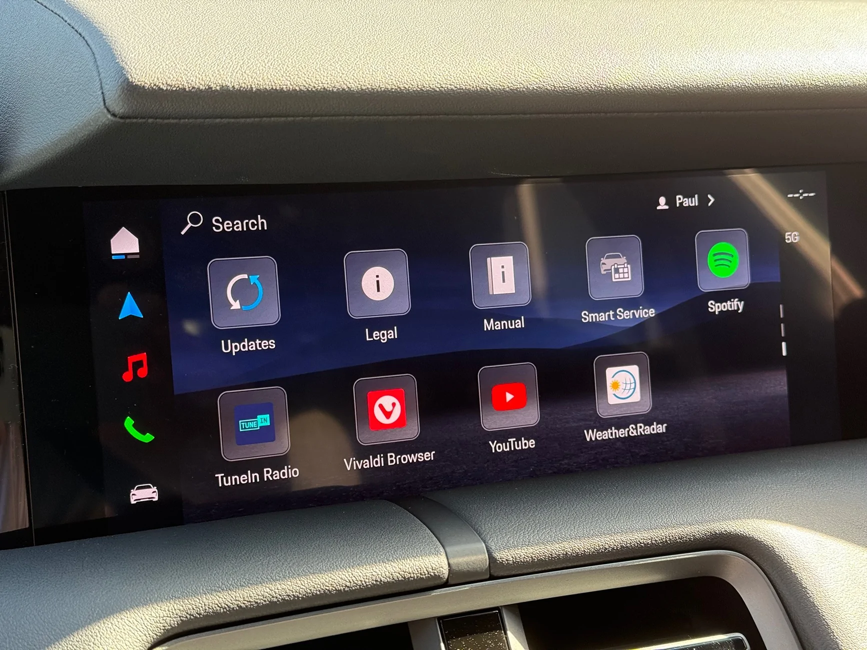

I don't think the 4360 has the same app center as MY26. I see only a couple apps there (YouTube/Spotify).
MY26 has a lot of apps. I could take some photos if you want?
I have one in my parking right now, replacement from porsche, MY25, 9J1 035 070 DB hardware id; PCM 4360.
It has app center with: vivaldi, youtube, spotify, apple music and a game. But from what the dealer told me, it's market dependent what's in the app store.
Not even 1 month ago, I had another MY25, also replacement from porsche, which had 9J1 035 070 CE with PCM 4360, no app center, just a VIDEO app which had youtube and some tv app.

November 2020 J1.1 here.
Would Porsche apply any of the updates if you asked?
Porsche Taycan PCM version tracking (and their differences) 1770739429661-in
3885 is only for customers who complain about connectivity or rebooting PCM. I have a feeling you suddenly have connectivity issues. You should call OPC tomorrow.
