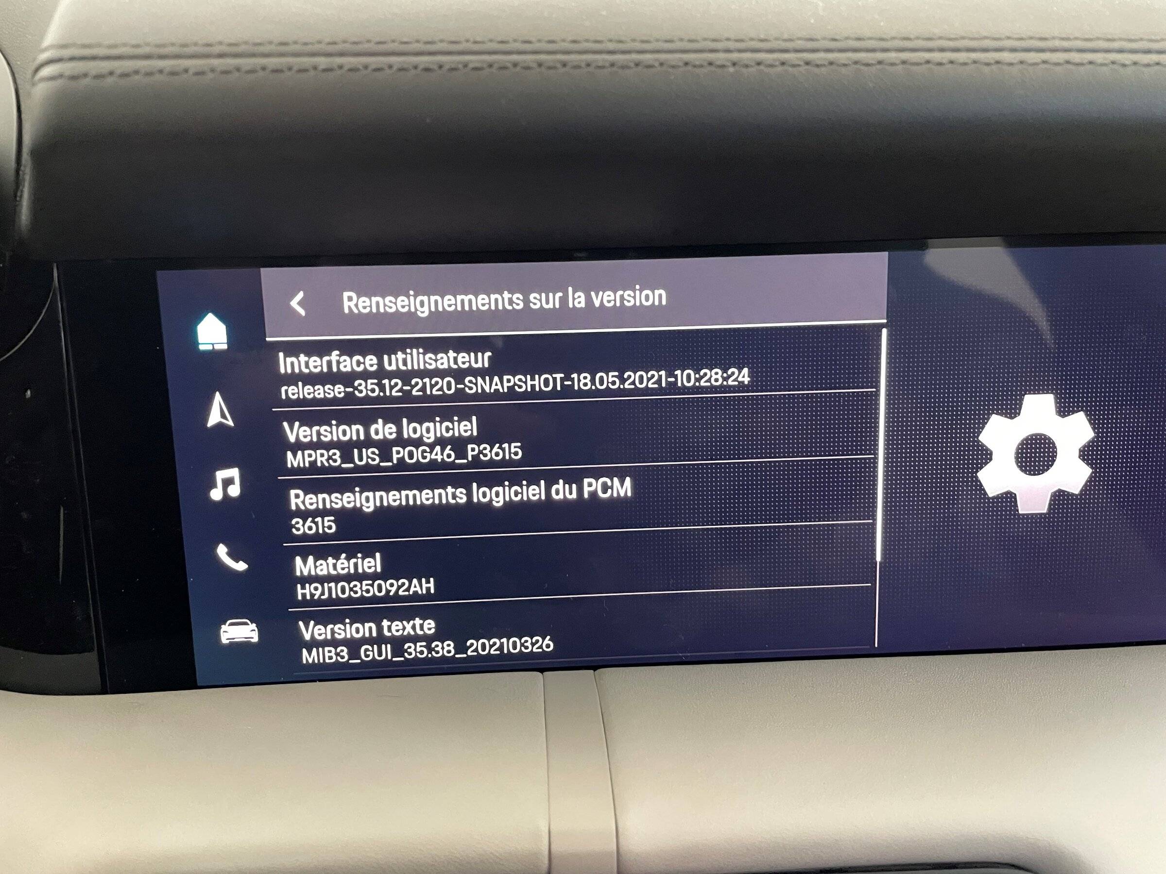

I have a CT 2022 4S and I checked though the menu my version of the PCM .... however as per the picture, I cannot figure out which version is truly installed on the car. Does anyone know how to translate those version numbers into something meaning better?

Thanks. We don't know with those numbers if we are version 5.x or 6.0 or whatever. Thanks again
Every Taycan since day 1 is PCM 6. PCM 6 is the platform.
2020, 2021 and early 2022 have HJ1035 series "central computer" hardware. 2022 cars being manufactured now have hardware with the prefix "PAD".
Fully updated 2020's have software version 3397, 2021s have software version 3615. It is unknown what version the next update, that includes Spotify, is. As far as we know now, that updated software version will only be made available on cars that have the PAD hardware (so not even all 2022s). That said, Porsche is "looking into a retrofit" per their (terrible) public comms. That's all we know so far. There is a gigantic 28 page thread on it on this forum.

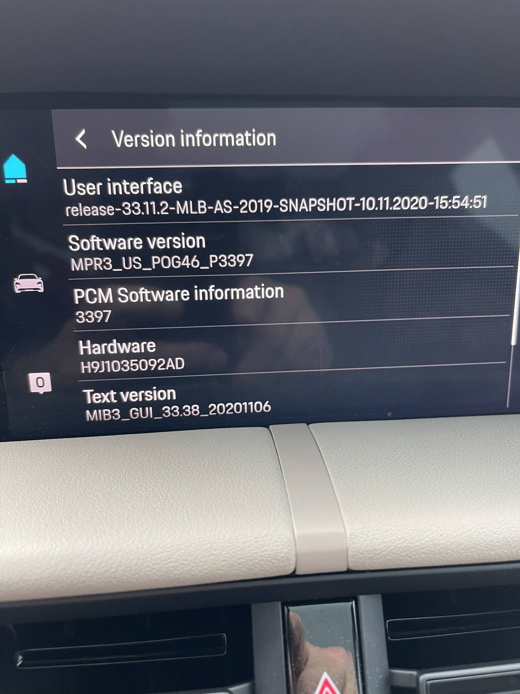

Not sure if all 2021 have software 3615. Here is my 2021 Taycan RWD (Build date 7/2021) and my version is 3397. the Car says it is up-to-date. I get Spotify via CarPlay.

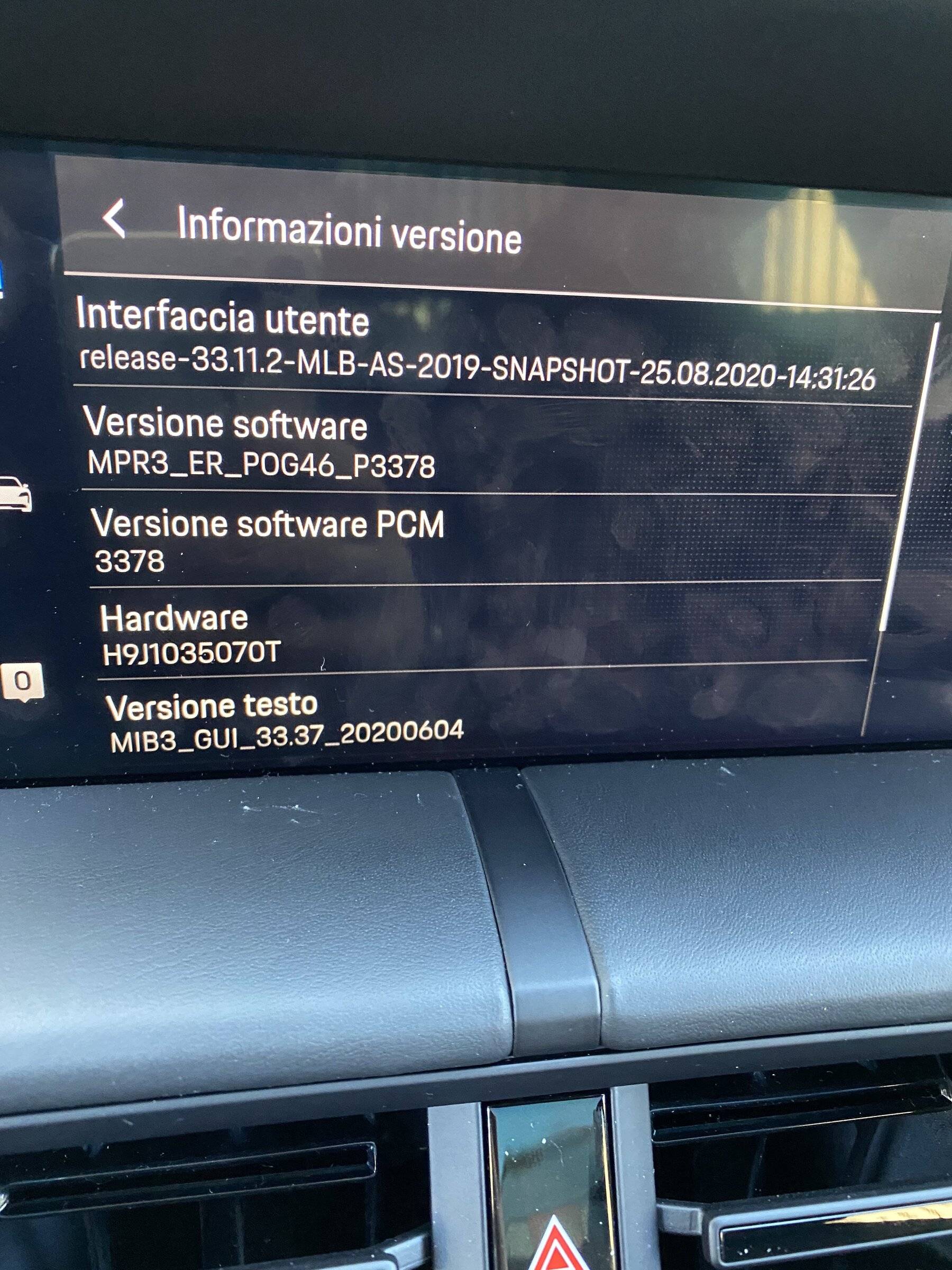

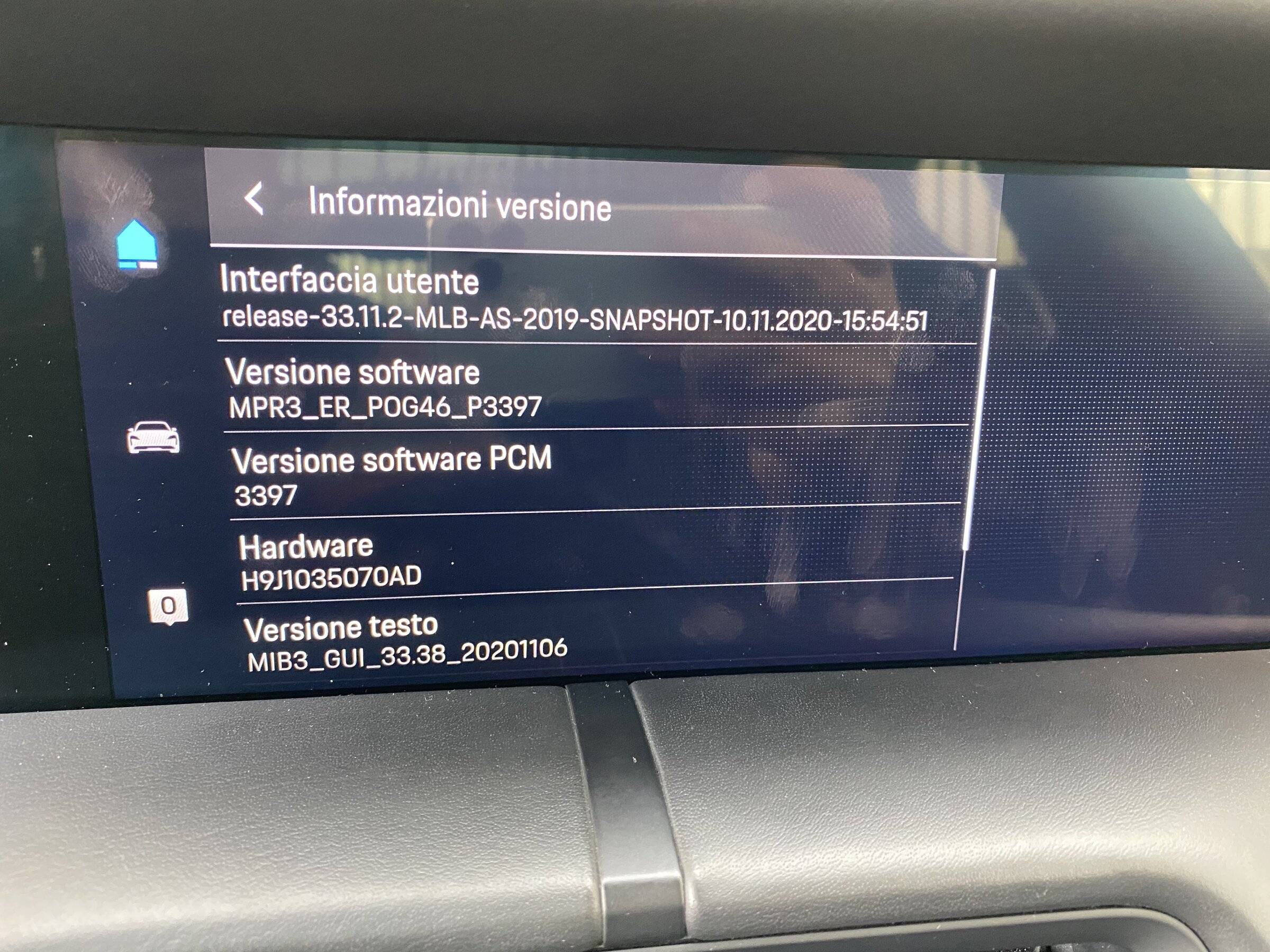

This is my version (before update and aftrer update and replacing PCM).

Your software has the same version as mine after your PCM replacement, but the hardware number is different (070 vs 092)
