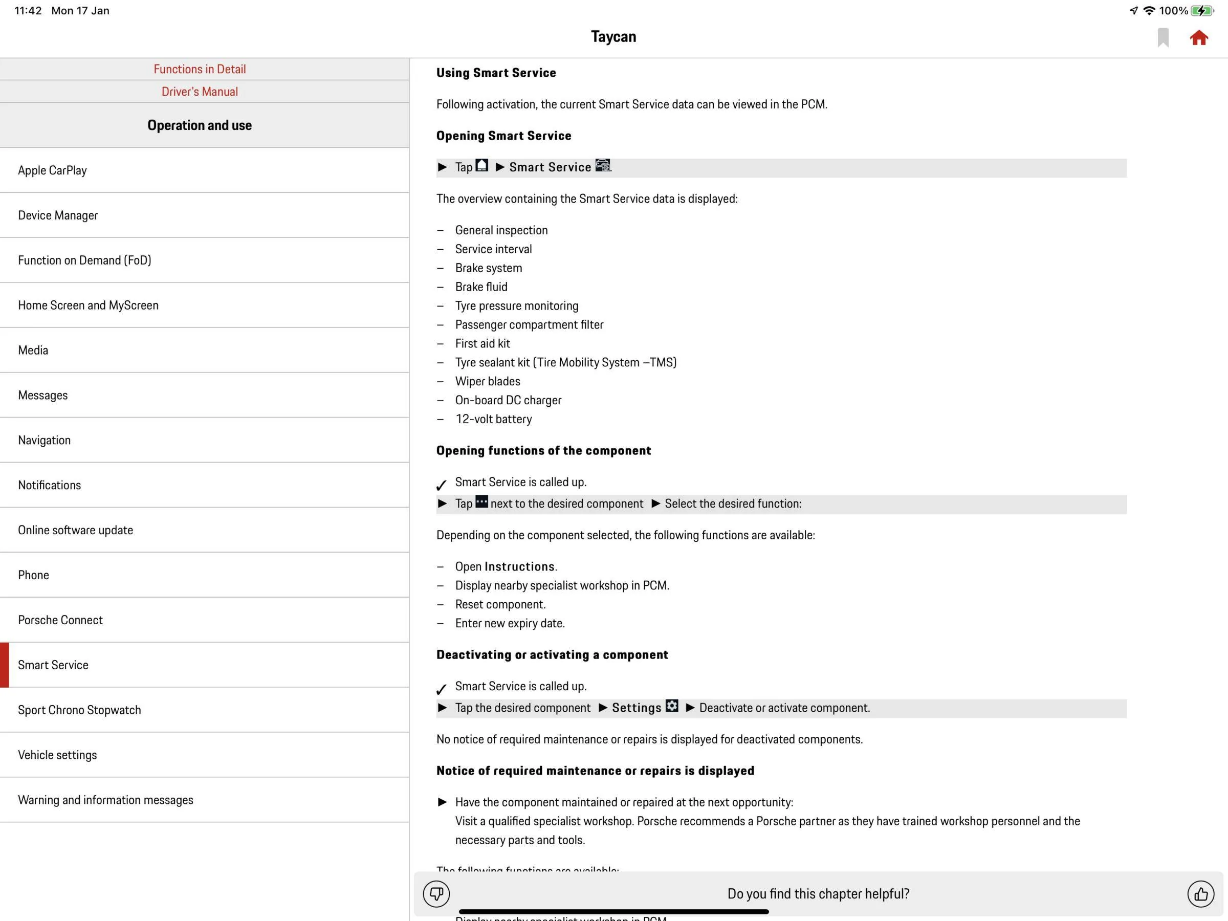

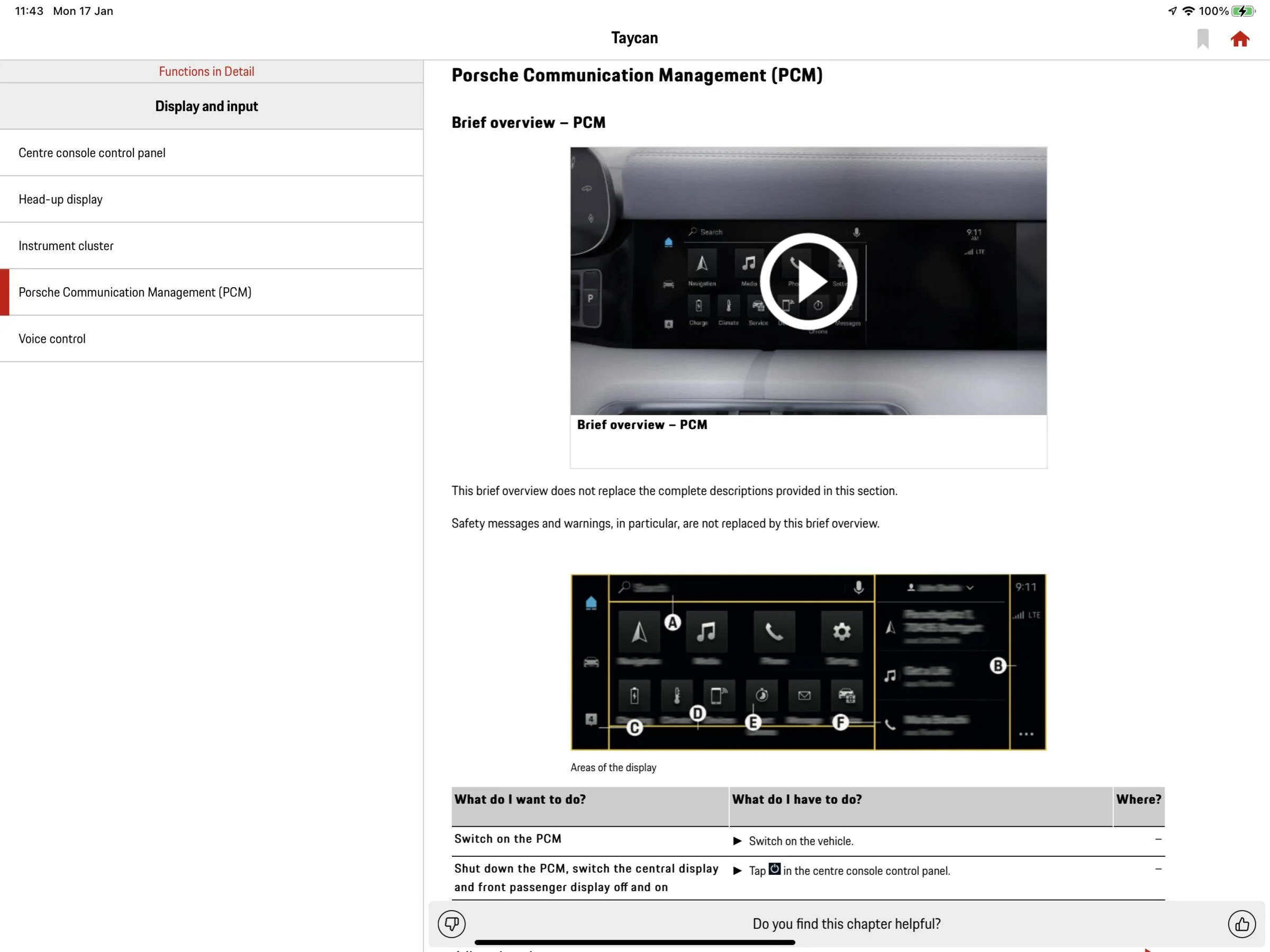

It is a large icon on the main PCM home screen labelled "Smart Service" (F) below. I would share a screen shot but as the simulator is broken I can't so I've gone to the Porsche Good to Know App (download if you don't have it):
Porsche Taycan App says service due 20220117_114332000_iOS
Porsche Taycan App says service due 20220117_114254000_iOS
You'll need to go into the various menus / options to reference the elements I mentioned BUT only do this is the service notification relates to the items I mentioned. If there is a recall then you need to use the recall checker UK - https://recall.porsche.com/prod/pag/vinrecalllookup_V3.nsf/VIN?ReadForm&c=usa - may be the same link in your region - and enter your VIN. Failing that, contact the dealer.
