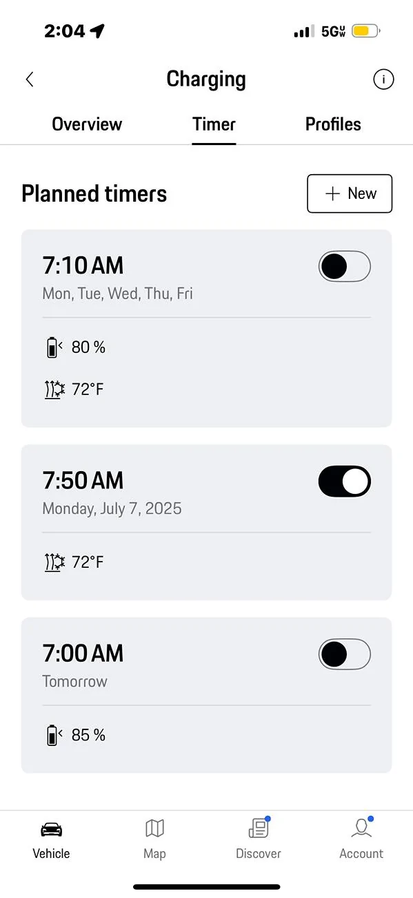

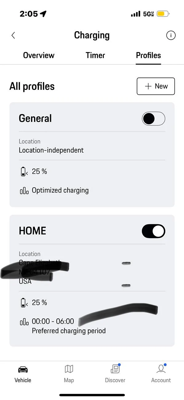

I have profile set to minimum 25%
charge 12-6 Am although time of charge not an issue for my electric supplier
Timer set to precondition A/C for my next use, next Monday, charge turned off and precondition turned on
Checked the car with app 36 hours later and it shows 88% charge, 12 hours later 97% charged
I have used this timer and profile previously without it charging the car.
Any thoughts why this setting resulted in the car charging?
Thanks

Here are the settings
Goal is: started with 70% charge
Left home for a few days, dealer stated if you don’t drive the car for a week plug it in to maintain the 12v battery (is that statement correct)
So I plugged it in with above setting to maintain the 12v and as a bonus precondition the car for my next drive
Are my settings consistent with my needs and is anything needed for the 12 v if the car is idle for a few dsys
Thanks

Let's start with Profile.
Profile with Preferred interval - why are you complicating your setup if that does not matter to you.
Profile with Home address - why are you complicating your setup if this is your only Home where the default Location independent profile is better.
The car will charge to 25% right away regardless of settings (Timer, Profiles, Direct, whatever) including total disregard for your Preferred interval. This means if your car is at <25% when you plug in, you cannot make the car wait until your Preferred interval to start charging.
Then the car looks for the next command in this order after it reached 25% emergency minimum that you cannot control with ANY settings:
1. Direct - obviously will charge to 100% as fast as possible.
2. Profile - the car looks at the % setting and charges to that level as soon as possible, recommended to be set at 85% then STOPs, and looks for the next instruction, which is the Timer. It will honor Preferred interval after it is at 25% minimum.
3. Timer - the car looks at the % level and end time and calculates backwards how many hours it needs to get there given a quick sip of the current Amps. For example, if it only needs 3 hours and end time is 6 am, it will start charging at 3am. Then STOPs and looks for the next instruction, which is another Timer event (same timer but recurring) or another Timer (dummy set on the far future). If it does not find one or another, like you have July 7 one-time Timer, it will RESTART and will charge to 100% as soon as possible.
Therefore, you cannot have a one-time Timer setup - must be Recurring or you can set a Dummy one far far in the future for Step #3 above to STOP at the level set.
Therefore, if I understand your case correctly, this should be your setup.
Direct = OFF
Profiles = OFF
Timer1 = July 7 with say 85% and Pre-Condition
Timer2 = December 31 with 85% (dummy)

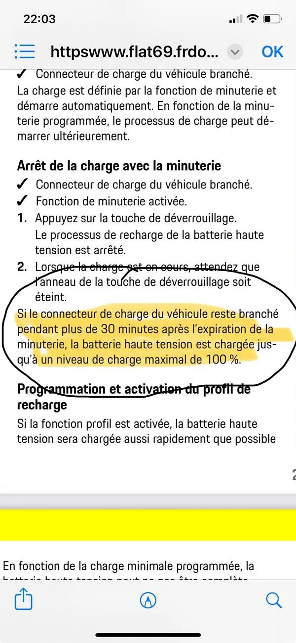

Perhaps Direct Charging in your PCM has been selected? (That overrides all settings and starts charging immediately; comes in handy if travelling and using a Level 2 charger)(if not selected when using L2 chargers, charging may be delayed depending on your settings)
If you let your car plugged more than 30 minutes after the end of the time set up in your timer then charging will start again untill you stop it manually or raising 100% SOC
Just look at your car documentation
Please do not get involved if you do not read my previous posts and you do not know what you are talking about and confusing our members on this thread. This is not what the OP and other members asked for. We are not here to point to manuals.
Your statement is only true if a one time Timer is setup, otherwise it is false, so it is not helpful, as it does not provide a solution like my posts above.
