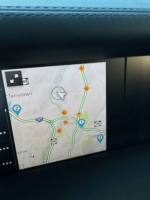

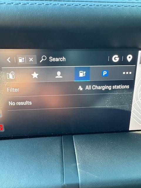

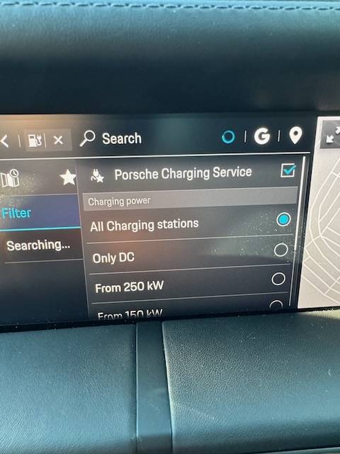

Hi.
Has there been a recent update to the navigation EV charger filtering? I was traveling yesterday and chose "Porsche Charging Service" under the navigation EV charger filter options and search came back with no results (see attached). I used to be able to get the electrify america chargers using that option.
Also, I noticed that if I unselect the "Porsche Charging Service" option, I don't get the number of available chargers at stations any more on the map, only an arrow with the location.
My iPhone Porsche app still displays all electrify america chargers and their availability, so this seems to be an issue with the car navigation system only.
Thanks in advance.

I have seen, fairly regularly, issues such as yours. I have found that simply waiting a while and re-trying typically fixes the issue.
That having been said, prior to travelling, I will have researched L3 chargers and have a list so I can navigate there no matter what. ....this is still not a fully mature technology, eh?

Just finished a 4,300 trip along the East coast. I’ve noticed the route planner frequently selected a non EA station although one was available within 25 miles along my planned route. I cross check EA availability with the EA app, and enter the EA charger in place of the EVGO or Francis Energy chargers the Porsche trip planner suggests. Maybe this is Porsche’s way of cutting costs for free charging?

Thank you both. Two finger reset did the trick.
I noticed the same today it was trying to send me to a 50kw Shell recharge station with EA close by. I ignored and drove to EA.
