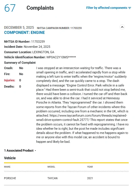

NHTSA Complaint - Taycan died after accelerating from a stop - Engine Control Error Park error - Dec. 5, 2025

Hope they recall 2020~2023 Taycans for this matter. Inverter needs to be replaced. Porsche will recommend to replace complete front motor unit even though it's only the inverters problem. It will cost 30k including parts and labor.
Do 2020+ front inverters have a defective design? I have not heard of this. Is there any more information you can provide?
