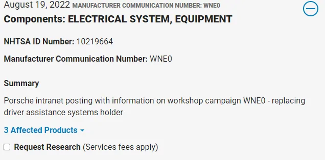

For WNE0 it appears it is for replacing driver assistance systems holder from NHTSA site:
Porsche Taycan Recall WMP1 and WNEO 1664988316820
Unfortunately no TSB posted with that item, but earlier TSB for a replace driver assistance systems holder campaign is described in this post.
