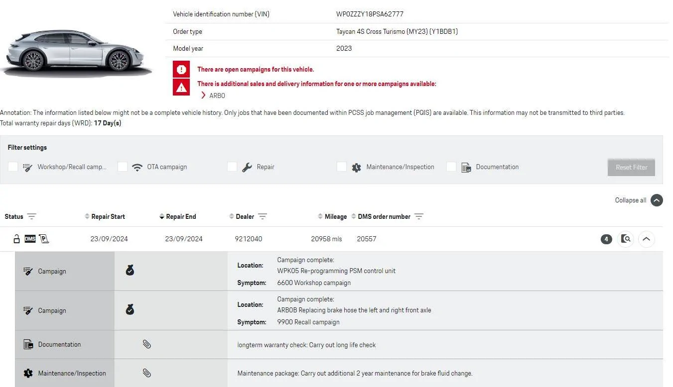

As others have said, ARB0 also includes reprogramming the PSM to change the behaviour of the transition from recuperative braking to mechanical braking see screenshot
What is WPK05 campaign? is that different from WPK0, or indeed WPKO6(which i have on my works schedule)? i have problems with my brake at v low speeds, eg <5miles/hour, but unfortunately this only occurs intermittently & therefore not 'reproducible' whenever I bring it in.
I think it is just a subset of WPK0 maybe different coding for different models or brake systems.
Should be relatively easy to reproduce if it's the same as my car. Mechanical brakes are blended in at 7 mph and the regenerative braking stops at 3 mph. When stopping slowly and barely braking (like almost coasting up to a red light) the braking action ceases right at 3 mph and you have to depress the pedal an extra inch or so to restore any braking. The trick to reproducing it was very gradual braking. Normal stop and go or highway and the brakes didn't exhibit the problem. Hope this helps because it's scary when it does happen. WPK0 will solve the problem.
Thank you both, gtm & Speuk
i'll try to show the service manager, Porsche East London - 3rd time lucky hopefully.
