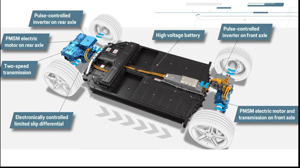

Below is a schematic of the front of the car showing the inverter and electric motors. This would go away if there was no front motor. But there are other pieces of equipment in the same area, so would require a redesign of the front end to free up space. Cheaper to not do this.

In this topic (link) you can see there is not much space left. Even without a front motor I think.
