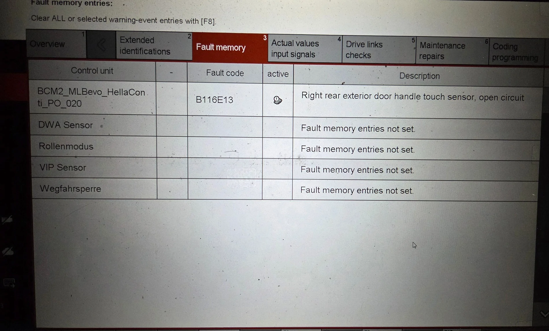

I disassembled both side markers, tail lamps, side mirrors, and all 4 door catch
After completing the PPF, all parts were reinstalled, but there are three Dtcs that do not disappear. One of them is a door catch touch sensor error... in my opinion this probably flooded during the process of spraying water on the door catch for adhere

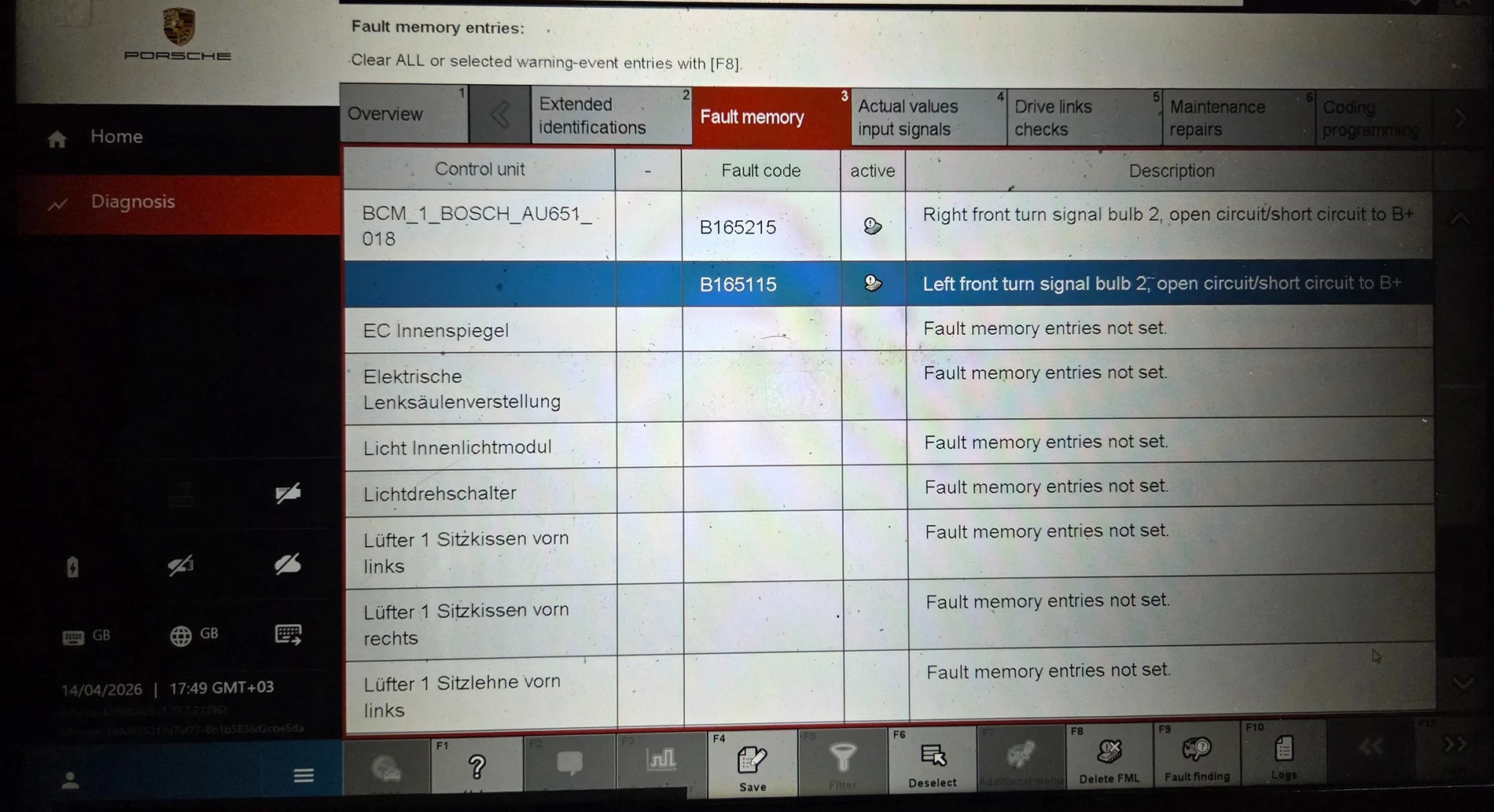

But the part I don't understand is the two DTCs that are shown in the front BCM (0X9). It says turn signal bulb 2, which means side marker in my opinion. Because if you unplug the side marker, the light conrol module (0xD6) will show dtc that there is an electrical problem with turn signal bulb 2.
The big problem is that... the instrument cluster does not display any warning lights and functions normally. When the turn signal is applied, if there is a problem with the light, it should flash very quickly, but this is not the case at all, and when you observe the light from the outside, both the headlight's 4 points and the side marker are flash well
If anyone has any ideas or experiences, please help
