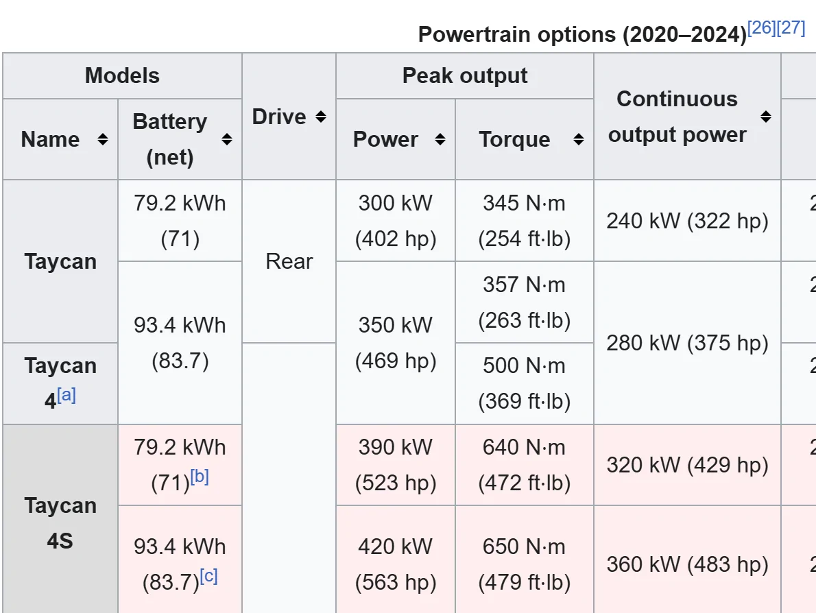

I noticed the HP numbers to be the same for both the 4 and 4s at 400hp with the 4s having a temporary boost option to 560hp.
Is this correct?

Not correct. Please see the specs below for 4 vs. 4s for Gen 1 (2020-2024).
Note that you will see specs for Performance Battery (79kWh) vs. Plus (93.4kWh).
All Taycans have Launch Control Mode (not a temporary boost, only available from a stop).
Temporary Boost (Push to Pass) introduced with 2025+ models available starting with 4S and above.
