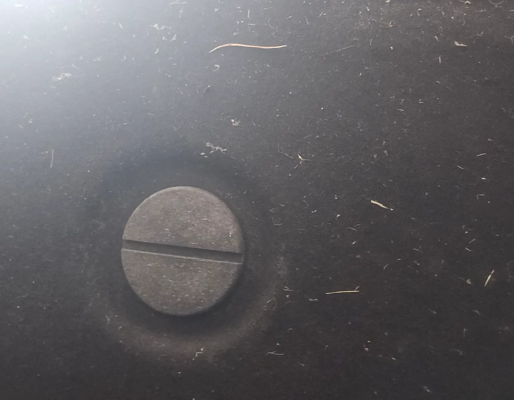

There are 9 penny head clips that are a quarter turn under the sill that are the first to remove.
I can send pictures of them later if you need

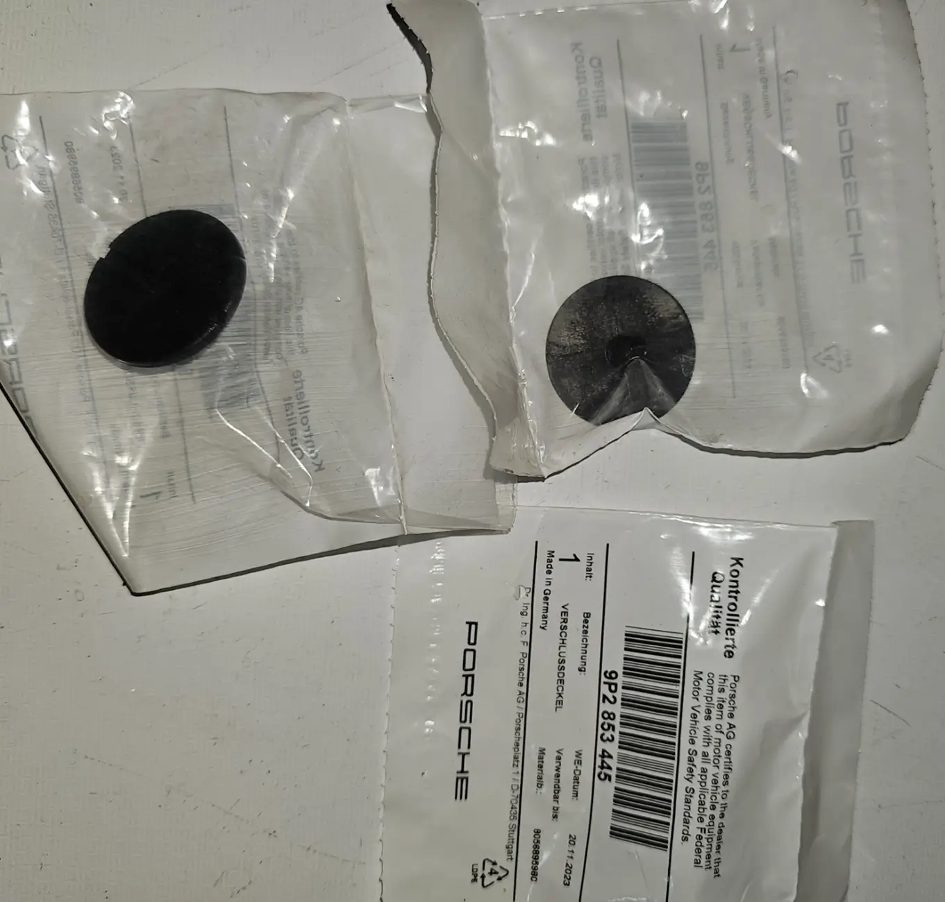

If you look under the sill, you will see a black panel that has 9 of these button head retainers.
Porsche Taycan Taycan side skirts - how to remove / uninstall? 1758304433852-67
Porsche Taycan Taycan side skirts - how to remove / uninstall? 1758304825330-s1
Once you remove them, the black panel will drop and that will expose screws that hold the sill in place.
Once you remove the screws, the sill will them pull off towards you
