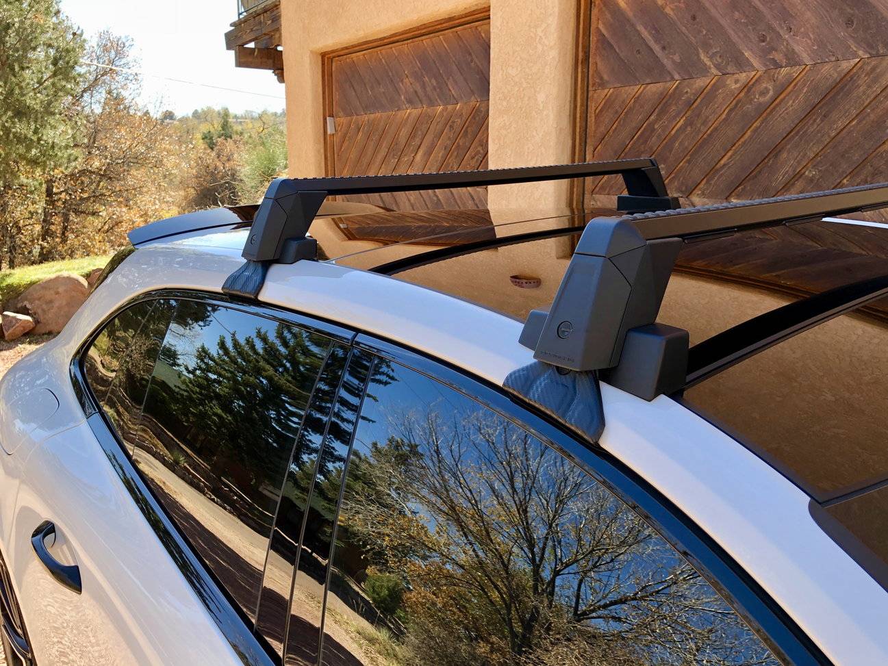

I noticed that the Taycan CT/ST and Panamera ST has a very similar body frame, especially the frame near the roof. Not surprised as both are built on the VW MSB platform. Has anyone tried to use the Thule roofbar kit that uses the clamp and pad on the frame for the Panamera ST for the Taycan CT/ST?

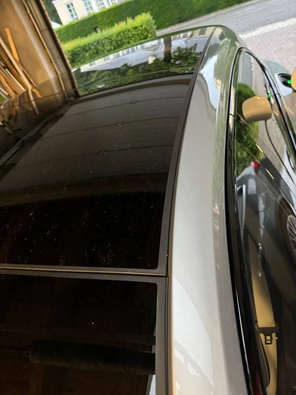

2. This is the best detailed photo I can find of the Taycan wagon with a glass roof
Porsche Taycan Thule clamp style roof bars 16958307886514530464bce_img-86609-larg
In my review of details of the Taycan door frame, the crease on the side of the frame and the roof frame that meets the glass all appears to be the same measures as the Panamera's. I've also email Thule for a confirmation whether they even tried to test the fitment.

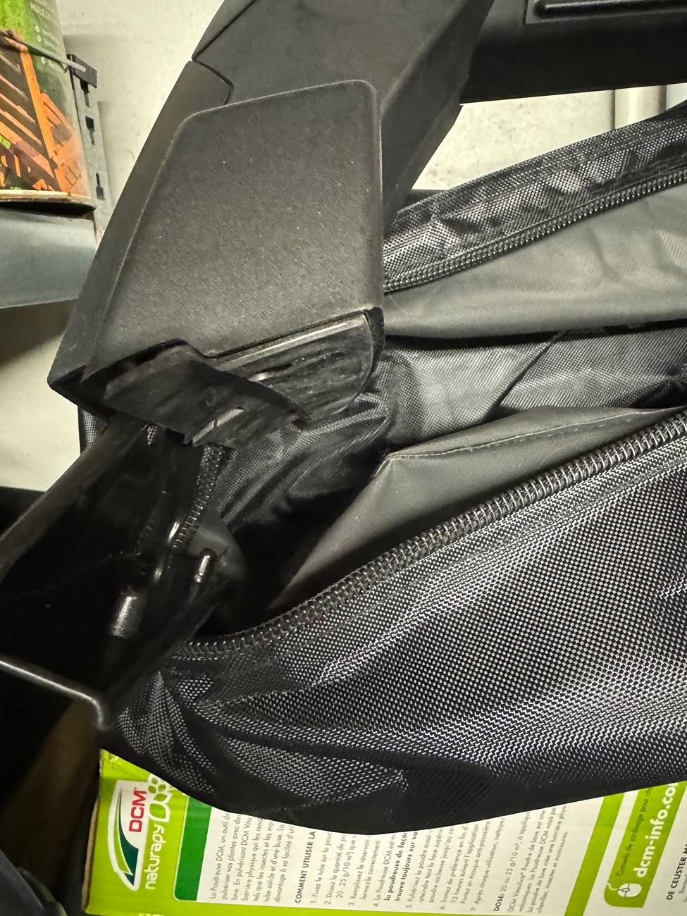

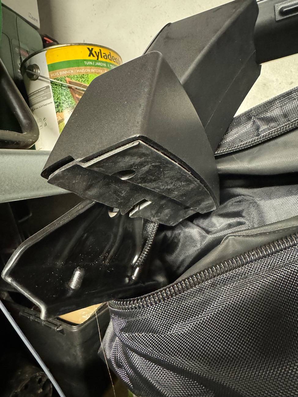

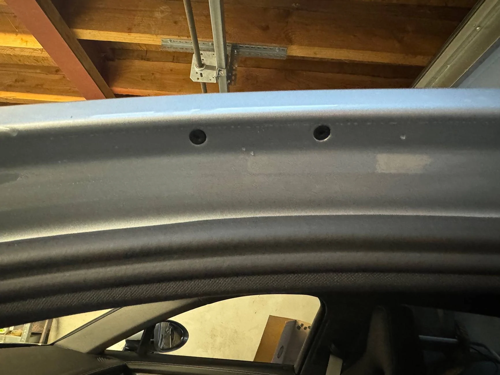

It won’t work. Just went to my Panamera to take some pictures of my car and original Porsche roof bars. The Thule ones have one pin in stead of two but they need to be positioned in the whole in the frame of the door like shown in the picture. And the shape of the roof is different.
And most important the Taycan doors are frameless. You will damage your windows when you close the door and it rolls up to close. And the rubber is on the car not on the door. You would have to partially detach the rubber to slide the clamp in which won’t work with the pin.
