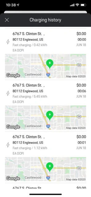

I wanted to survey the forum to see if anyone had experienced the same thing that I did today. I took my 4 day old Taycan 4s to the Electrify America location not too far from my house to experiment with the charging app. I had no issues getting mulitple sessions started, but charging would stop abruptly after a minute or two. I tried two different chargers and the same thing happened on each one. The car was only charged to 60%, so I am not sure why charging would stop. Any feedback on this issued from the group?

In your screenshot, all of the charging sessions ended with $0.00. Is it possible this is an account issue rather than a technical issue? Did you try both the EA app and the Porsche app?
@Genau: that is the next step in the investigatory process. I am going to charge at a different EA location next time and try to charge again from the Charge NA (Porsche) app. If I get the same failures, then I will try to initiate a session from my EA app and see what happens. If I still get the failure, I will try the 50kw EvGo charger at my local REI to see what happens. I am at 60% of charge now, and will let the car get down to 25% before trying to charge at an EA location.
Once I start working through these scenarios, I will identify whether it is is the Charge NA (Porsche) app, EA, or the car. Looks like part of my Saturday will be spent playing with apps, chargers, and cars!

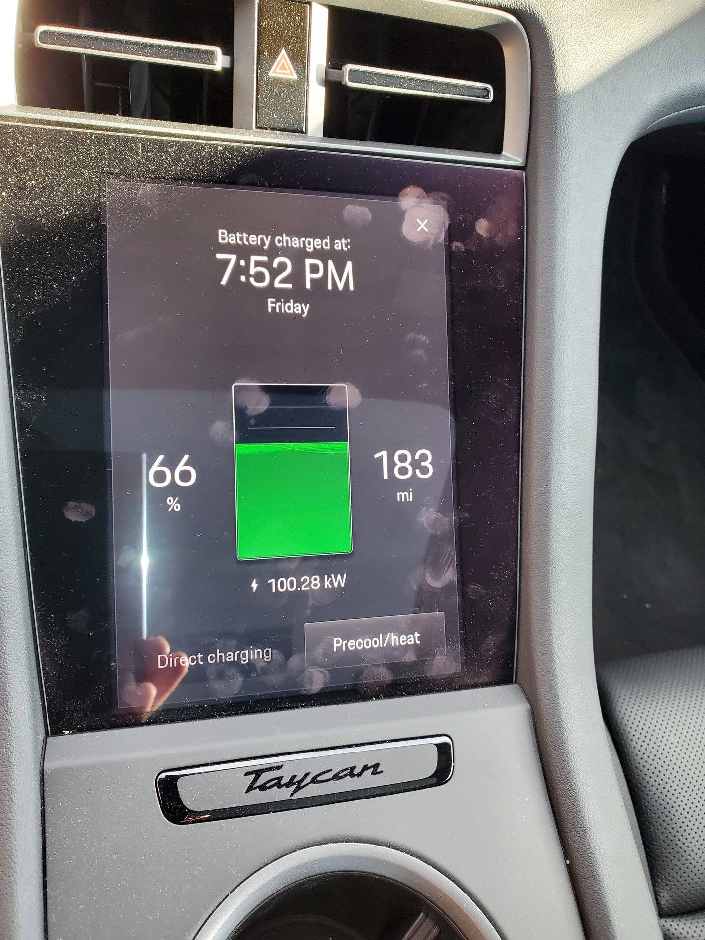

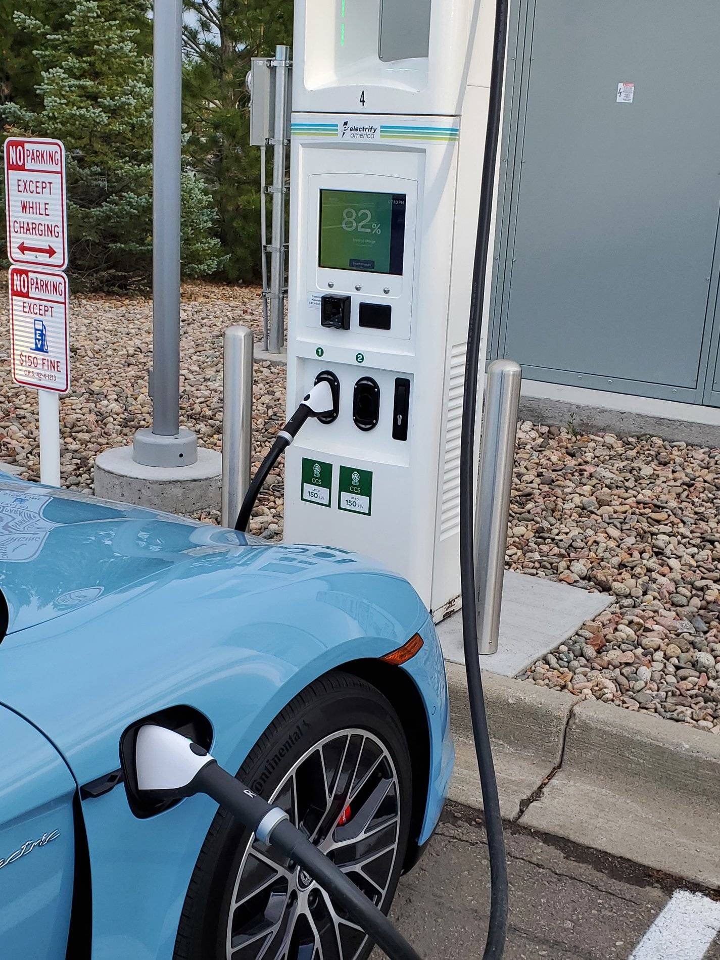

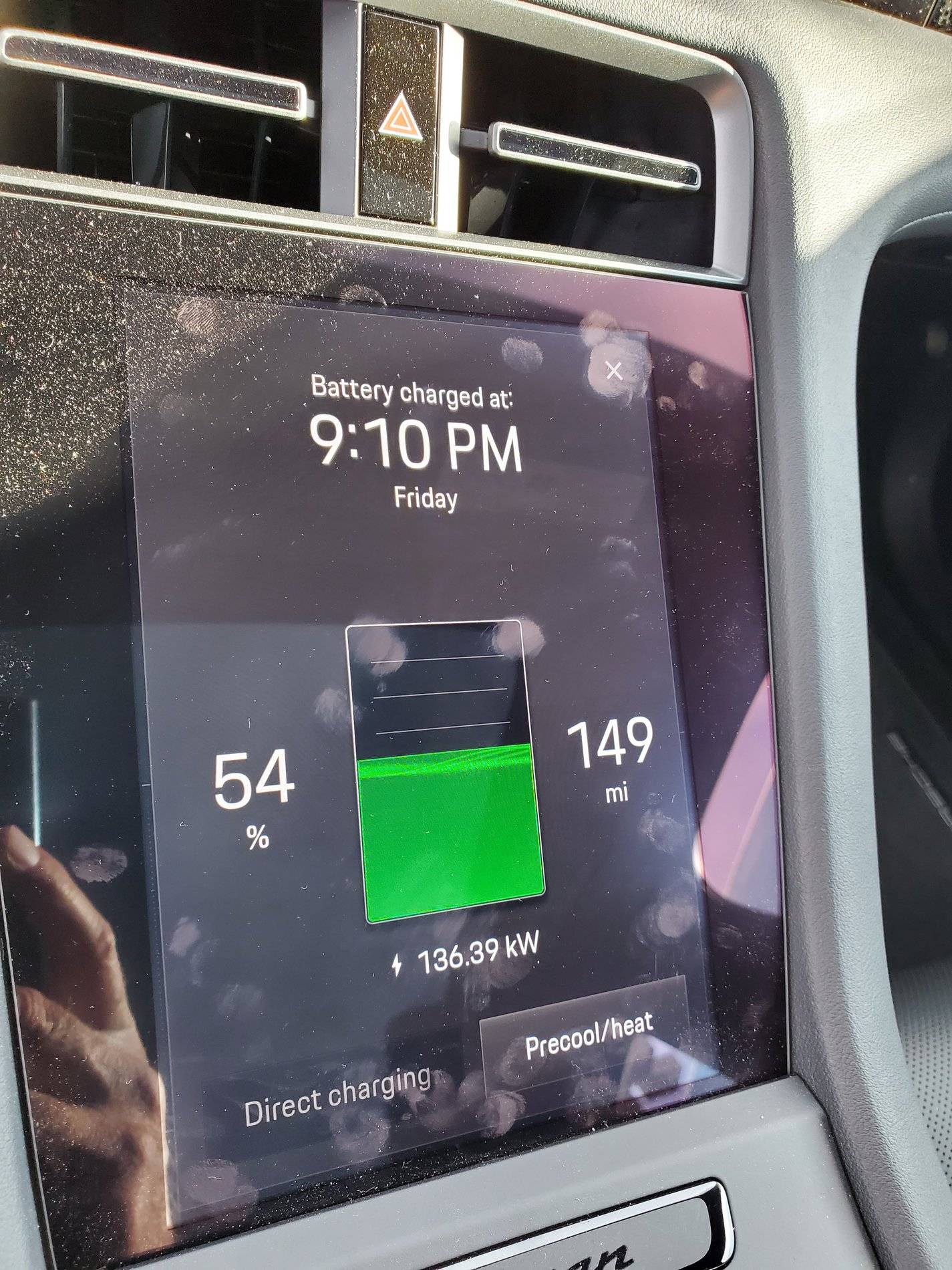

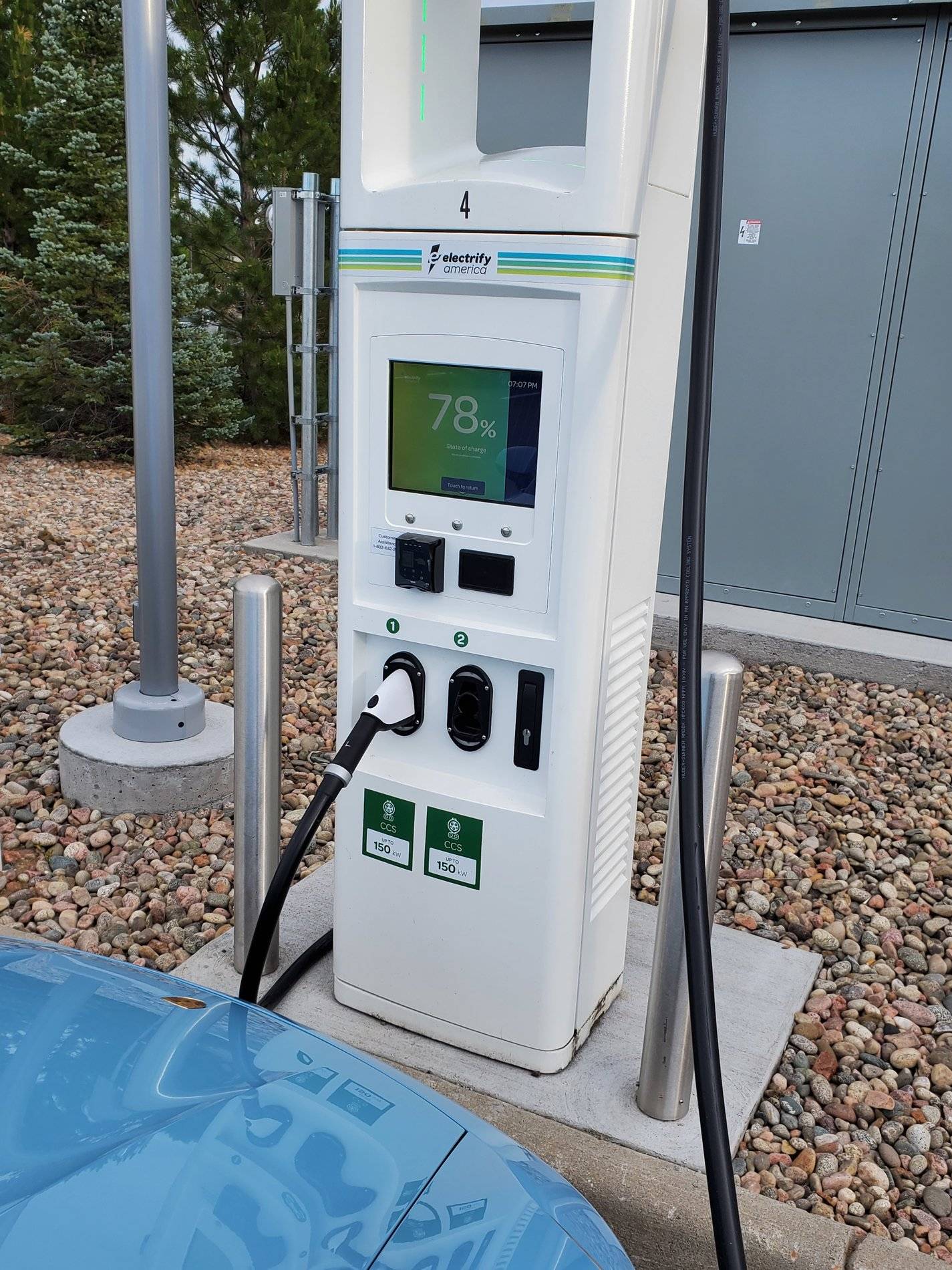

I wanted to follow up to share that I was able to connect to EA chargers, and successfully charge. I went to a different charger location - a 150kw EA charger not far from my house. Before I went, I reset the Charging NA app to ensure that there was nothing being communicated from the App to EA to limit charging on my car. I have a couple of pictures in case anyone is interested.
