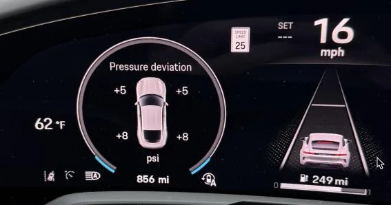

My car has 21" Mission E wheels. The driver door label says cold pressures should be Front 38 and Rear 45. I checked the tires this morning and they are exactly 38/45. So I assume no deviation. However the dashboard screen shows:
Porsche Taycan 2025 RWD Tire Pressure question Capto_Capture 2024-12-20_11-08-30_AM
Porsche Taycan 2025 RWD Tire Pressure question Capto_Capture 2024-12-20_11-08-58_AM
I can't understand why the screen still shows these pressure deviations. Can anyone explain this?

Go into vehicle settings and see what your tires are setup for. The door jamb sticker settings are set for a full load—I think. Also, the tire settings could have been done with the wrong pressure which is why you see what you see. Also in the tire settings is where you can zero that out to current tire pressure (assuming that is what you want). I always set my pressure to what the PCM says (based on my selections) and not the door sticker settings.

^Yes to this. Set your tires to the right size, type summer vs. other, and load as I do partial for 2 people and no luggage. Then use car PCM, not the sticker.
I would not drive mine if I see the numbers your car is showing.

I noticed that as well. The number that you see on the door are for a specific temperature. Cold tires doesn’t mean anything as you can have cold tires both in hot summer and cold winter. I don’t remember exactly but I believe in my car the numbers shown on the door are correct when outside temperature is between 15 and 25 degrees C.
I stopped looking to those numbers and I just adjust my tire pressure based on the deviation displayed on the dashboard. In my case the recommended pressure varies by 0.3 bars between hot summer and cold winter.

Looks like the tyres are pressured for full load and the PCM setting is light load.
I set my pressures and PCM for heavy load when I went on holiday 4 up and luggage this summer and that is about the difference in pressure when I set the PCM back to light load before I let the tyres down.

I find it eventually but there is a menu buried in the PCM which allows you to select wheel size, winter or summer tyres and high or normal load.
If that is set correctly I am assuming the display gives valid data.
When I got mine I set the cold pressures from the door jamb sticker and the display showed within 1 psi after that so I was reasonably confident that is how it worked.

Yep the PCM is set correctly for 21" summer tyres a d partial load. I toggled to 20" and back to 21" just to force a remeasure. The facelift models have a different TPMS valve not that should make any difference

If you set your cold temps to what is shows on the door jamb, you are good. You can ignore the PCM. The key is making sure it’s set when them when they are cold and to check/adjust as the weather changes.
