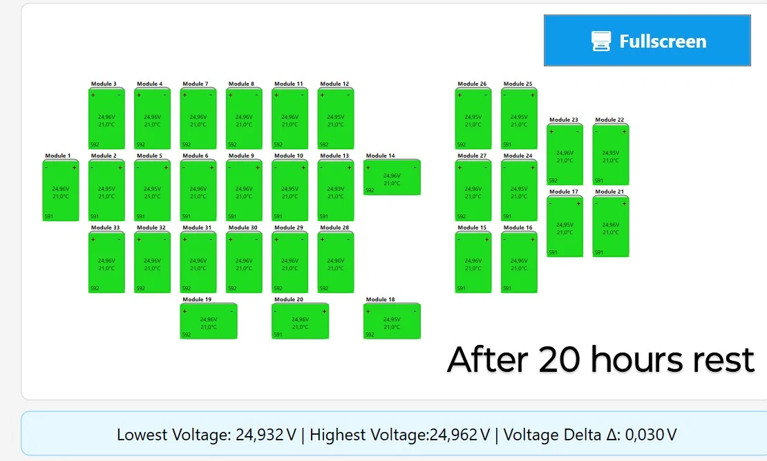

This time they change a faulty module in the battery and also replace the rear inverter and manage to code it to the car.
They also manage to bring the 12V battery back to life.

So this guy makes YouTube videos, but never heard of Google? A simple google search for "Taycan module numbers" yielded this within the first handful of links (notice this is a screenshot of this forum, posted on FB, no link to here included though):
Actually, I can't find it either...
Another way is to know about CT14 Garage's software, I guess he doesn't.
But we do.
I suggest you comment on that particular vid cuz I'm sure "that guy" is very interested in your opinion.
