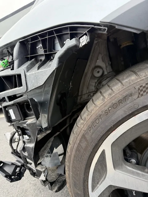

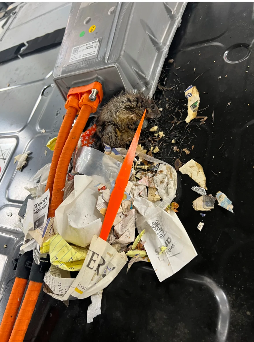

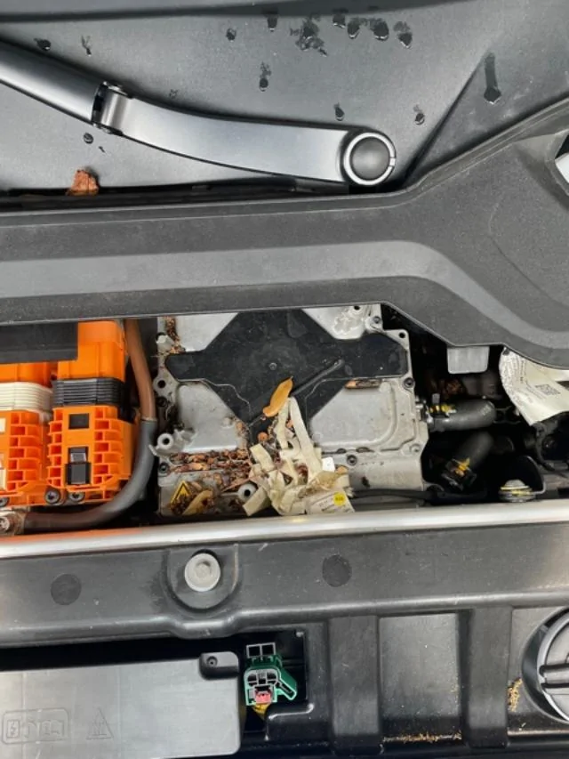

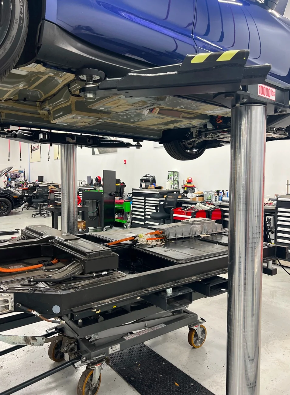

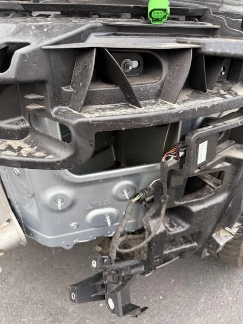

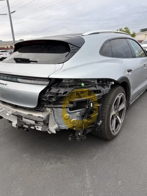

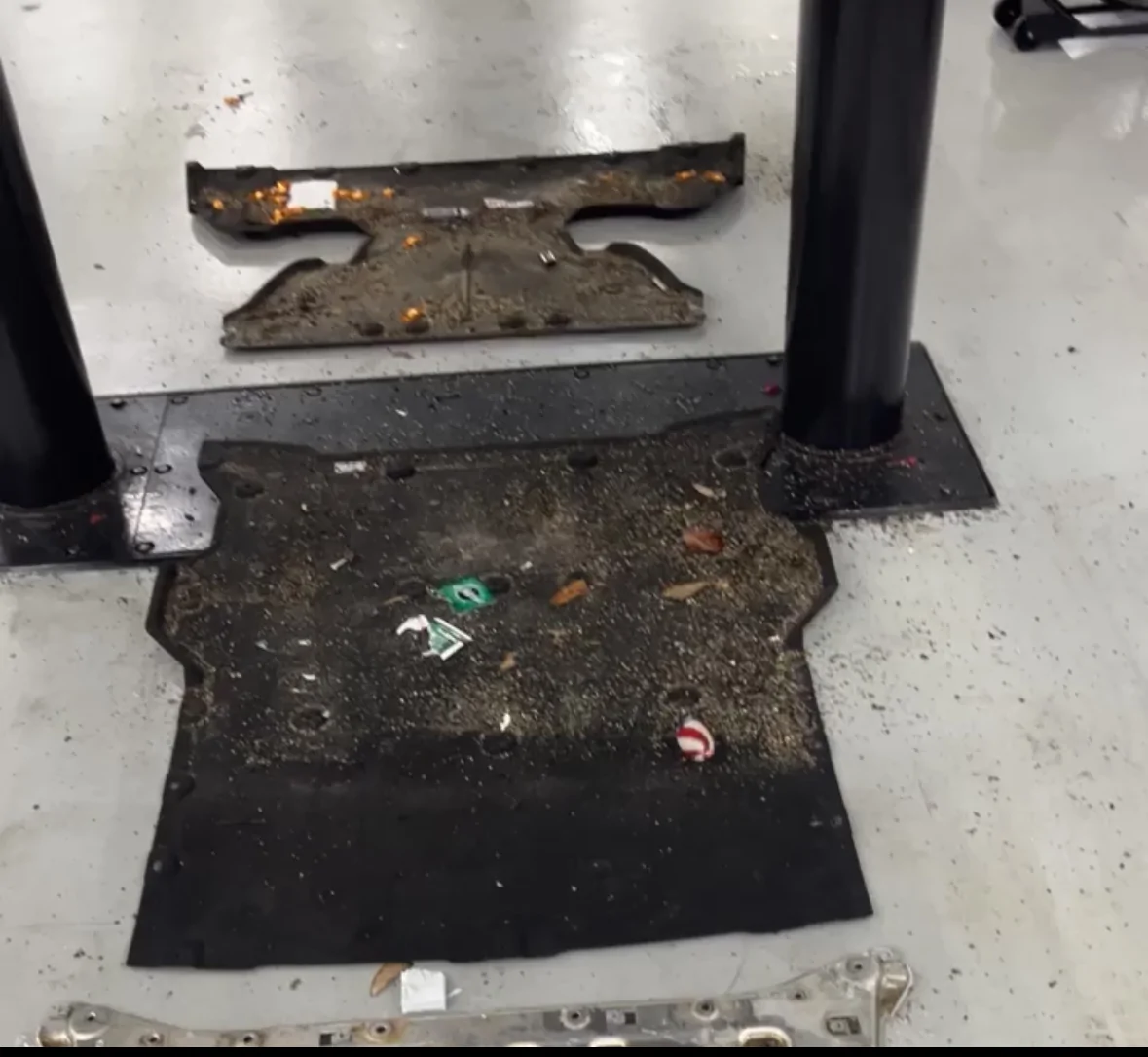

I just heard from the body shop: “Good morning, so we've removed the rodents from the wheelhouse without any additional disassembly. We snaked in a camera to identify how they were positioned and pulled them out of the hole without damaging/cutting into any part of the vehicle. We're currently working on cleaning up the internal areas with sanitizers, bleach, paint thinners and then cavity wax to properly clean out the wheelhouse there. Once we're done with the process, we will send the vehicle back to the dealer to reassemble and do any necessary calibrations needed. We should be getting the vehicle back to the dealer by the beginning of next week.”
I’ve attached some pics of how disassembled it was, which is far less than taking apart the frame of the vehicle as was the prescription when it headed off to the body shop.
