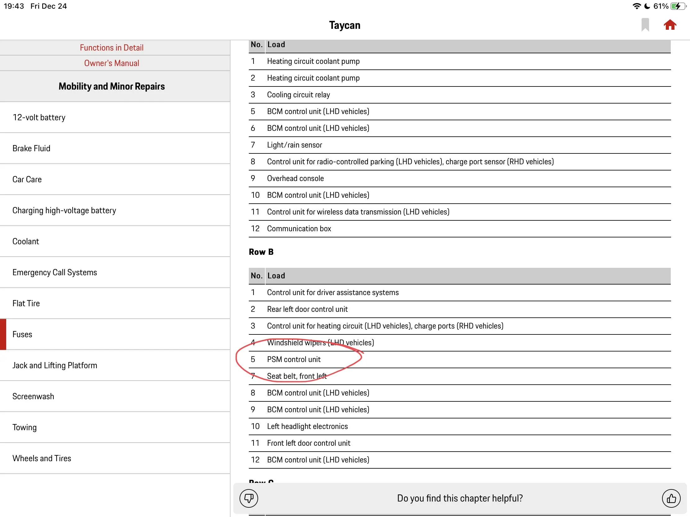

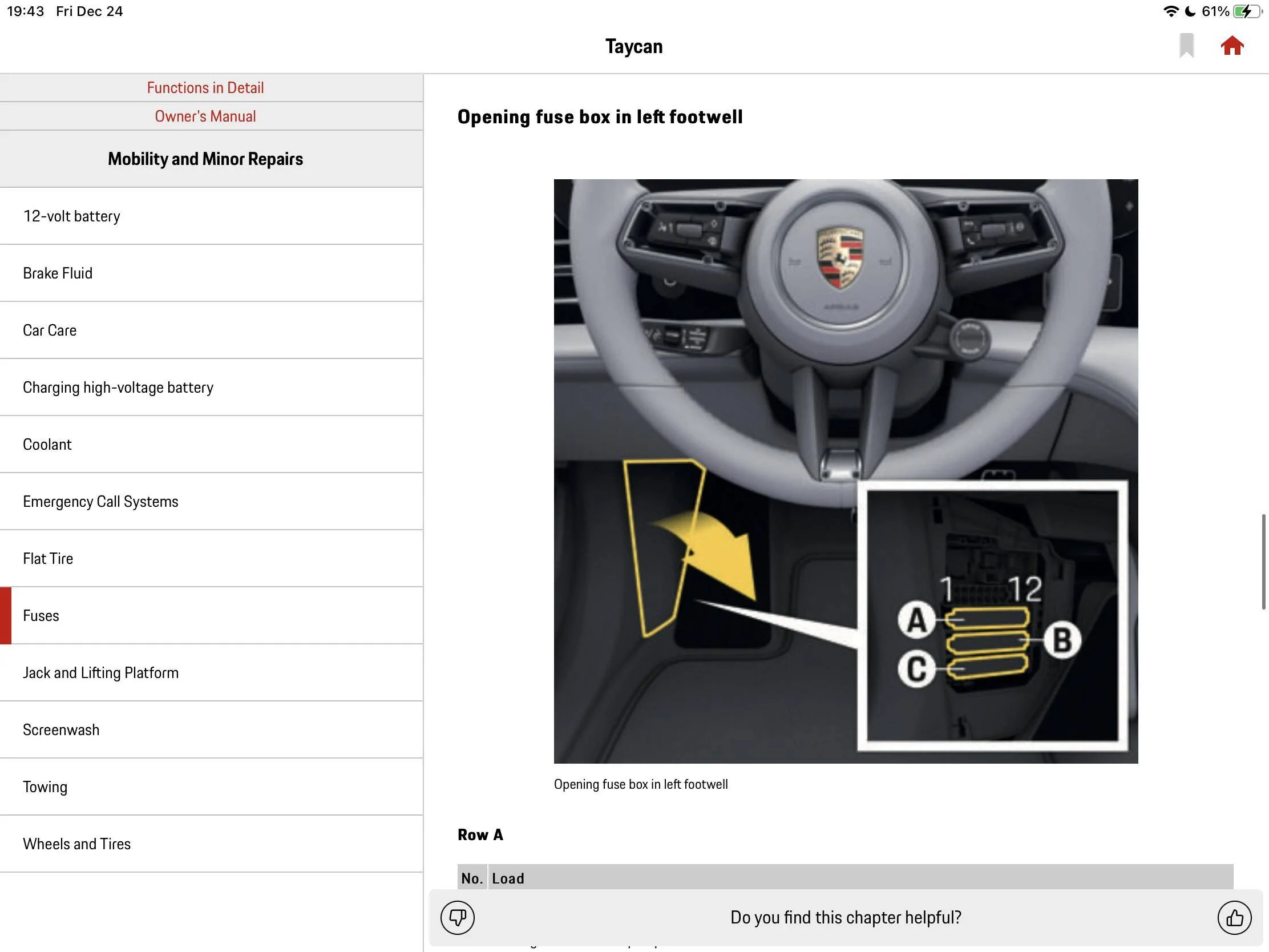

The good to know app. Type in Fuse it gives you the location and the names of all the fuses positions by row, number and right or left footwell. I did not see one for the ABS.

I could not find one in the US good to know app. There was one called assistance systems I do not know what exact system they are referring to.
i believe the ABS is one component of the PSM system. See the images below from good to know app.
There is a Fuse for PSM I do not know what else is connected to this fuse so I’m not sure I would pull it without talking to your dealer first.
Disclaimer I am not suggesting you pull this fuse.

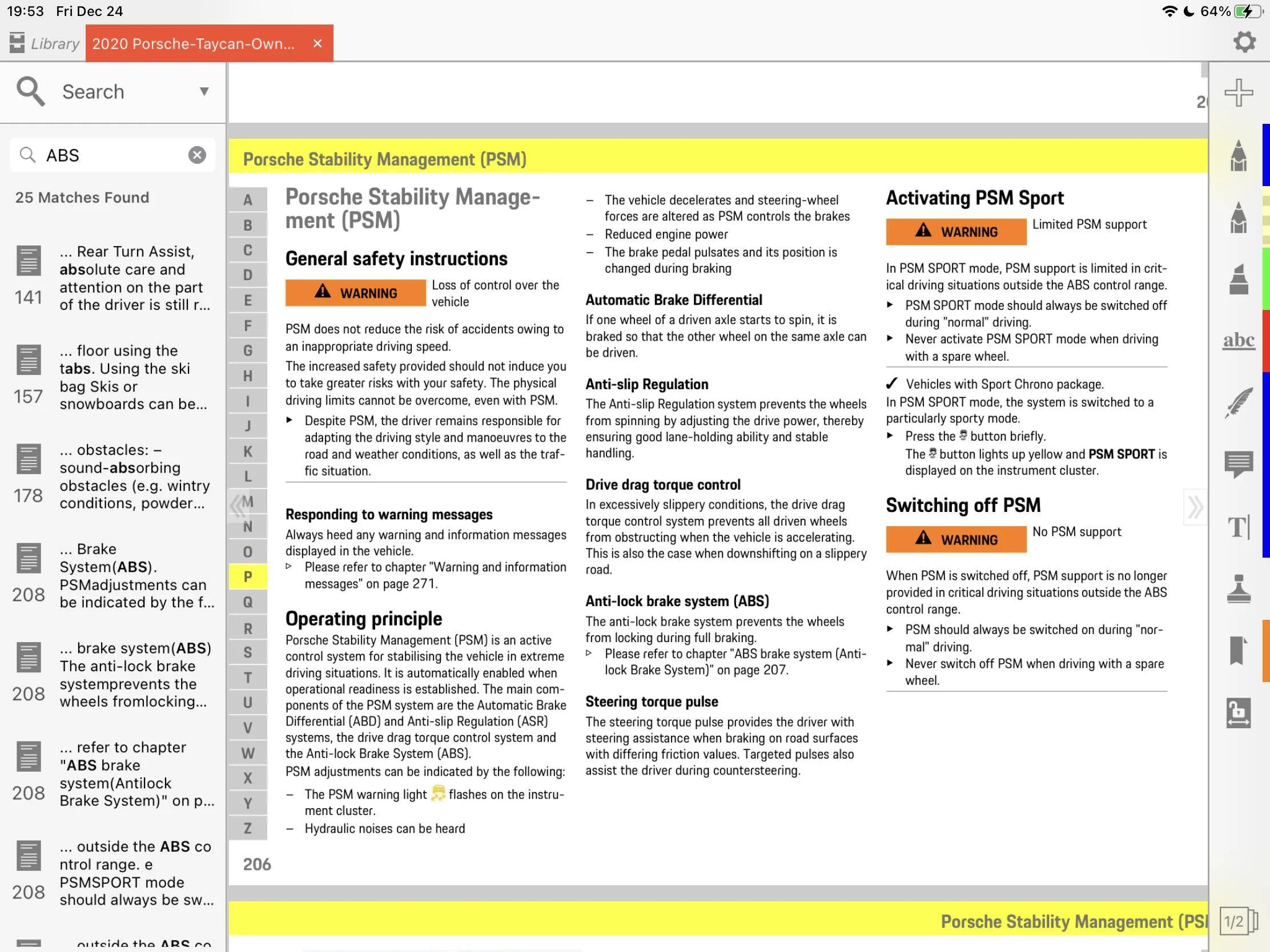

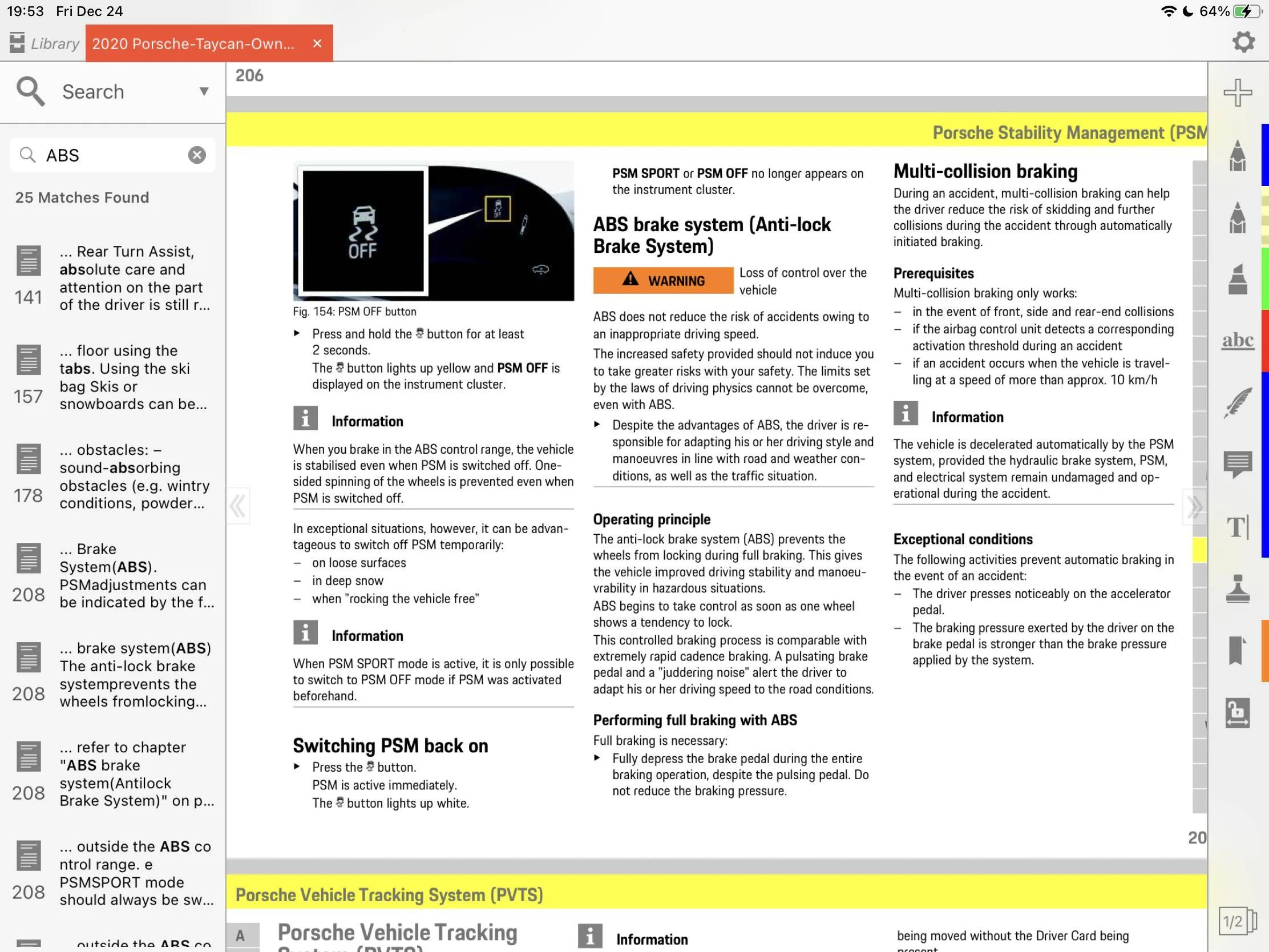

Two pages from the US manual discussing switching off PSM.
Porsche Taycan ABS fuse box (how to turn off abs) 17D4ED14-041D-4F75-A197-37602C968165
Porsche Taycan ABS fuse box (how to turn off abs) 052B8F44-8682-4113-B6E8-01C3CAC13F22
I already did this thank you, but psm and
abs are differren...abs is always working...
but thank you!!
