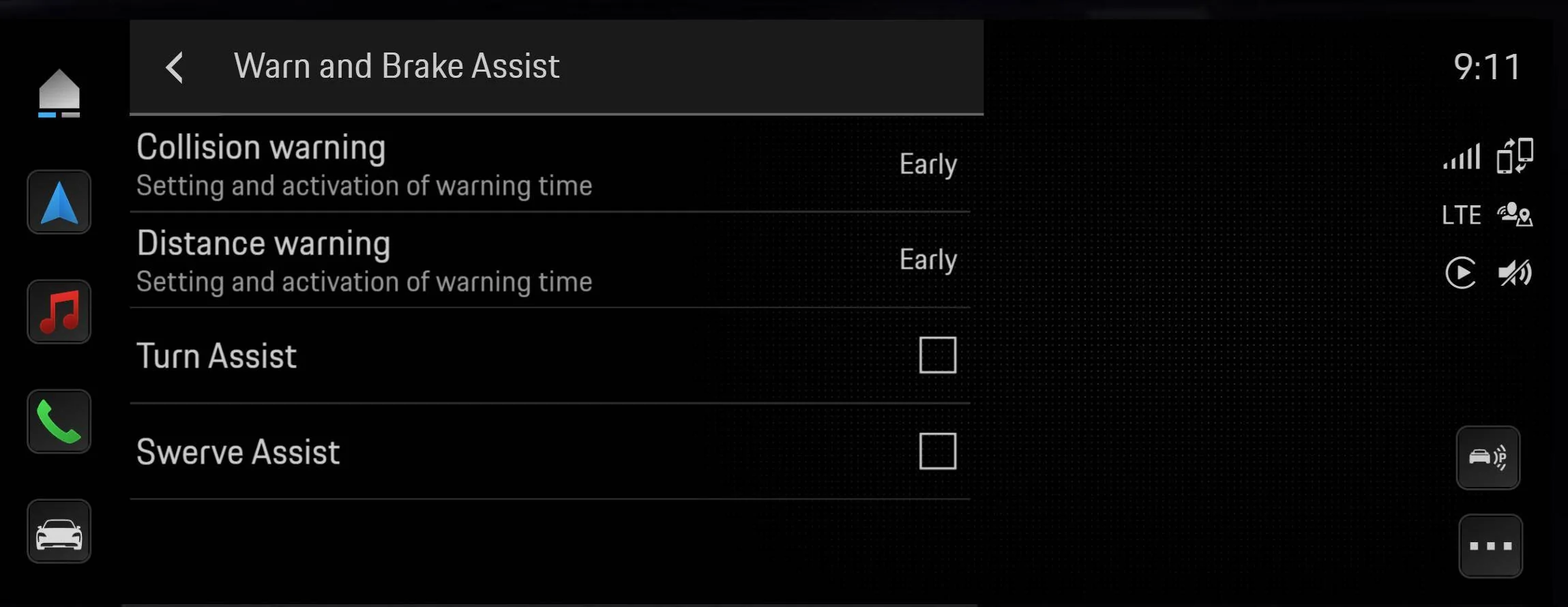

Under Vehicle -> Assistance -> '...' -> Assistance System Settings -> Warn and Brake Assist, take a look at both Distance and Collision as they may be set to 'Early' when Medium would do:

thanks for the feedback. I played with all these setting yesterday, but will try again today to see what I can work out.
