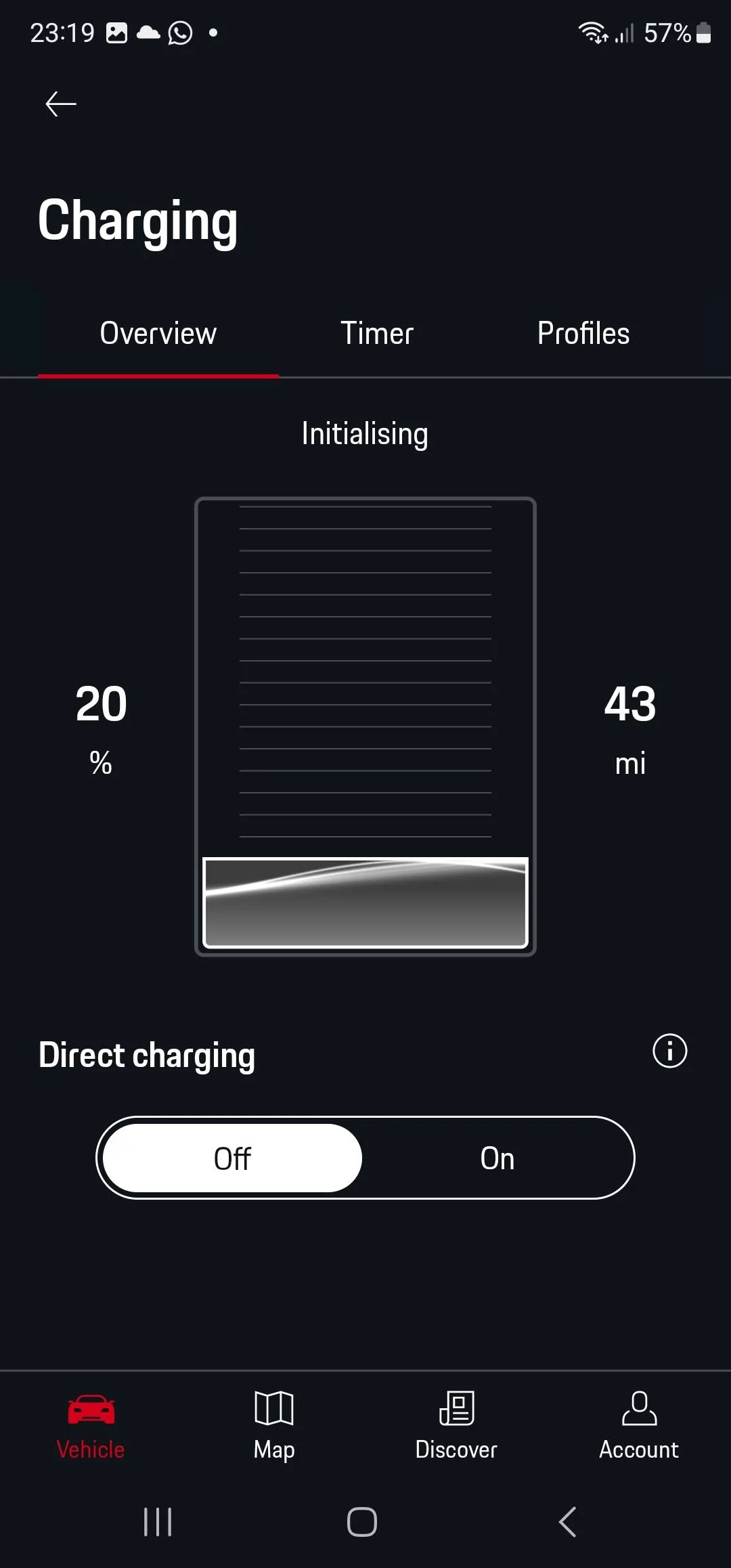

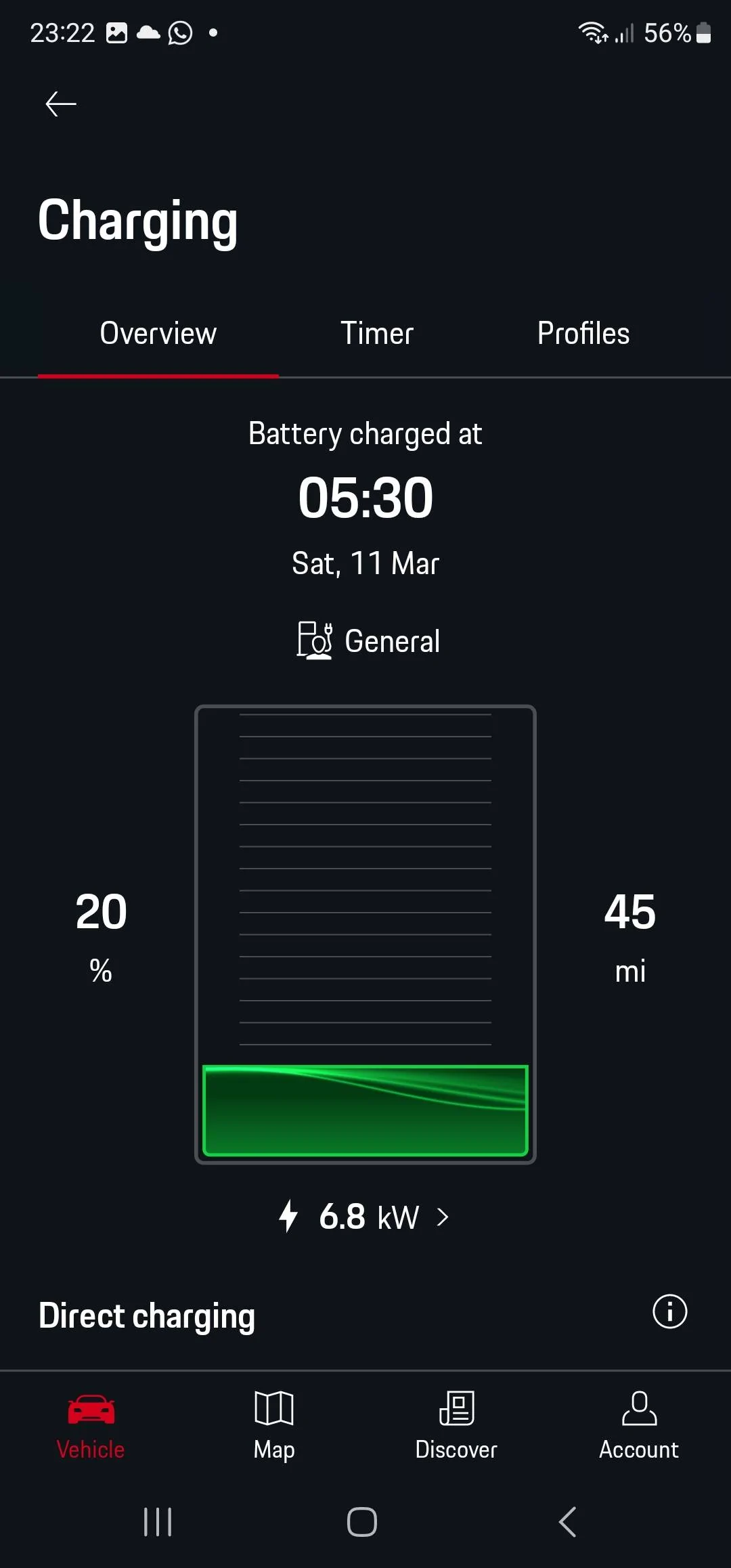

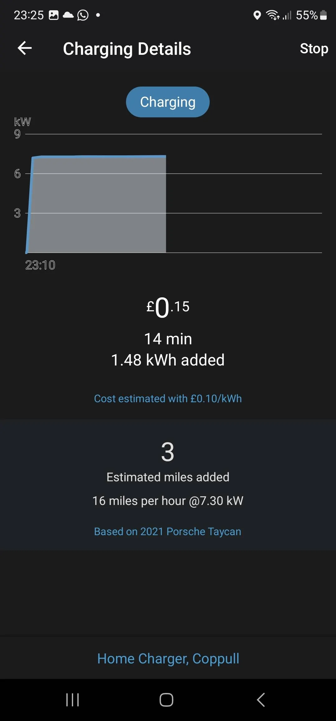

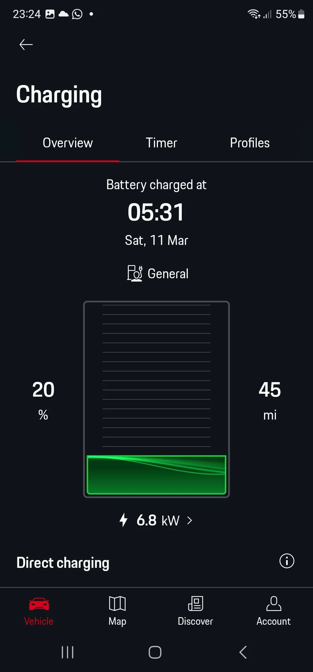

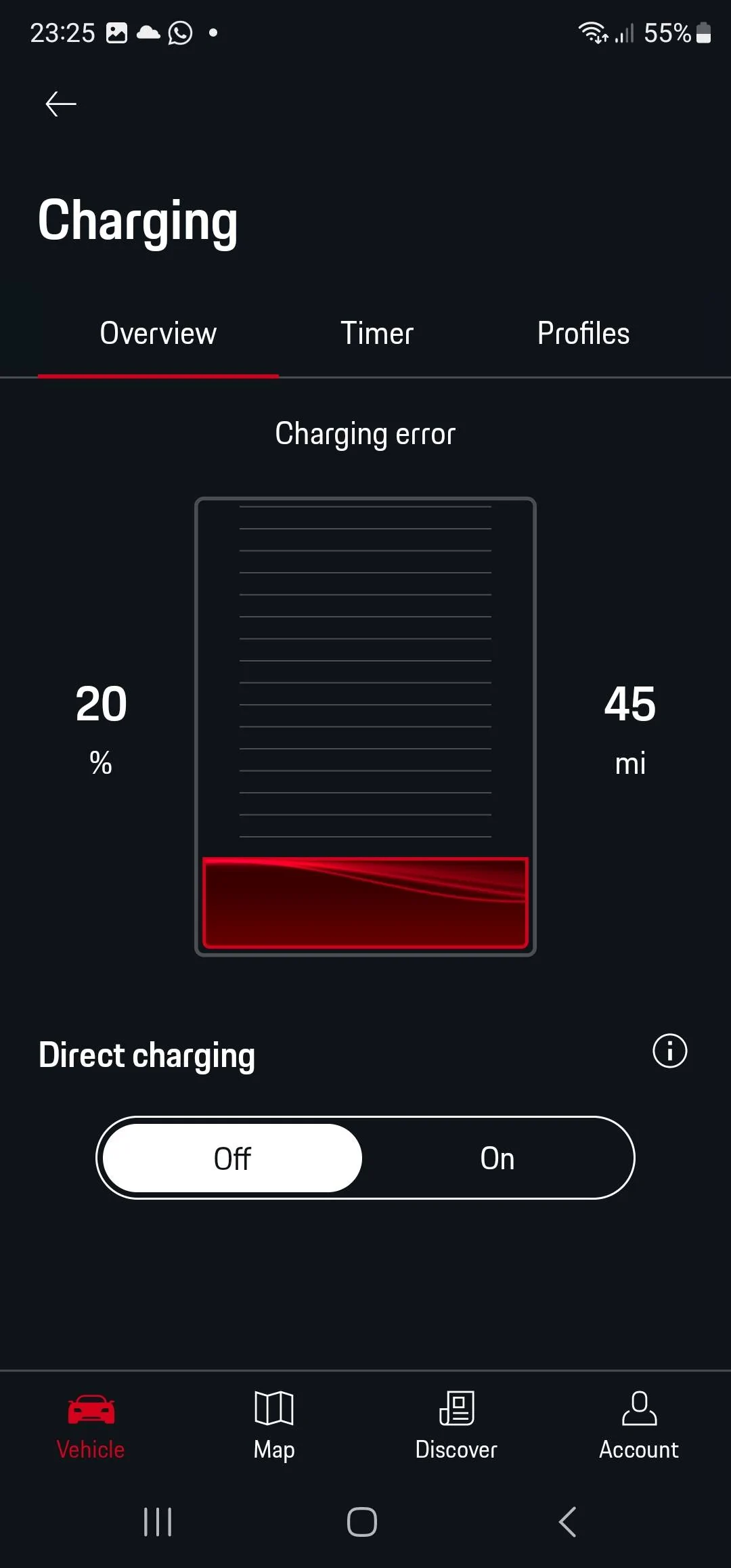

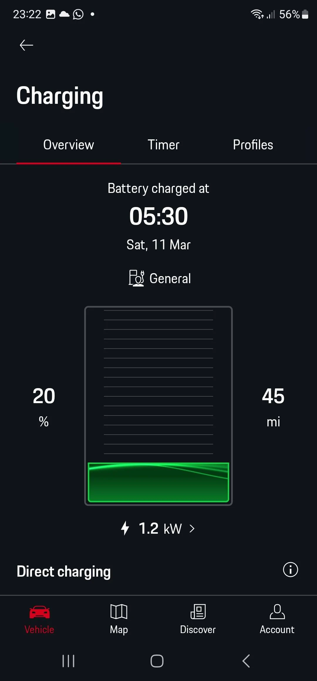

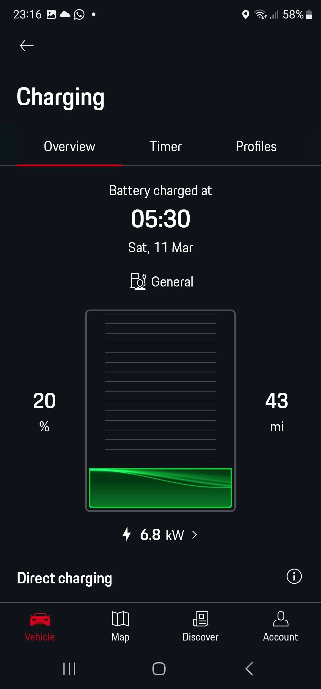

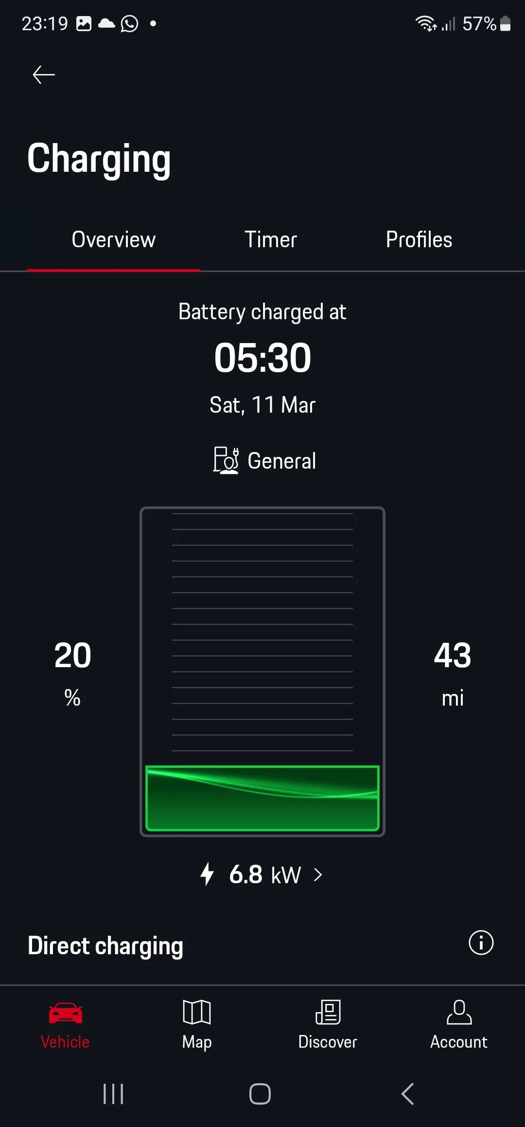

I spent the evening trying to sort this out. Makes absolutely no difference to remove all EVSE timers. What I finally found out was that the DC port (passenger side in UK) will not charge beyond the first 15 mins before going to Charging error. However the other port worked flawlessly. I have turned on plug and charge (which worked without issue over this last week at Ionity), and was wondering if that would have any bearing. I have uploaded the sequence that repeated again and again on the DC port, it is all over the place, changing power, reinitialising before finally failed after taking about 1.5kWh. Car is booked in Monday already to address a failed release button function on the driver port (the one that worked last night), this can be added to the list. Sorry about the mass of detail, but I hope it might help others.

Ok so it could be your AC port on the DC side is failing (this happened to me a year or so ago on my first Taycan). As I understand it there is one AC onboard charger and two AC ports (driver / passenger). My AC port on the DC side failed and was replaced.
Plug & Charge shouldn't impact this and as you know bears no relationship to AC charging sessions.
I guess before diagnostics are run you can charge via the Driver's AC port.
