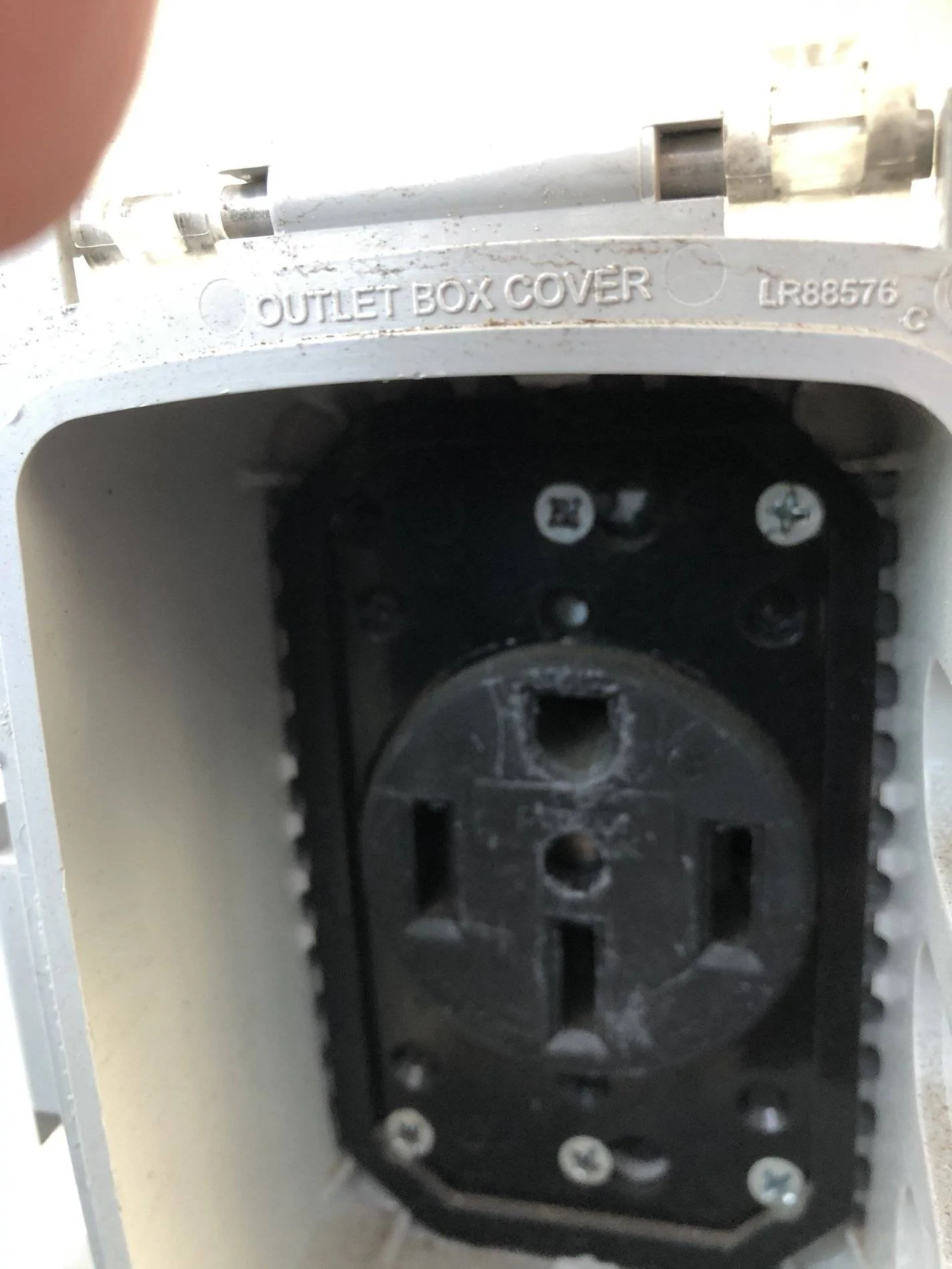

I have an existing charging outlet for a Tesla (non supercharger) that I want to plug my Taycan in when it arrives (hopefully early March). What do I have do to use it? Is there an adapter for the use of the outlet to purchase or will the outlet work as is?

Apologies for the vernacular. It’s just an outlet...

That is specifically a NEMA 14-50 outlet. That's the receptacle for the default plug that comes with the Porsche Connect Charger.
You may want to check the circuit breaker current limit just to verify it's at least 50A, but I assume that it was for the Tesla as well.
