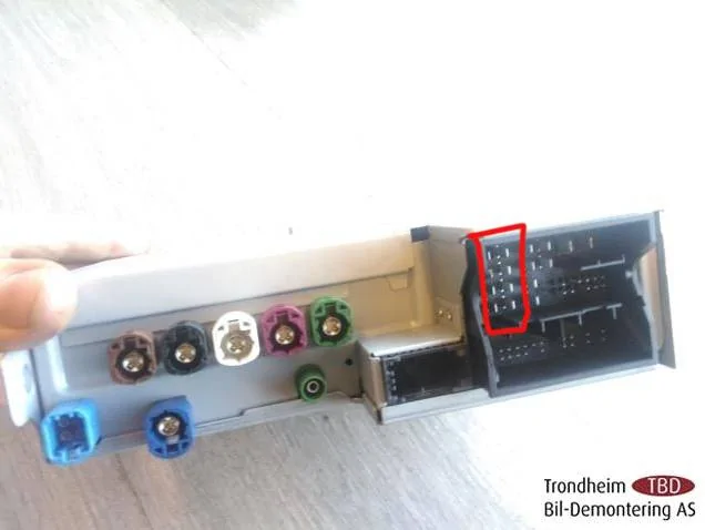

I personally have not seen the radio mainunits placement in a Taycan yet, but looking at Porsche partscatalogues...it seems to be located in the dashboard right behind or somewhere under the main screen.
And when you locate it, the four pins I've marked in this picture are the speaker outputs.
Porsche Taycan Audio cabling Taycan_HU_1

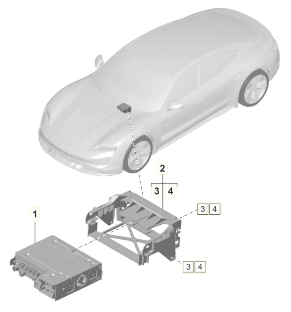

I've now tried using several other sources aswell...but i still cant find a picture or an illustration that tells us exactly where in the dashborad the main radiomodule is located...sorry.
This picture is the closest indication i can find....
Porsche Taycan Audio cabling PCM6

Thanks for your effort. This gives a good view of what i actually have to look for. I assume this is behind the main screen.
