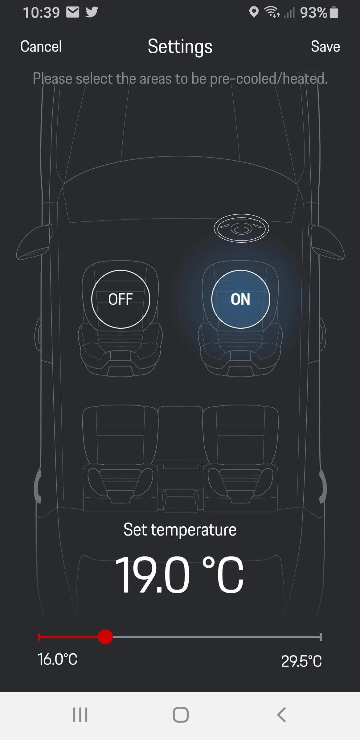

Really :oops:there is no way to turn on specifically steering wheel or seat heater remote only rather than the whole system???
Strangely in the old Connect app it was possible to edit settings in Cabin Pre-Configure for the Hybrid Cayenne. Was fairly simple in that you could pick which seat heaters powered on and if you selected the drivers seat the steering wheel also came on
Its not possible to do this in the new MyPorsche App .. another example of reduced functionality in the MyPorsche App

yeah, I got it, But what I mean is that what if I just want my hand or back to get heat. I usually travel with my friend and family they always keep ac at very cold temperatures and I am the person who wants normal weather not too hot not too cold. I can't just turn on the heater while they want cold.. so I was wondering is there a trick to just heat the steering or seat.
Alas not.

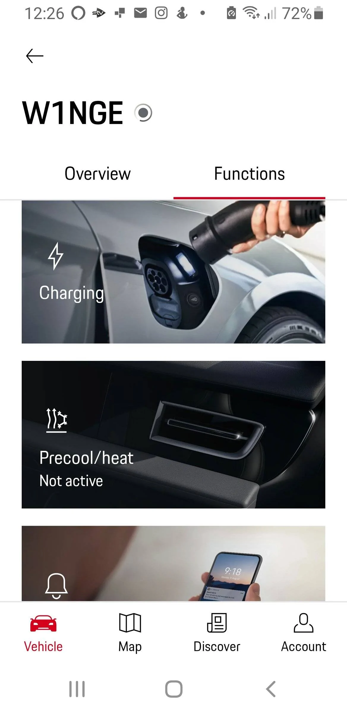

I know about the old series app, i was really nice and easy to access but this new series there is no feature like this, that why i am in search of this
There is if you look.
Tap your car picture after the app has loaded and then functions and you'll get various options including preheat/cool.
Can also be set with a timer if needed
