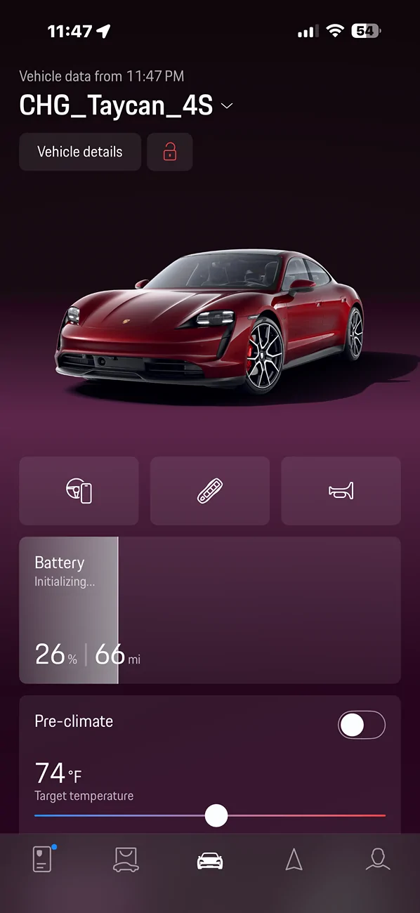

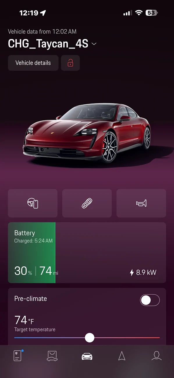

I encountered ‘Battery Initializing’ during a home charging session at 26% (66 miles). Is this a new message, or does the battery initialize for every charging session? It took about 15 minutes (12:02 - 11:47) before charging began. This is not an issue, but an observation. See the attachments.
Prior events:
  • Trip 1: Start: Charge to 85%, End 26%: The Taycan was not driven for 2 days.
  • Trip 2:
    • Start: 3-day charge from 26% to 90% (Optimized Battery Set: Electrify America – 160 kW peak).
    • End of Trip 2: The home charge started, and the Battery Initializing message appeared in the app. The car screen also showed 26% (I missed taking the photo).
Porsche Taycan Battery Initializing (15 mins) during Home Charging Session Init
Porsche Taycan Battery Initializing (15 mins) during Home Charging Session StartCharging

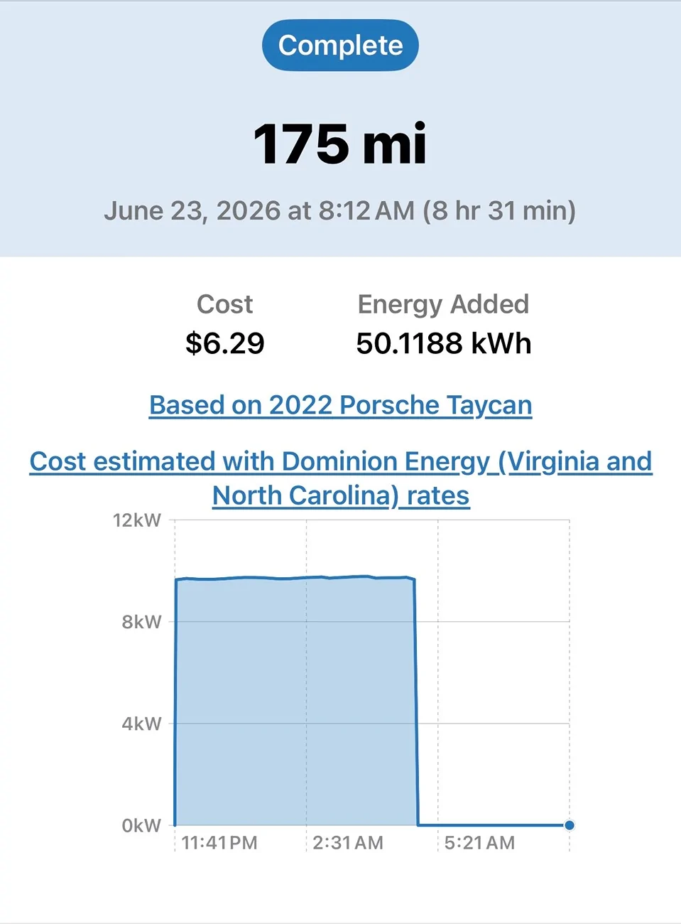

Upon reviewing the charging session from the ChargePoint, I now see KW supplied to the Taycan was consistent for the initial 15 minutes. 11:41pm +. There is no issue here.
The battery initializing message should have been cleared (in the app and PCM screen) when the Taycan is sourcing the KW requested.
See attachment.
