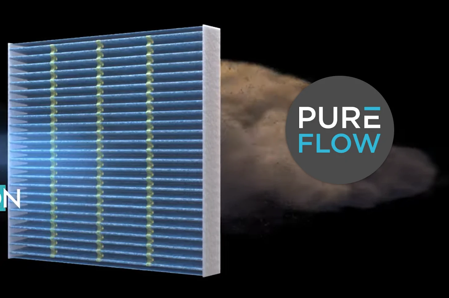

This may apply to you or not, but I just noticed that the air flow on the Pureflow filters is wrong, as the White side is the air IN side and Blue is the air OUT side, consistent with the 1,2,3,4 stages, and their video. Now, I have to recheck all my cars as I may have installed it following the arrow on the filter, but it is the wrong way.

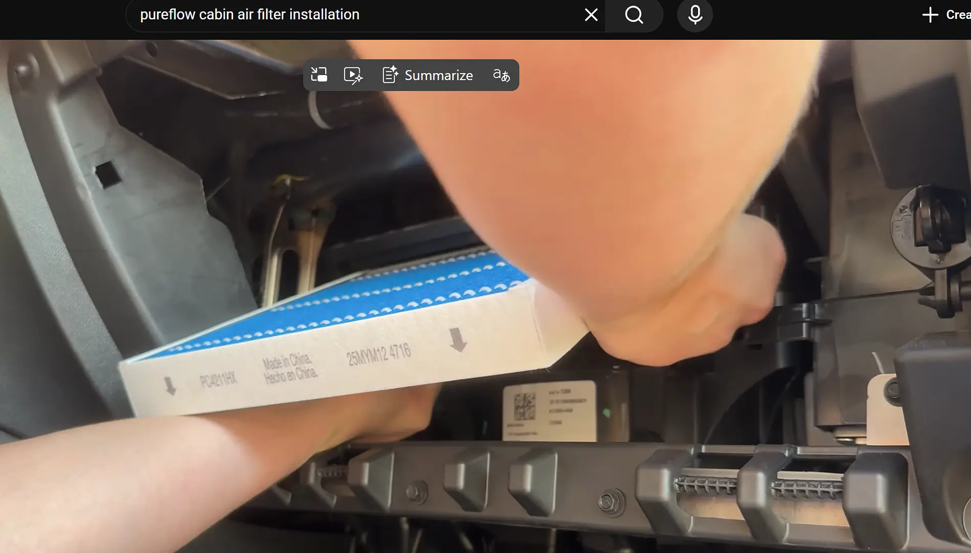

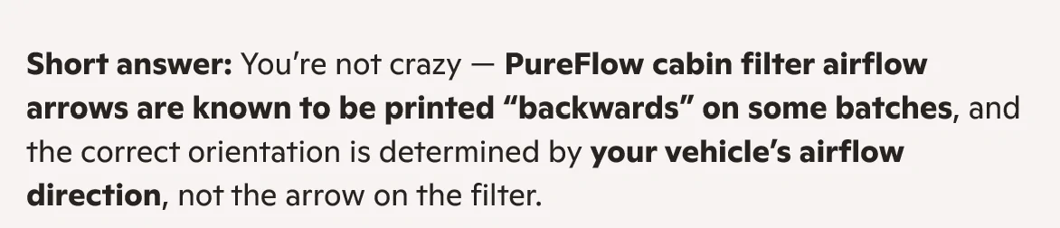

I found several videos and all show that the arrows printed are wrong. This person followed the arrows, but clearly this is wrong direction as the air is moving top down. Someone needs to report this to Pureflow, I will see if I can, well, looks like the answer is here:
