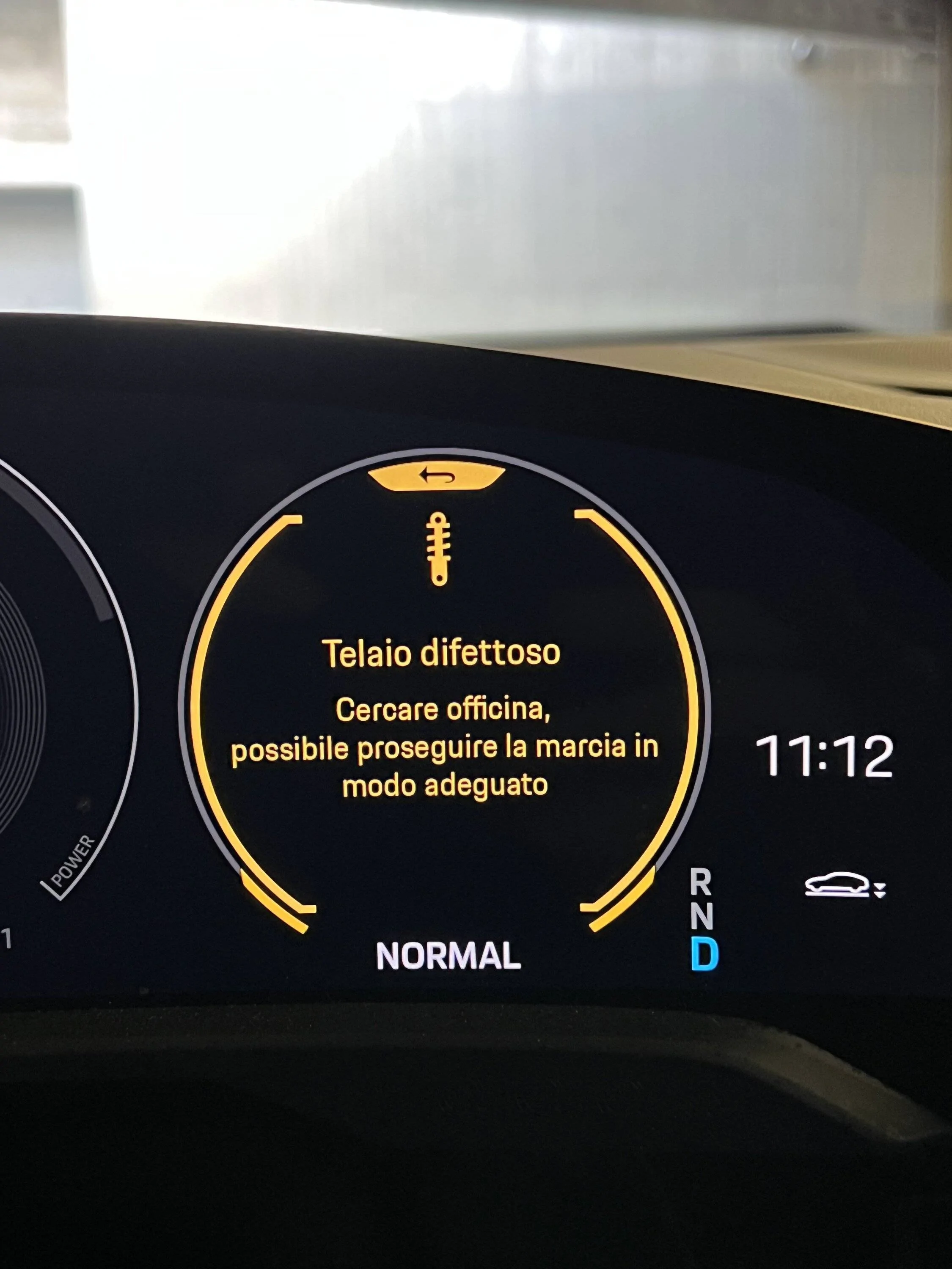

Porsche Taycan Chassis Error C2EFD0DD-08E5-411C-9701-0D74CEB197EB
same issue….waiting for someone solve it…probably my dealer is not able…?

Taycan Turbo S
As I mentioned above mine was diagnosed with a strut fault which they are replacing. I should have confirmation on Wednesday when the part comes in. I’ll report back.

My error started out very similar to yours it would trigger and then disappear after a restart until over the last two weeks it just remained constant. The strut replacement makes sense given I took a hard knock due to a big pot hole which probably damaged it. Hopefully strut replacement solves the issue.

called now by the dealer; Replaced electrical wiring on a shock absorber, which was driving the system crazy. Now the car is ok

This is the diagnosis:
Verified customer concern, Found chassis warning on instrument cluster. Connected PIWIS tester created a VAL and scanned for faults. Found chassis fault C104213
- Left rear dampening
adjustment valve, Open circuit, C104201 - Left rear dampening adjustment valve,
Electrical error.
Checked vehicle wiring to left rear
strut and found no issues. Determined left rear strut is internally damaged.
Removed left rear wheel and wheel liner replaced left rear strut and re installed in reverse order. connected PIWIS tester deleted faults and performed after VAL.
vehicle is now operating with no further issues
