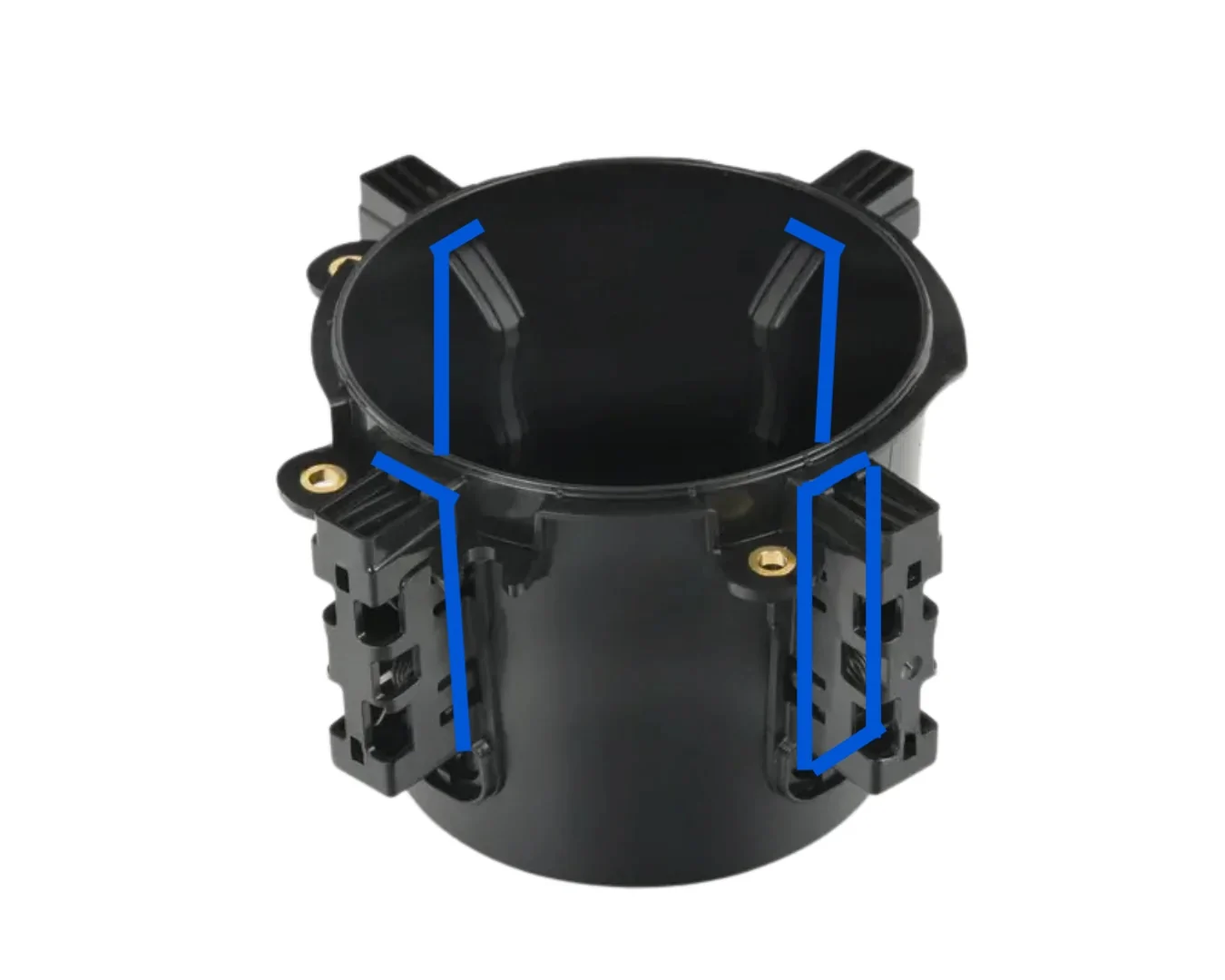

The area you're aiming to lubricate is roughly here in Blue but inside the insert and between the body of the cupholder and flange of the finger. These two bits of plastic are rubbing and causing the creaking noise
