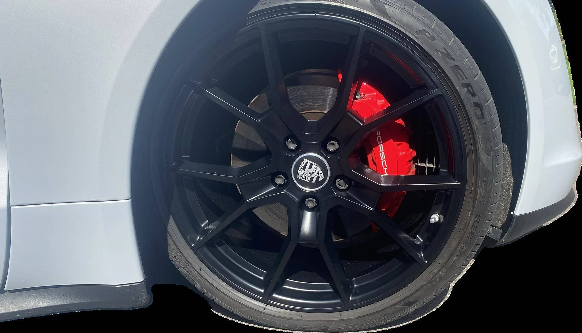

I changed my wheels from diamond cut to Satin black for that reason, much easier to repair and look like a GTS, no brainier!!
